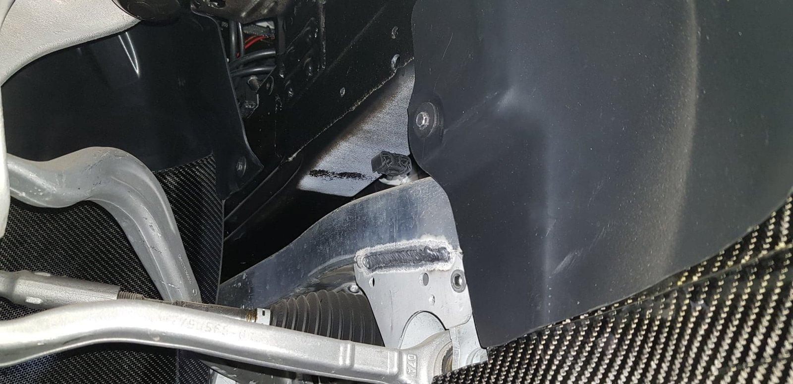

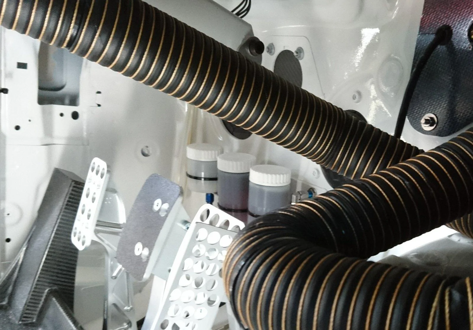

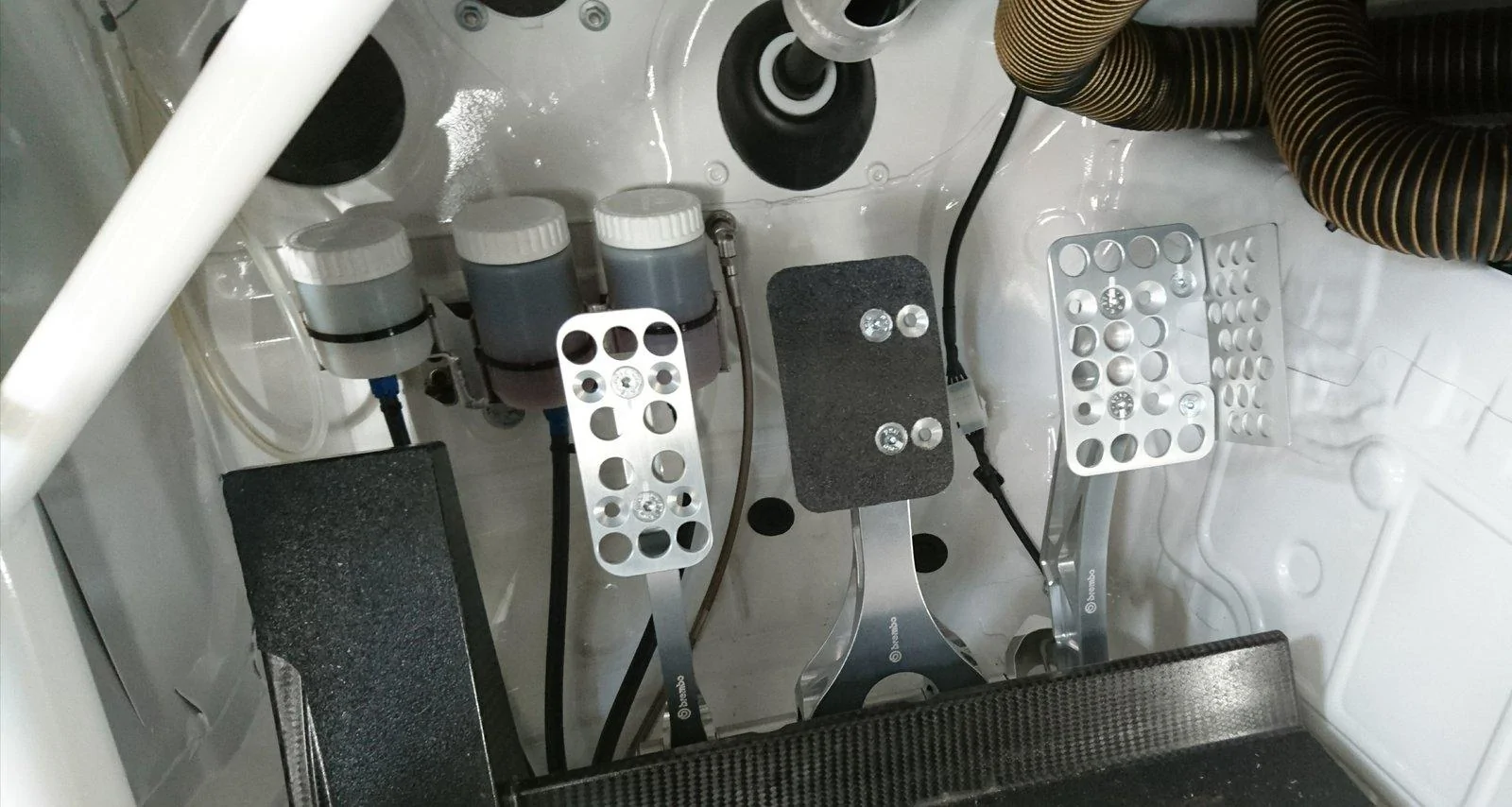

My main concern is whether or not there is a hole in the firewall for a clutch master. I speculate that there will be one, just covered up.

Saw some photos from another individual that attended. Looked as though it had a floor/firewall mounted clutch master right above the pedals, unless it was a junction box...

I honestly think it would be a bad decision to not offer a manual. Reason being is, Tada is saying this is the last petrol only sports car basically right. Why not give us a manual option as well, if you want to give it the right send off before switching to auto/dct only for the A100 or whatever it is coming down the line, after this release.

Awesome! I don't wanna jump the gun but I think the firewall is definitely ready to take a clutch pedal. This doesn't necessarily mean we're going to get a manual at launch, but does go along with what Moto San was saying when he mentioned "provisioning for a manual trans"

I noticed that all the airjacks and everything were there for the racing concept too.

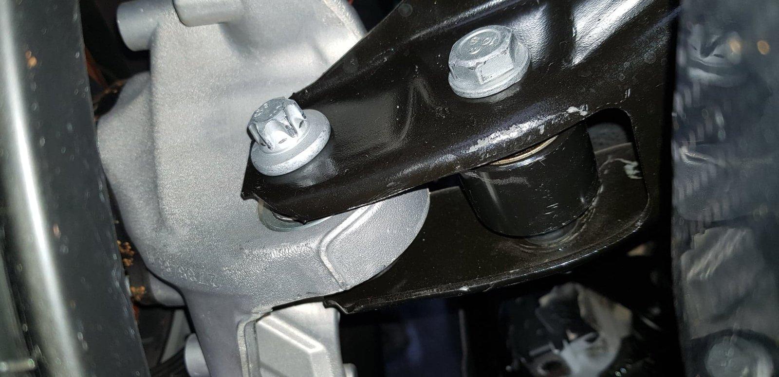

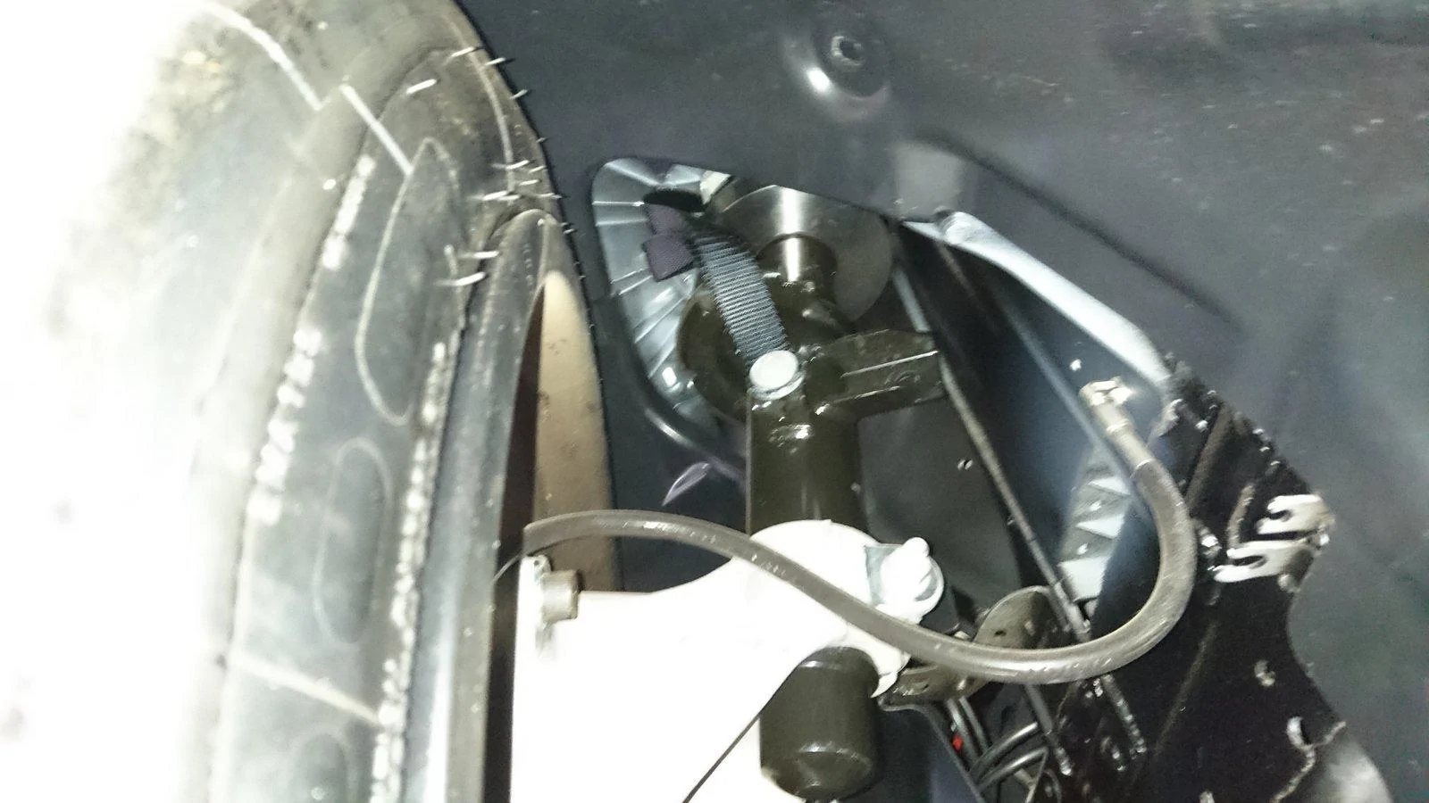

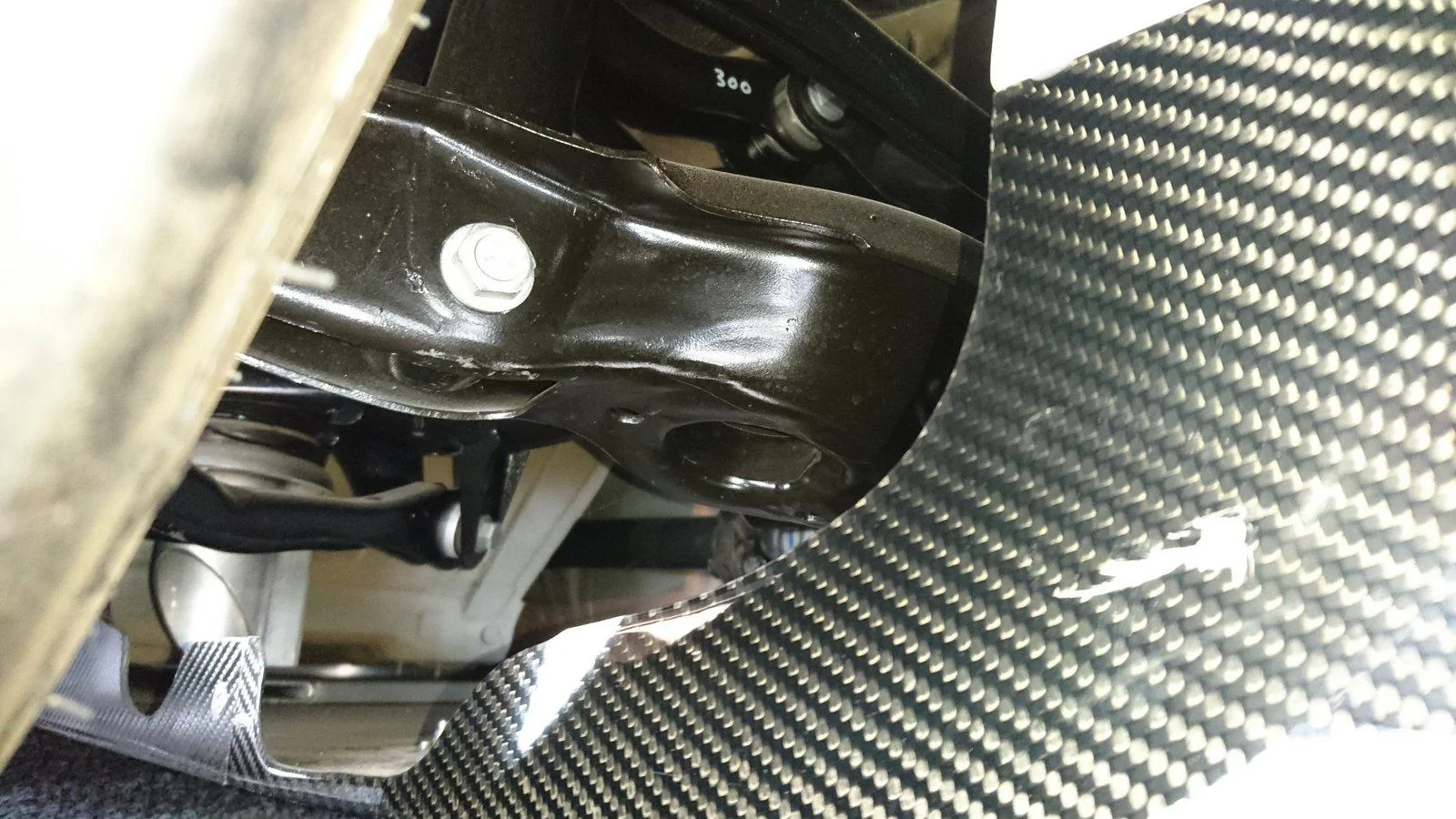

Okay, this is good! Front suspension has split cast aluminum lower arms which look nice, with a clamp style knuckle, which is meh for places with snow/salt, it also means we can't get any camber adjustment out of the knuckle, which you can get (minimally) out of a bolt type shock mount. Rear suspension is a multi link with stamped steel arms. Main lower arm has a separated strut mount and spring perch (I think) which is common BMW practice. There's also a lower track/toe arm. Two upper arms, can't see the lengths or how much adjustment though.
@RyleyMA61 Do you remember where this was in the front suspension? Looks like the stamped steel arm from the rear, since it looks like there's a shock mount there. Also, what-the-fish type of bolt is that?
