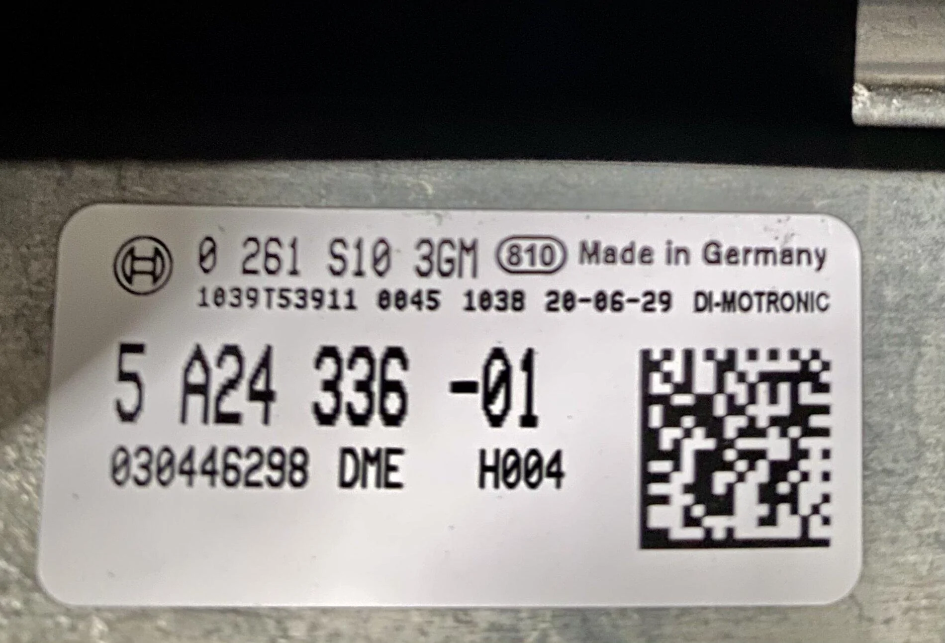

It's also affecting new m2/m3/m4s. I'm deciding on a Supra or M3 and the standard 6mt M3 being gimped and un-tunable is a turnoff.
same here. I cancelled my order until this gets sorted out. Im sure the market will find a way, but i want to see what it is.
if I ran Burger tuning id be finding a way to make jb4 pure800/850 compatible and ride the wave of sales For a while.
this wont get sorted any time soon.

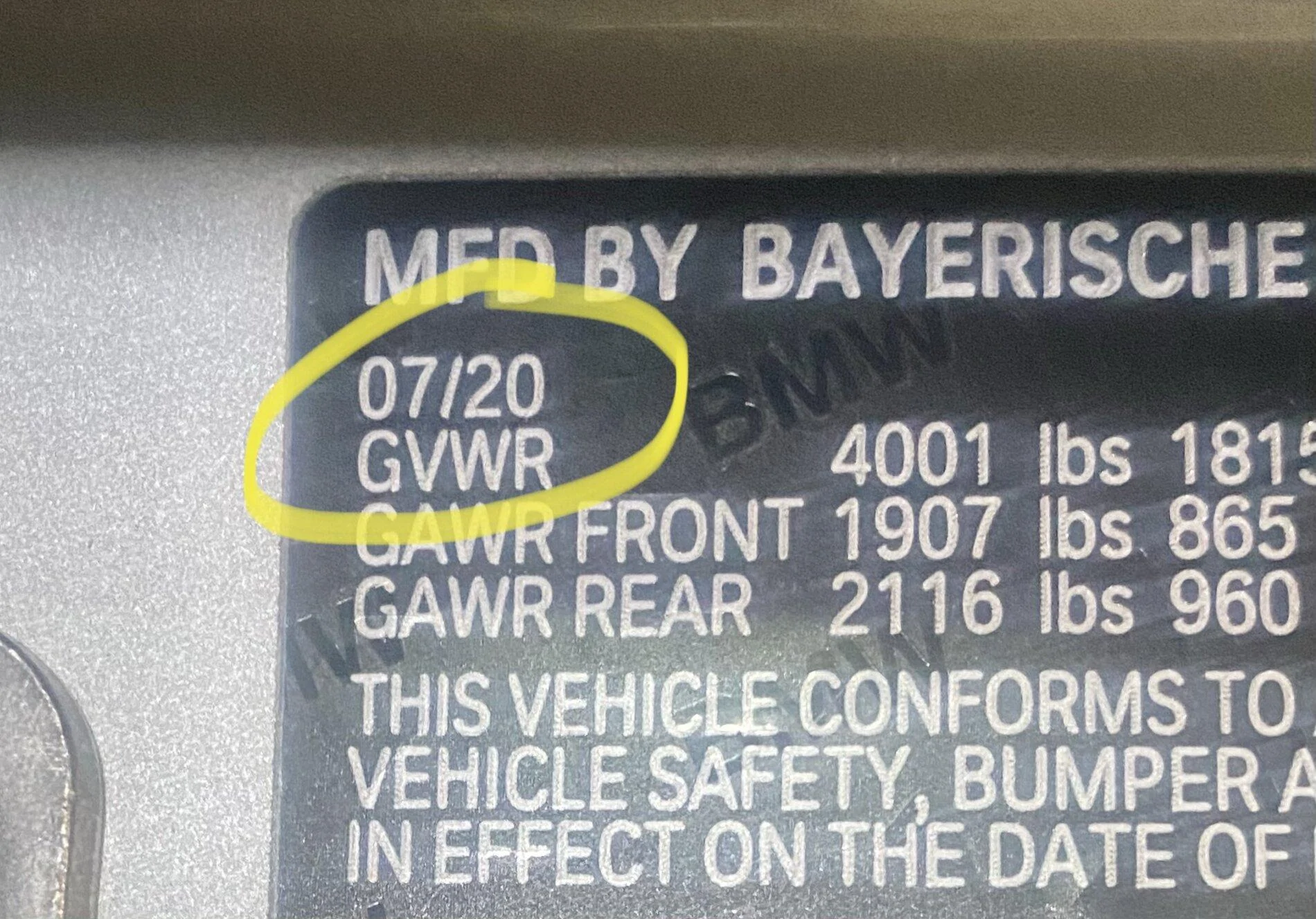

7/2020 and on have the new processor and security. Just look at the build dates on your door jamb, and that will tell you.
My 2021 has a build date of 7/20... would you believe it to locked or unlocked?

Hi there
regarding Supra 2020 manufactured on March 2020 is it possible to be locked!!
