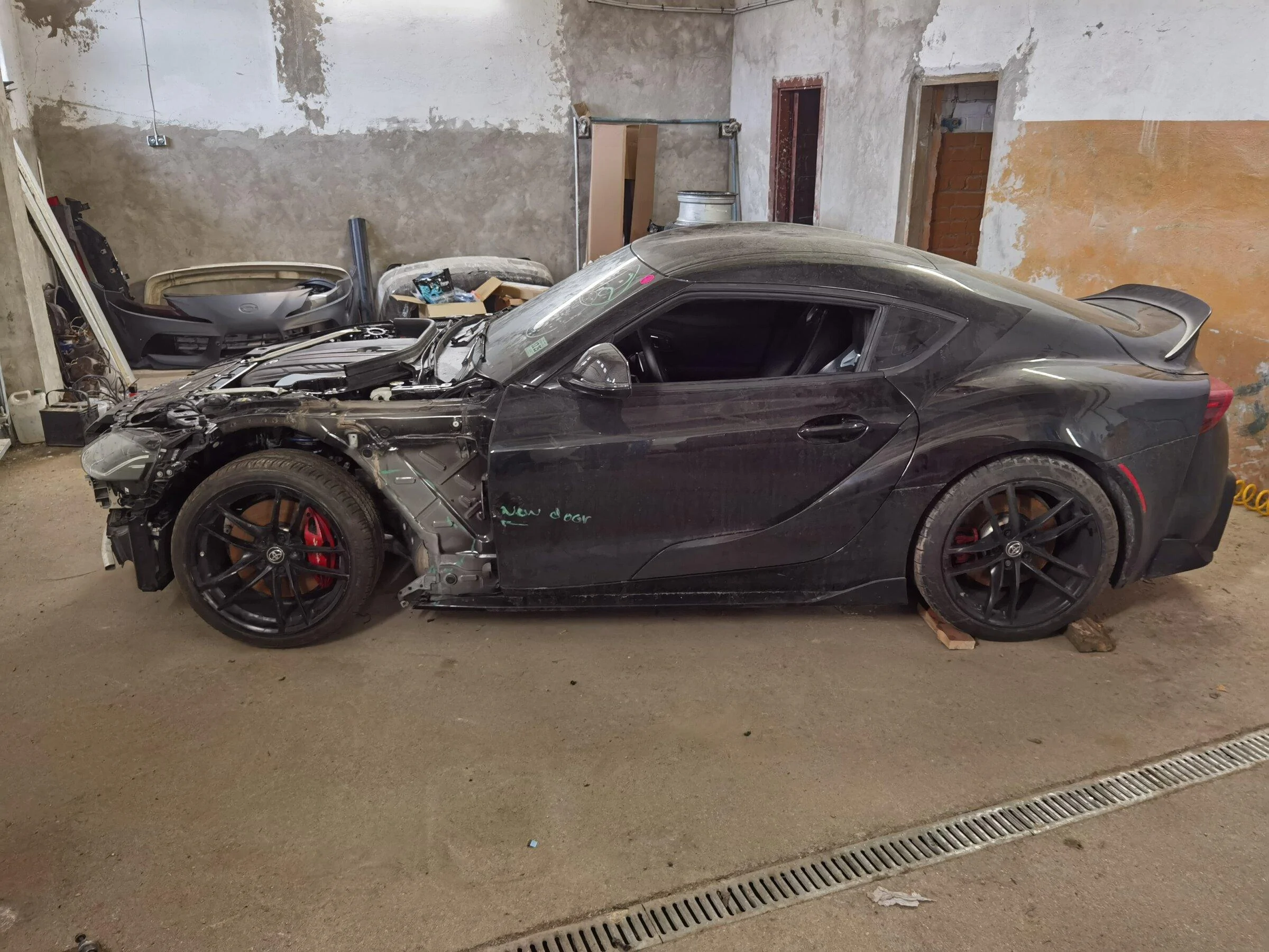

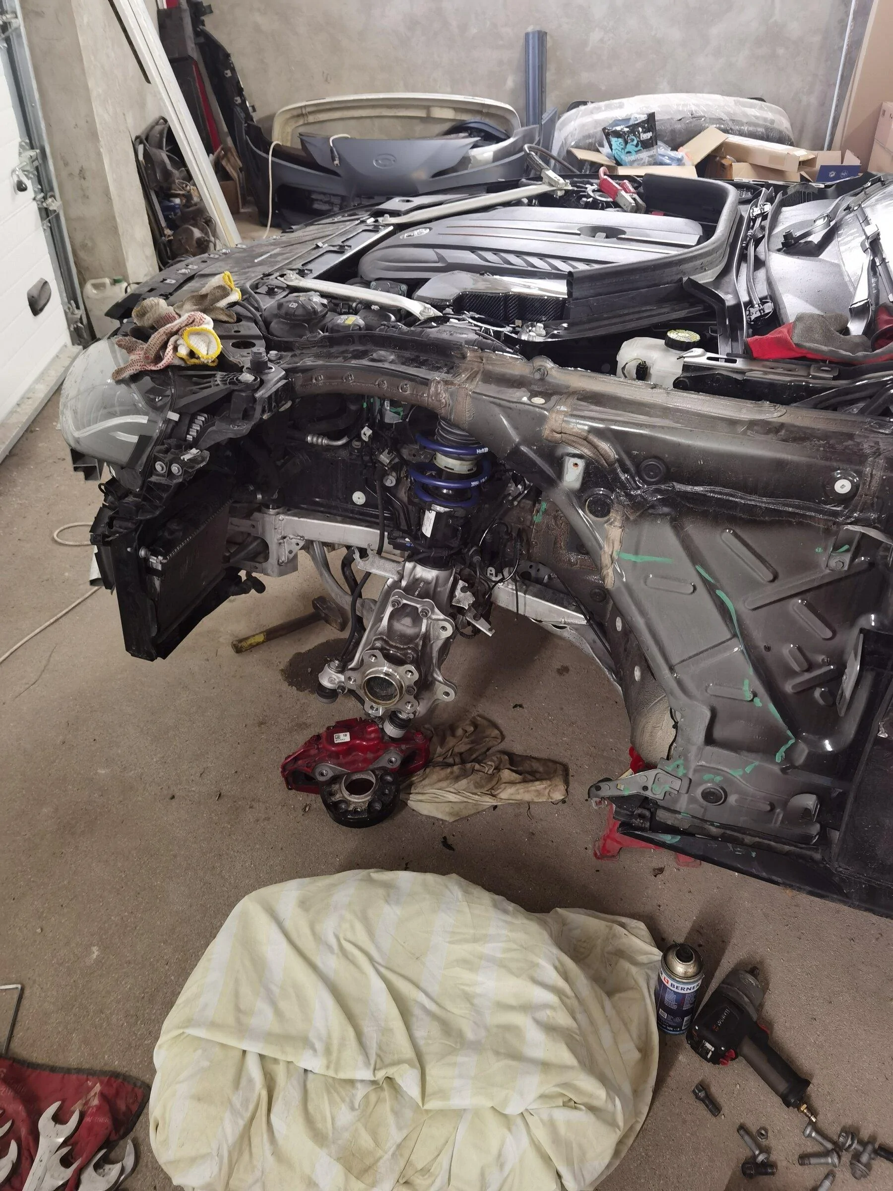

Looks like your stut tower was pushed back thats why the metal tore, better have a frame guy measure it square or make it square before any metal work.
Yes without a question. ?

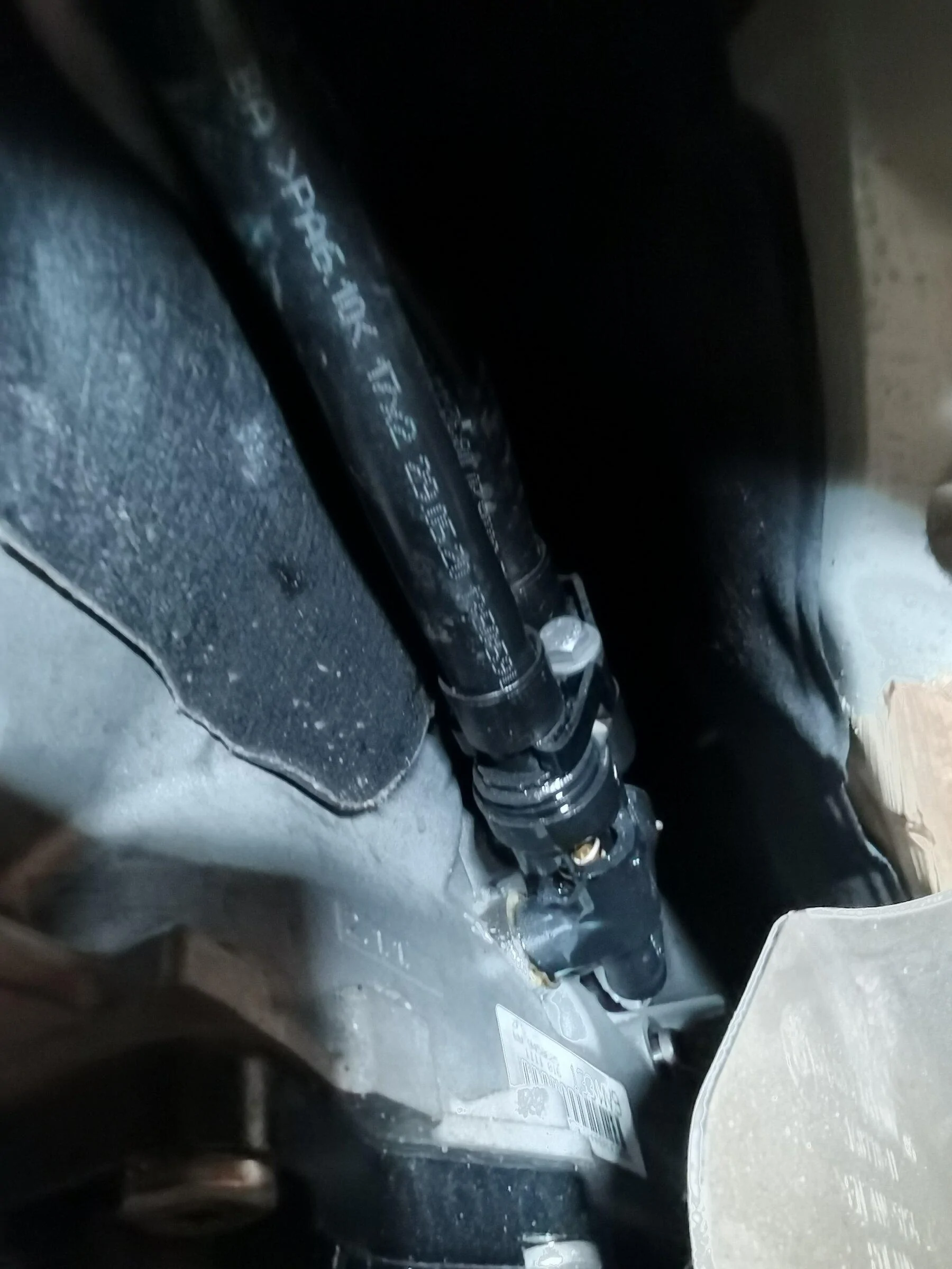

So just put front suspension back together the other day. Already put H&R spring (3 more to go) . Found out that gearbox oil cooling line valve is broken (already ordered at the dealer).
Does anyone know how much oil supose to be in 2021 supras gearbox? I know it says filled with life time oil, but gearbox is low on oil and would like to add a bit. (my dealer do not know).

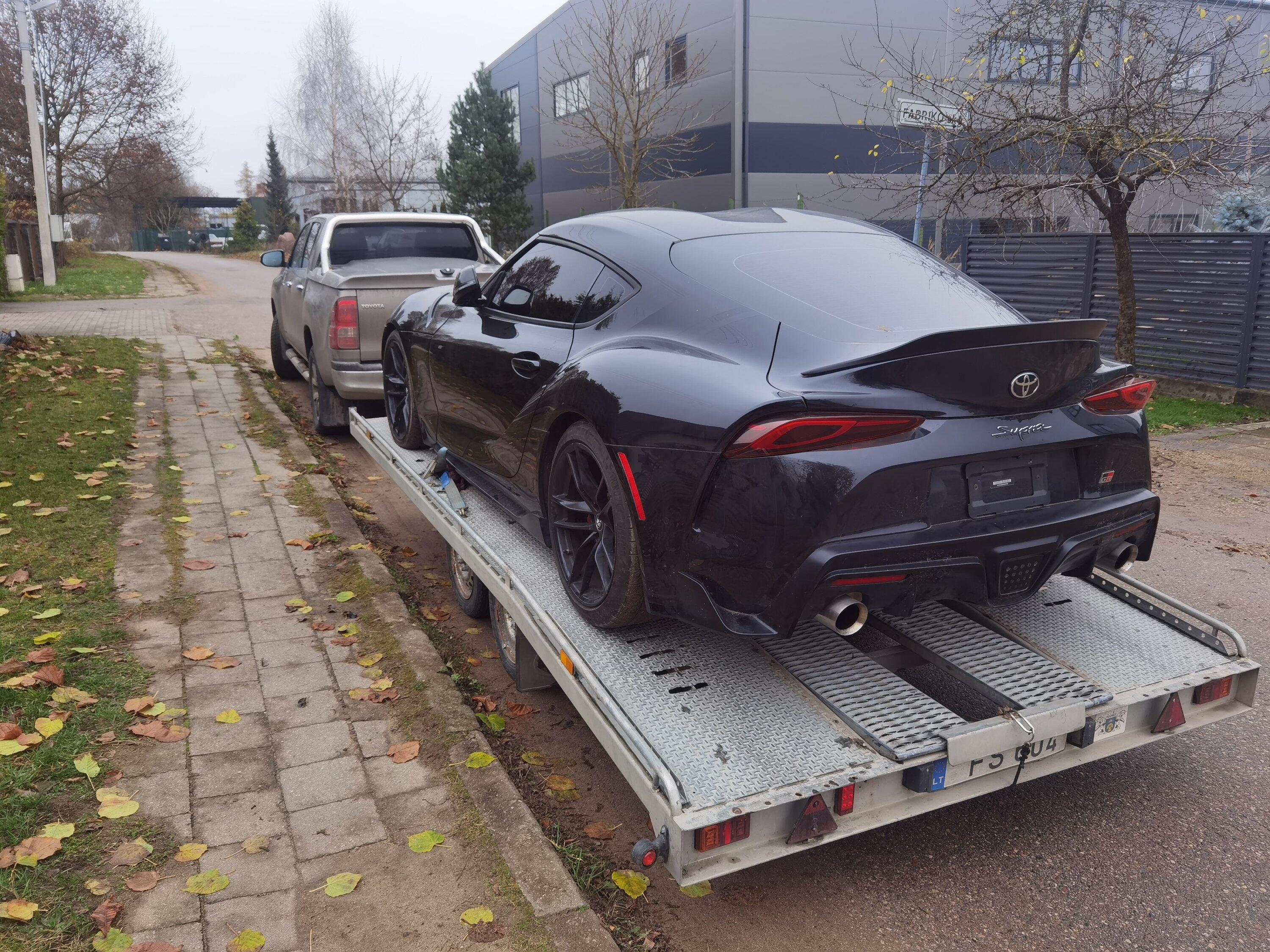

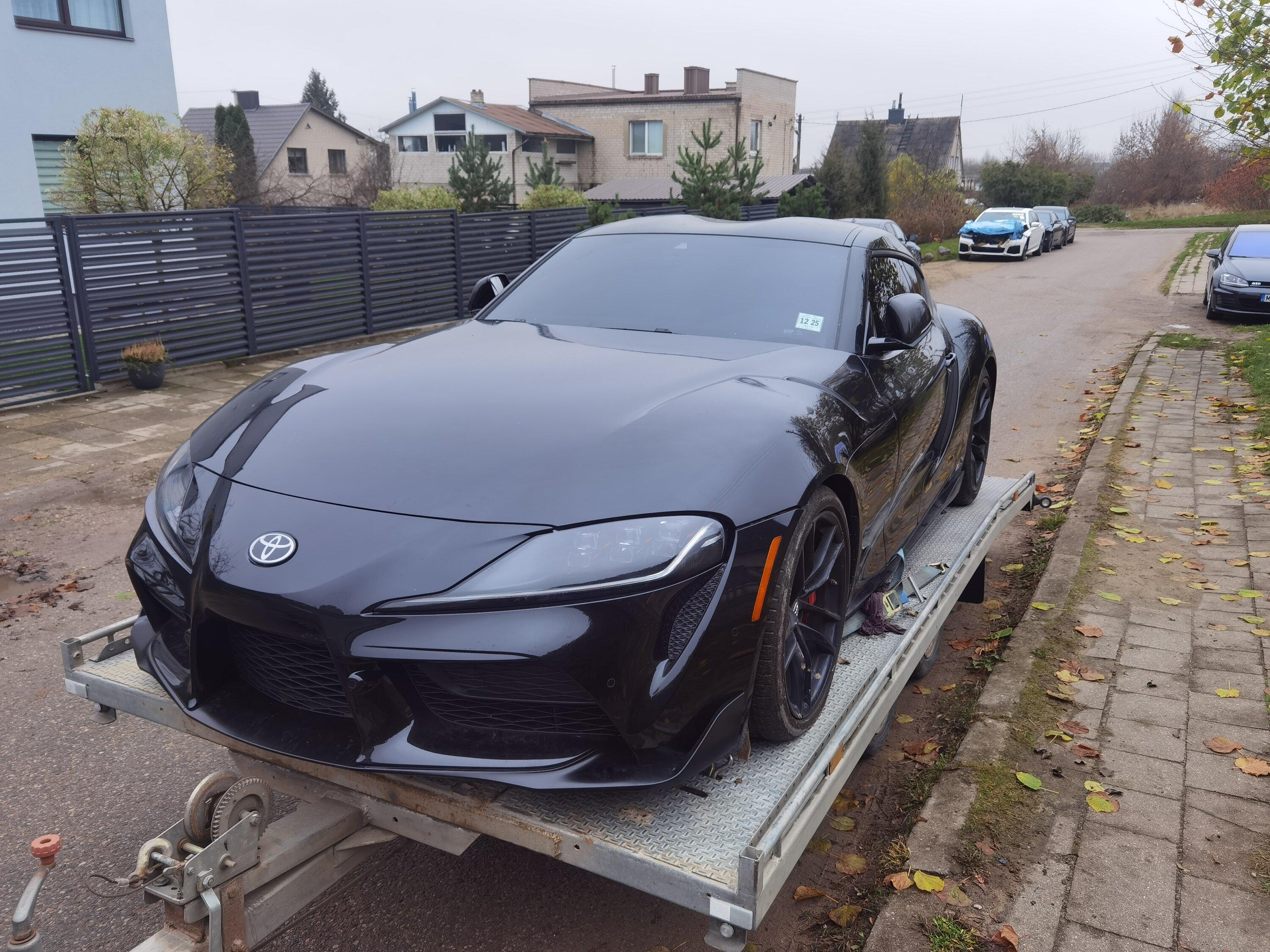

Just a short update on the car. Picked it up few days ago from a body shop. Body has been repaired and painted. Now it runs and drives fine. Few little thing needs to be taken care of and I will be able to register this car on my name.
Still waiting for rear fog light and that will be it. Rear lights also been changed to an euro ones. Sadly it's almost winter time which means I will be able to drive it in the spring as I don't want to drive it during winter.
I do have Subaru sti for the winter so no big deal there ?
(Would love to buy gr yaris at some point).

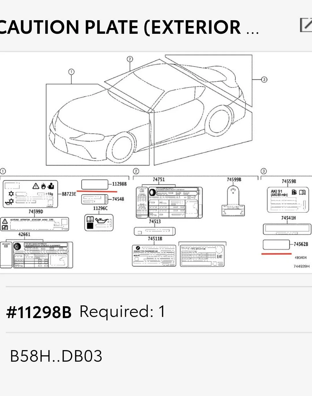

Hi. Need a little help guys. Can someone make a clear picture of their 2021 supra emission sticker? Acording to a dealer it should be somewhere inside the trunk (I wasn't able to find it though). Part catalogue shows that the sticker is in the trunk but might be under the bonnet as well (maybe it depends if it's a 4 or 6 cylinder supra). I found 4 part numbers for the sticker, but I can't be sure which one it is. This code: 11298WAA06 has designation for supras with B58H engines. Does the H at the end stands for 6 port engine?
