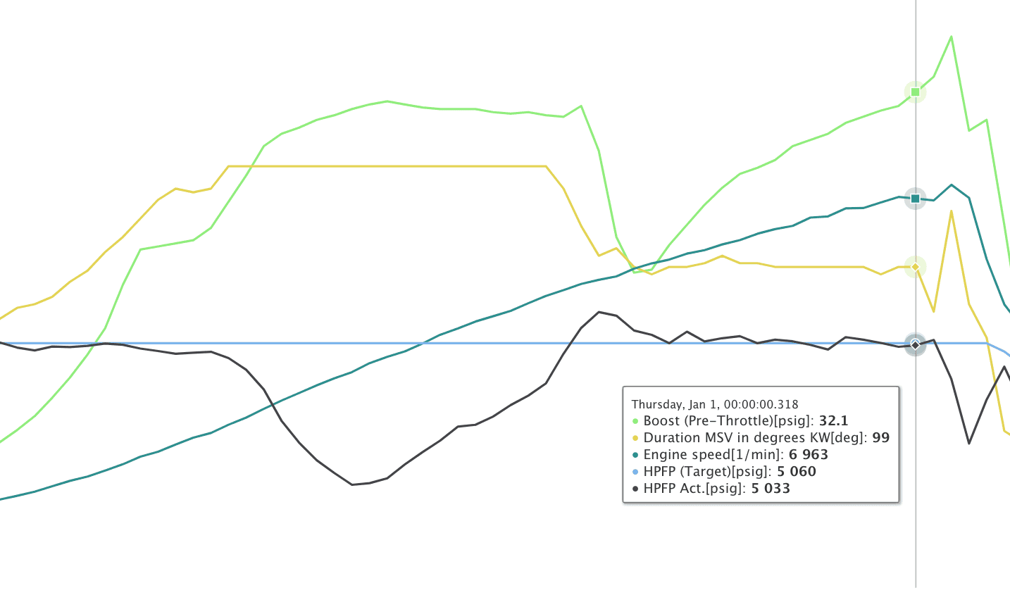

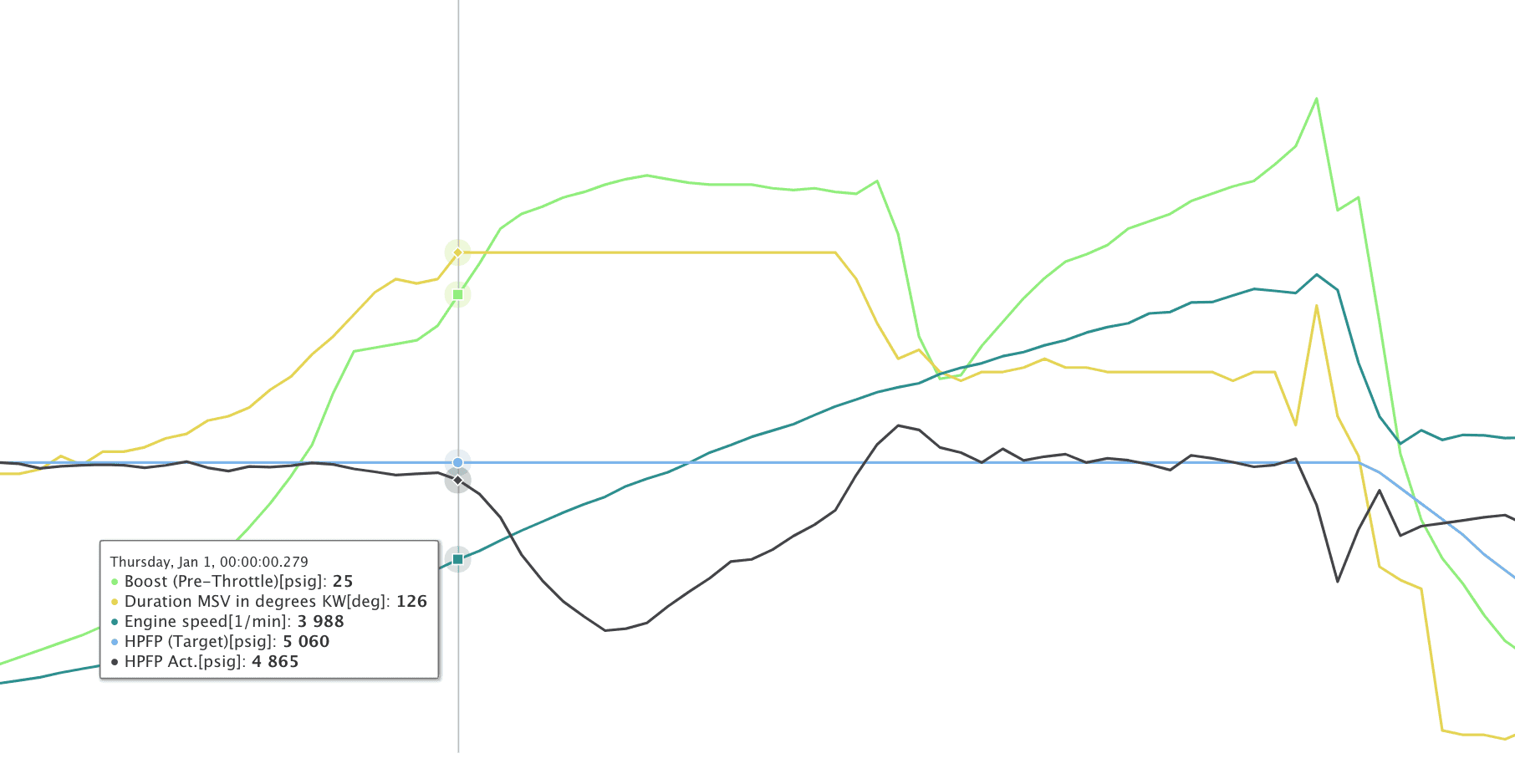

@Awad
Check this out. See how your HPFP angle maxes out down low at 126* (orange plot), and then crashes (black plot), then the car tries to save itself by dropping boost?
Now, check out your HPFP angle at higher rpm with the same amount of boost. Way less angle, right around 100*. If I was tuning the car with your current hardware, I would ramp up the boost down low to higher boost up top, you would lose some torque down low, but would gain power mid and higher up. You would probably be closer to what Spoolin' has been saying is max for what their HPFP alone can do on E50 (670whp). This is also how I get away with 27psi out the top on my track tune with E45 on a fully stock fuel system.

@Awad
Now, check out your HPFP angle at higher rpm with the same amount of boost. Way less angle, right around 100*. If I was tuning the car with your current hardware, I would ramp up the boost down low to higher boost up top, you would lost some torque down low, but would gain power mid and higher up. You would probably be closer to what Spoolin' has been saying is max for what their HPFP alone can do on E50 (670whp). This is also how I get away with 27psi out the top on my track tune with E45 on a fully stock fuel system.
