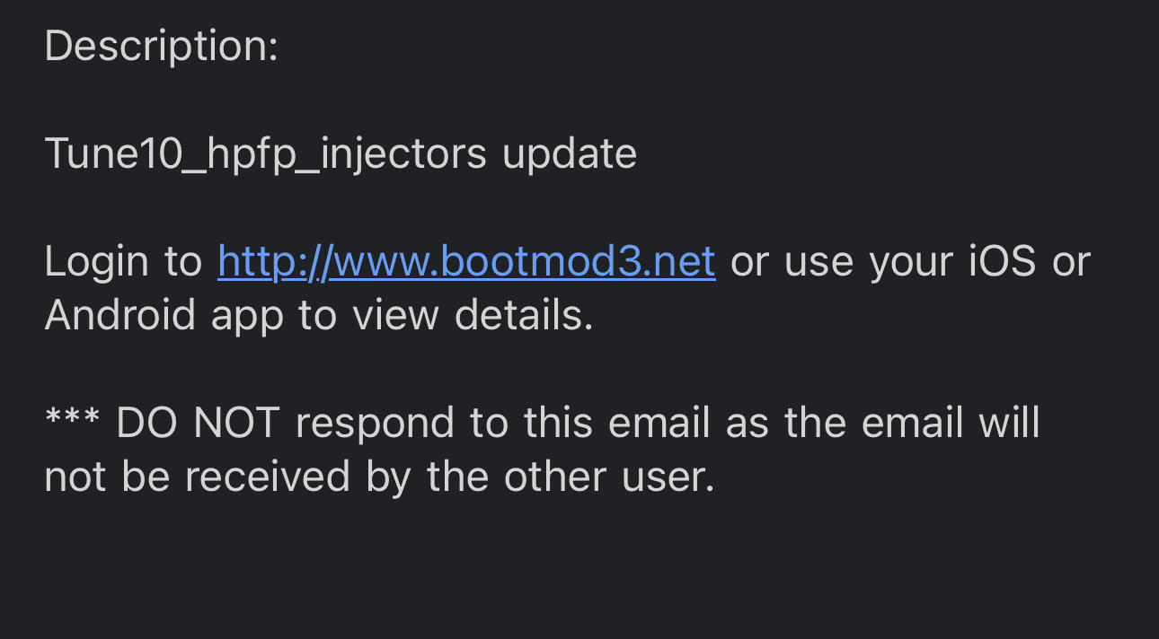

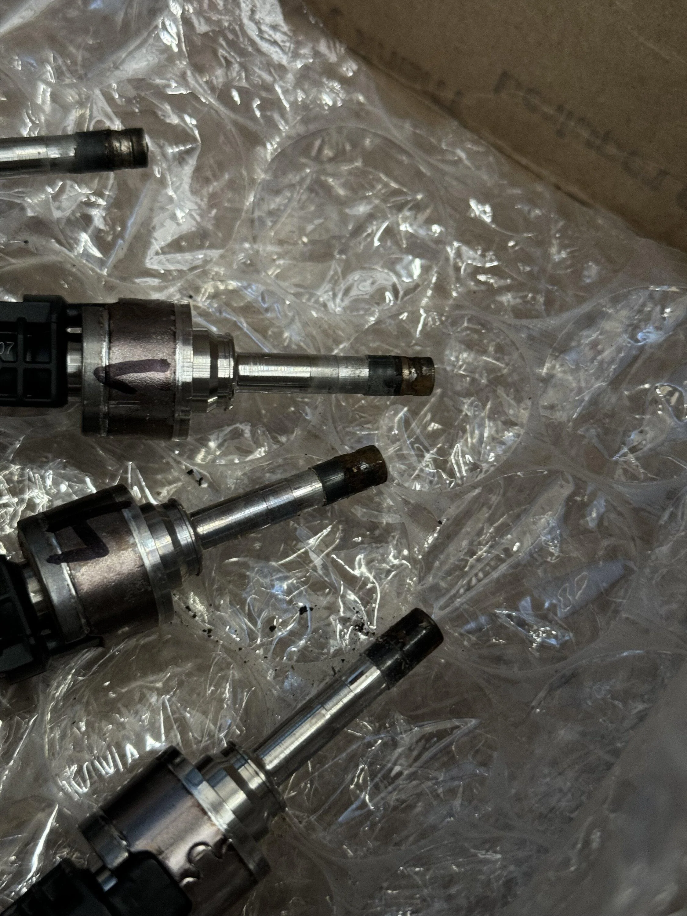

update : as of today we installed all the fuel upgrades I am extremely excited to be able to data log and post data , for people wanting to know how installation was , HPFP and injectors were very easy you just need the right tools for injectors but took less than 30 mins for injectors I also decided to go one step colder and gap to 0.022 as I track and I might lose efficiency if everything gets too hot ! Since everything was taken apart anyway . The LPFP was not hard just time consuming we routed cables in a very clean way you can’t tell at all the LPFP is hob switch activated with a vacuum sensor at 10 PSI . I wish it was like M340i where the fuel hat is in the rear and easier to look through on the supra it sits at an awkward location . The quality of the HPFP was very nice everything is machined and looks very high quality also just looks sick “ I lowkey want a billet cover now “ . as Of now we are working on the base tune to dial in PUMP and E50 tune and I’ll be posting 1/4 miles , 0-60 , 60-120 as well as temps and Dyno sheets . The injectors are also higher capacity so we need to figure out how it reacts ! Huge shoutout to Hassan at HTE Preformnace not only is he a beast when it comes to B58s but also responds extremely quickly which I appreciate it and is always down to help I’ll be posting results soon . As a side note “ my injectors which I have never ran Ethanol through and Spark plugs were not in good conditions after 23K Km , I have ran 13K Km tuned and 4K km on JB4 map 2 and did oil changes every 5K Kms . Below I post a video of condition of both which look a bit rough

Update : I finally received the Map to be able to turn on the car with the upgraded fuel system ill be installing a surge tank setup soon . i am excited to turn on the car and dial it in while on PUMP and then slap a E50 tune . car is in the shop and since we could not turn it on it was stored there i will go tomorrow morning.

to clarify the injectors needed a tool to remove them you can use B48 removal tool , its very easy just be very slow and steady they come out no problem its not like the n54 and the new ones just go back in no problem . very very easy install really

also remove 3 at a time and insert 3 at a time
