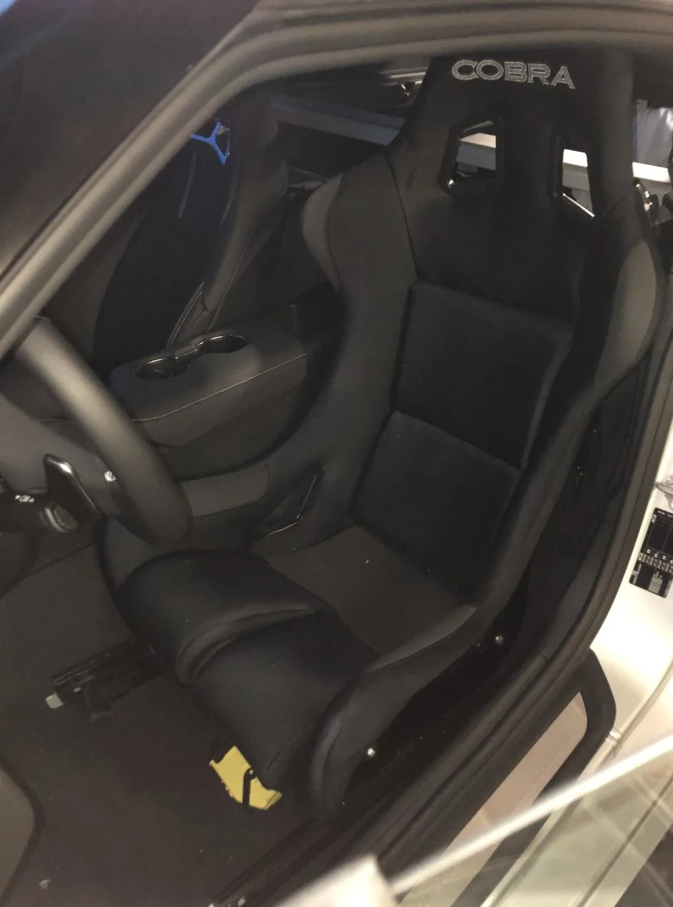

well normally this will be the same as on BMW cars which is 3 ohm.
I have used a 3ohm resistor in my BMW M135 and M140 when installing bucket seats.
do you know if there is a company that supplies a cover to replace the stnd armwrest with cupholder?
Since installing my bucket seat in the Supra the armwrest is way to high and big.
My bucket seat is extremely low as I'm 6.6" but since I'm sitting so low I now hot the centre armwrest.
I've already removed that plastic part and it's way better, but very messy.
So if someone can design a, thin as possible, plastic/carbon part I know there's a market :)
With the current setup I have +4 fingers room above my head.
With the stock seat this was only 1.
Seat is a Cobra Suzuka GT width for big ppl :)

With a 3 ohm one you're not seeing the airbag warning light on the Supra?

Still have to install them but that’s what works on a BMW f20 M135/M140 so i would assume also on the Supra.
