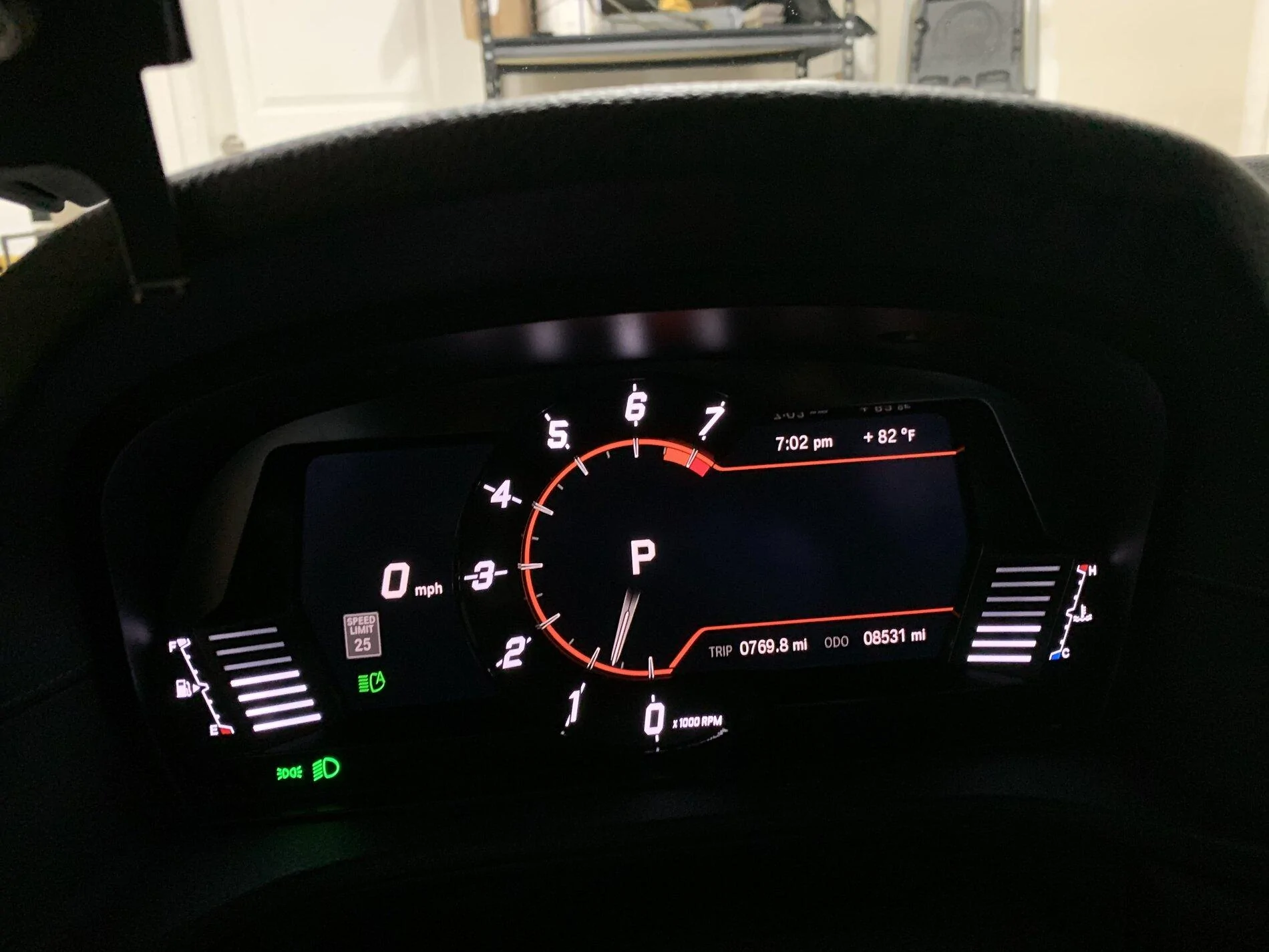

So you left the little white plug for the seat belt receptacle plugged in correct and your airbag light is off as well as seat belt light as long as you're wearing the seat belt? I was told it needed to be unplugged as well, in doing so the seat belt light stays illuminated at all times on the cluster whether you're wearing your seat belt or not.
think you might be misinformed. Iā€™ve attached my gauge cluster after the guy coded out mine. Seatbelt light would shown only if I left the factory seatbelt unplugged (I just plugged mine in from the back of the seat when Iā€™m using my 6 point)
Blue
Apr 27, 2020
67
Europe
BMW & Toyota
So which codes need to be reset and are they using ESTA?
(Iā€™m in Europe and need to get mine coded also after installing bucket seats).
Iā€™m also still using the original seatbelt so i only need the seats coded.
(seat airbags, seat position sensor)
