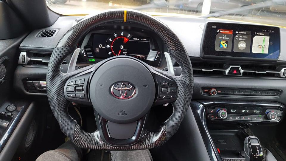

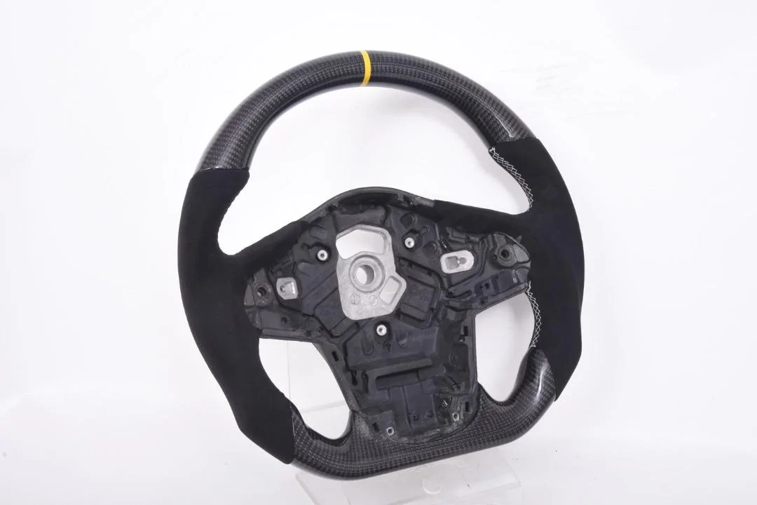

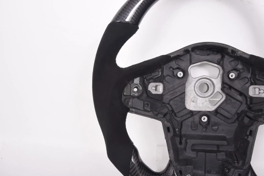

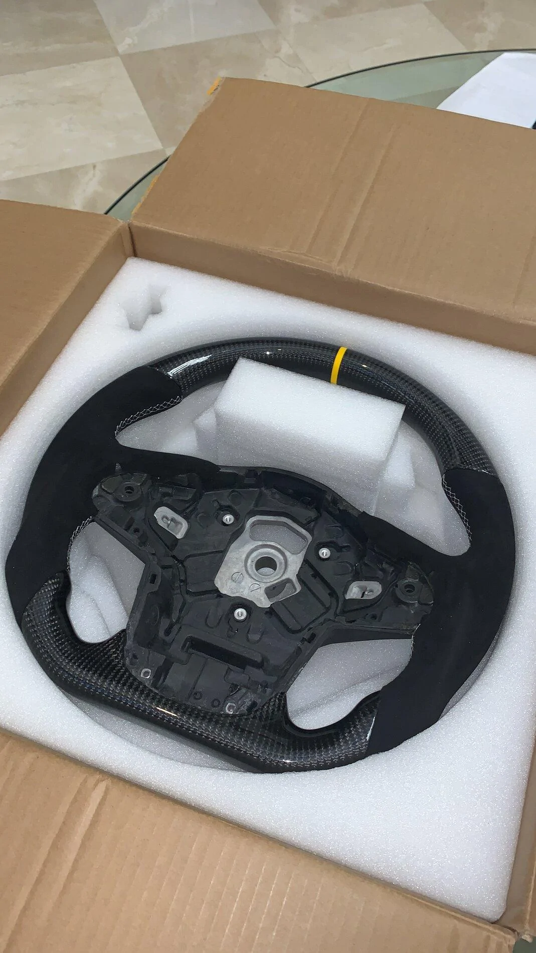

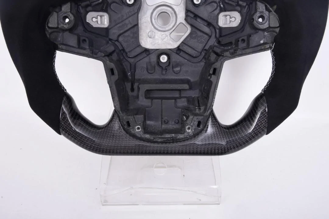

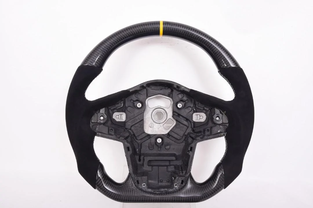

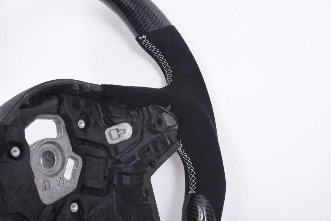

Mine arrived the other night, Can't wait to get it installed, took about 2 weeks from commissioning it to receiving it! uses an OEM Bmw core too, confirmed with the serial number on the new wheel.

Who'd you order that from?

I assume you have watched the various installation videos. Not all are detailed enough so you have to piece together the necessary information, like needing to push the air bag while you fish for the clips (takes only two minutes if you do it right). A couple of things I noticed that were either missed or uncLear… once you are ready to swap components:
- To remove the top molding, don’t pull on it; instead, push the steering wheel’s rubber away from the molding’s pins. That won’t work on the bottom molding so you will need to use a trim tool to carefully lift the molding. Use your new steering wheel for reference where and how the pins attach.
- To remove the receptacles for the air bag clips, after removing the screws, hold the steering wheel so the receptacle is directly in front of you, grab the rear of the receptacle and pull it towards you at an angle and it will come off instantly. Turn the steering wheel and repeat for the other two. To install them on the new steering repeat the process only push the receptacle in the opposite way you removed it; that is, position it at an angle and push it back and down (no need to use WD40 and struggle pushing down).
I hope that helps.

directly from the owner of a manufacturer in china, i got her whatsapp and have been going through her, Can get for around 700 shipped any spec, led an extra 145
