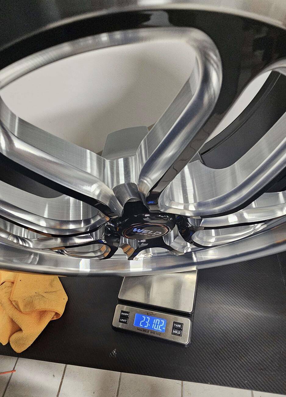

Weld laguna drag wheels (17x10)... supra fitment, part # S15270045P40
23.7# each, heavy as fuck. On my calibrated postal scale
There is no curve in the spokes, they are straight, so a good portion of the weight is just the huge block of aluminum in the center hub, to get the offset/rim height. This is good at least, because weight there will affect rotating mass the least. WAY thicker then your typical apex/titan/stock wheel in the center hub - but all of those have curved spokes to the hub. Just my observations.
Buy the titan drag pack instead (which are 18.7#) unless you get these on sale like I did. They do have serrated bead faces.

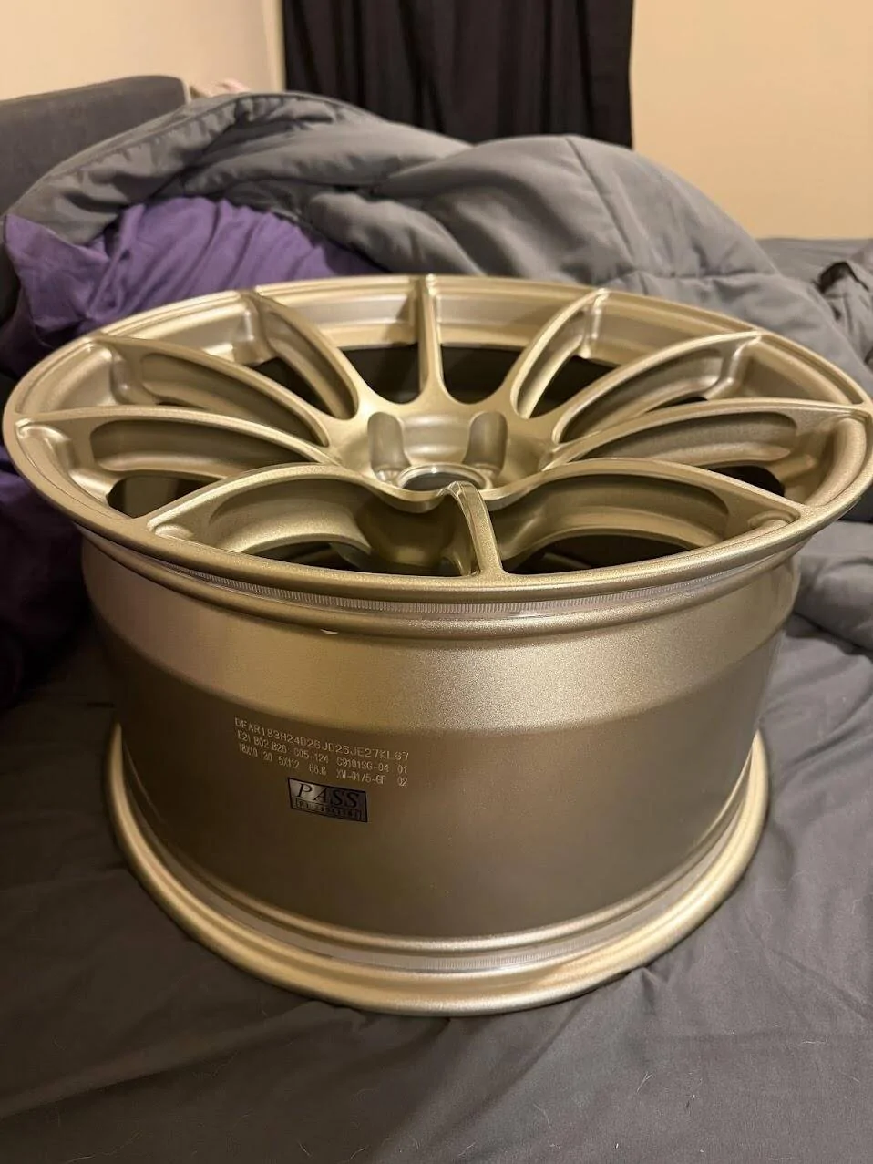

Just making this thread to have it easily searchable for those who are curious.
POST YOUR WHEEL WEIGHTS!!!!!
Apex SM-10RS 18x10+30 Wheels weigh:
18.2lbs
(I weighed the Motorsport Gold color but this shouldn't matter at all).
Stay sexy.
18.2lbs
Stay sexy.

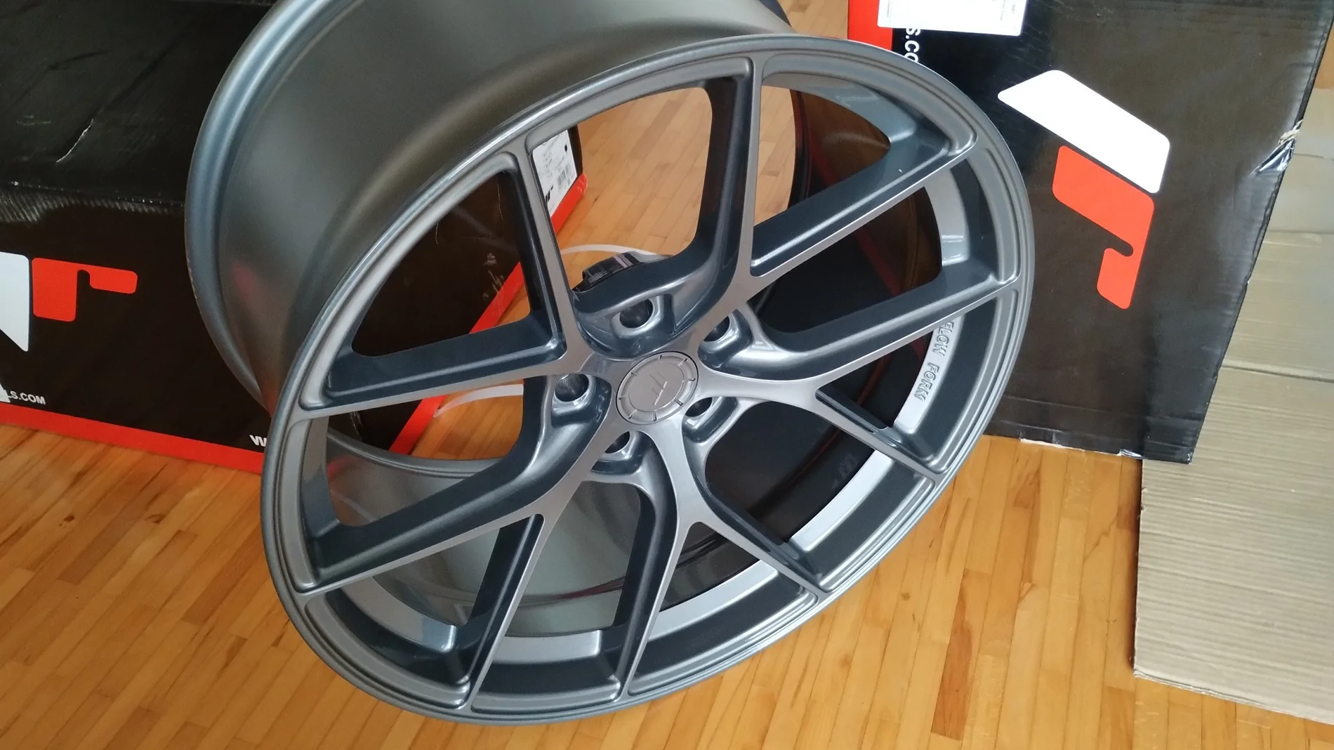

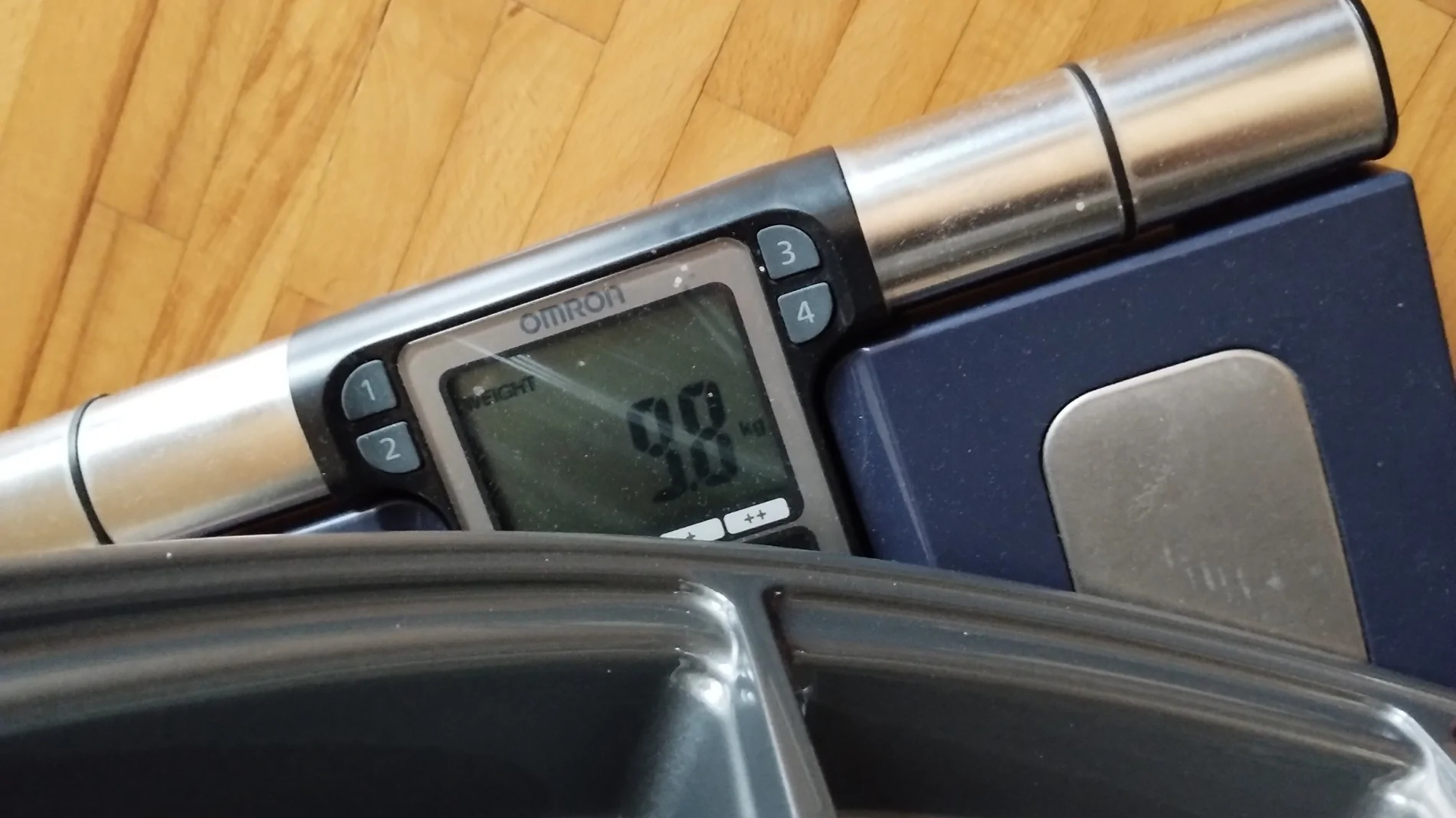

Japan Racing SL01 - Gunmetal Gray Light
Front
19x9,5 +31
Weight: 9,8 Kg / 19.84 lbs

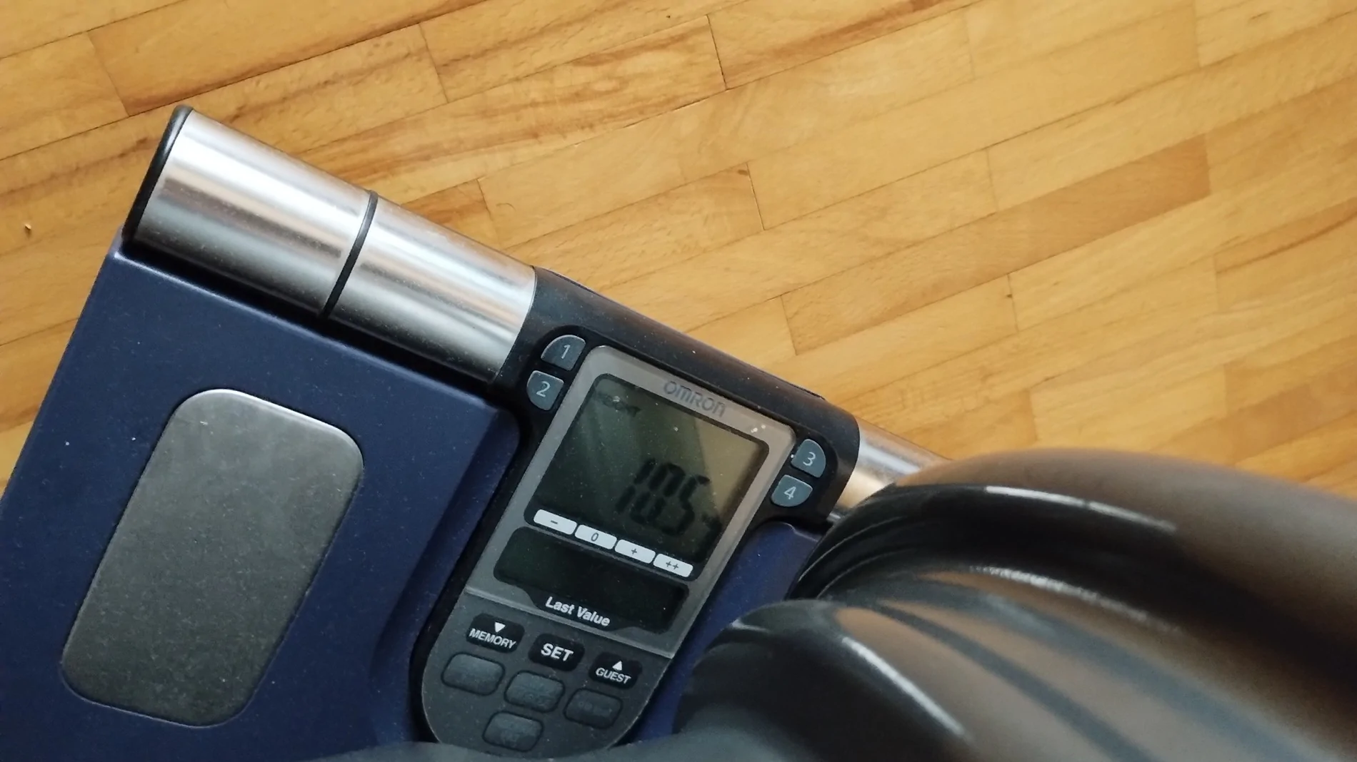

Back
19x10,5 +35
Weight: 10,5 Kg / 22.04 lbs
