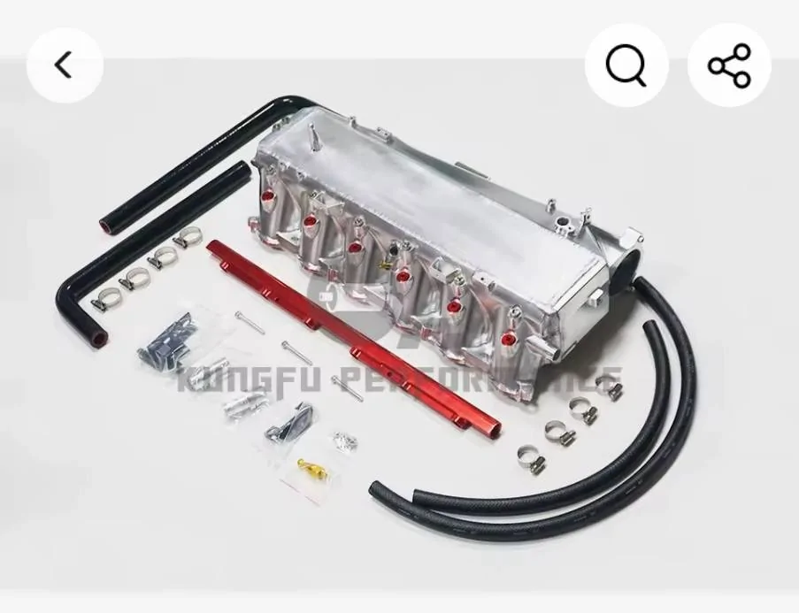

Aliexpress B58 Gen2 Manifolds??
A little update, intake is in ??
Ill report back how it goes tomorrow.
Curious on how much heat will come down. Well done ?

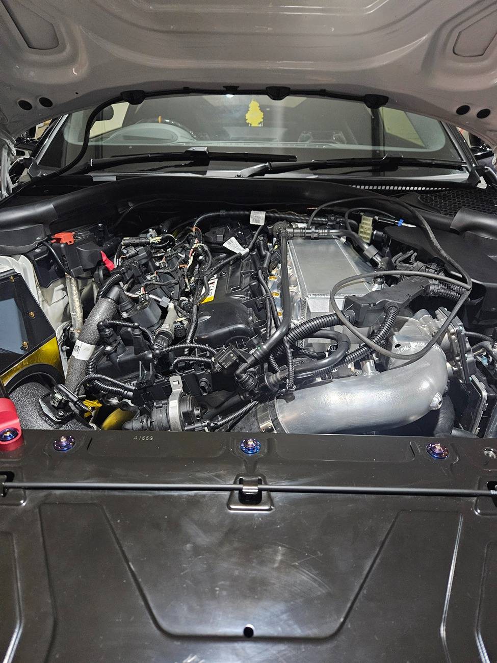

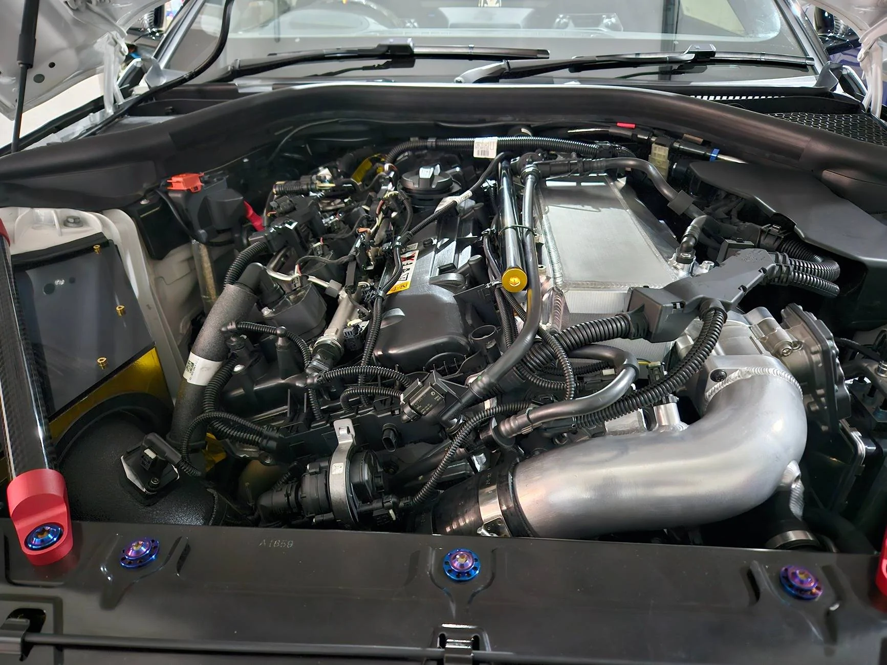

Fully installed, the most difficult part was removing the stock intake manifold.
I followed the Kies motorsport csf intake manifold install video.
Intake temps are cooler and sit around 10-15 deg C above ambient vs when i had the stock manifold with similiar temps between 20- 25 deg C above Ambient.
Something else i noticed is that the intake temps come down a lot quicker then with stock temp amd it doesnt heat soak.
