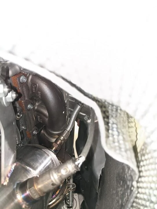

Small update: AMS asked that the downpipe be sent back to them to see what's going on (possible one off issue as I've heard of other '21s running their catted DP). I've been working with Alex and Daniel @ Speed Industry and the plan is for them to send me an A.A. downpipe as a replacement.

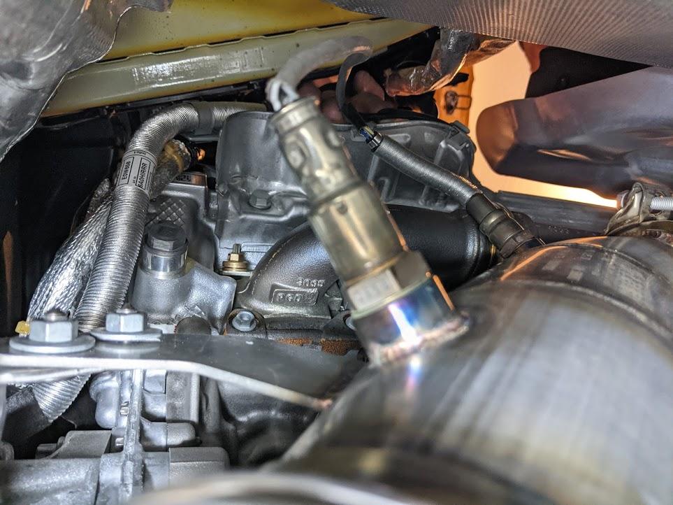

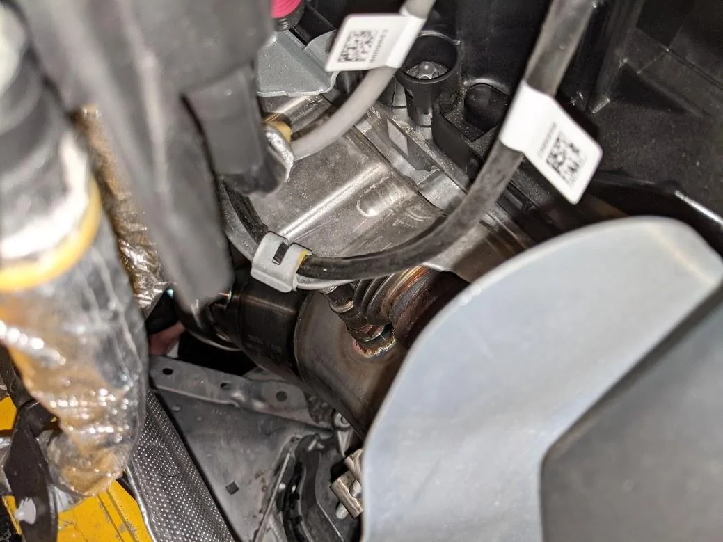

I have the SAME issue (on a 2021), and I sent in a message to Alex so R&D can "have a look at it." I have not received a response in a few days now, so I was wondering what is going on. Here are pics of my install. Mine also has only about 1/8th of an inch from the transmission bell housing when installed correctly. Tight squeeze.

Checked mine. There is NOT plenty of clearance between the top O2 sensor and exhaust manifold, about 1/8th inch. I suspect that because of the change in exhaust manifold between the 20 and 21, the clearance is less. This is the same issue that Verus had with the heat shield. The Verus heat shield is different between the 20 and 21. Don't know if there will be long term impact between the clearance. There is no rubbing.

Alex just got back to me and said that R&D is actively working on it, and he will report back. I will keep you posted. I wonder if the 2021 exhaust manifold is longer, and that makes it so they don't fit as well. Just a theory. On my install I had about an eighth of an inch from the exhaust manifold, and an eighth of an inch from the transmission bell housing, but it's pretty dang close.
