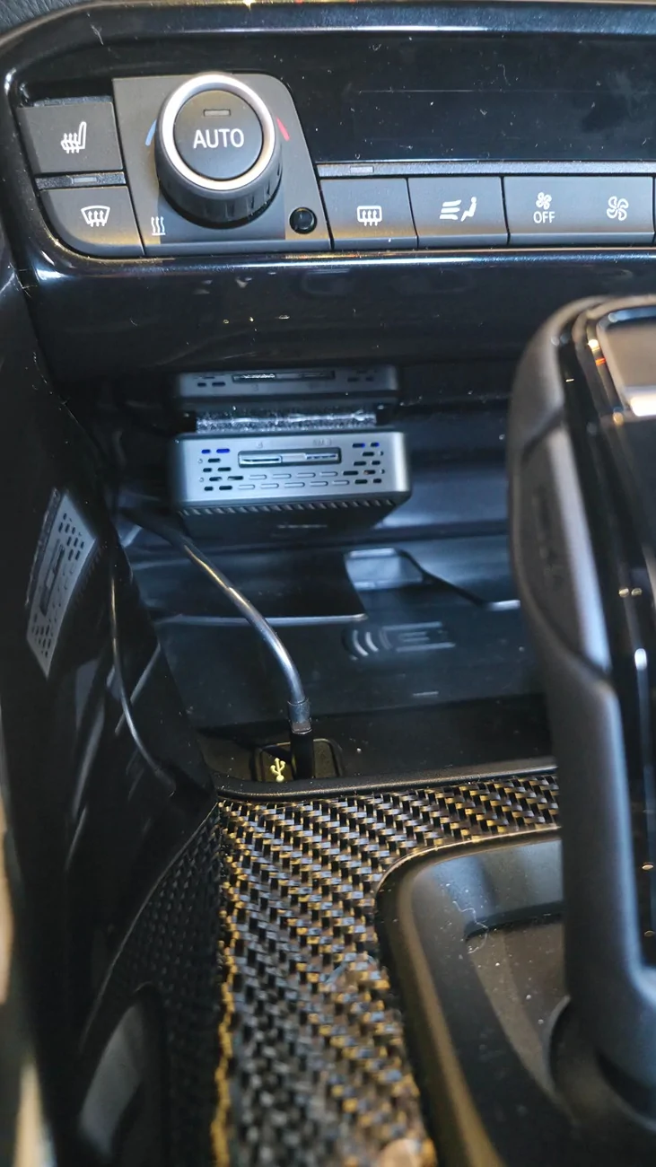

Photo of the install

Mounted by a double-sided tape, correct?
I used a strip of velcro for now. figured if I needed to pull it out to troubleshoot something the velcro would be necessary. But so far I haven't touched it since it was put in a couple days ago
Good idea. I will probably get a double-sided suction cup.
