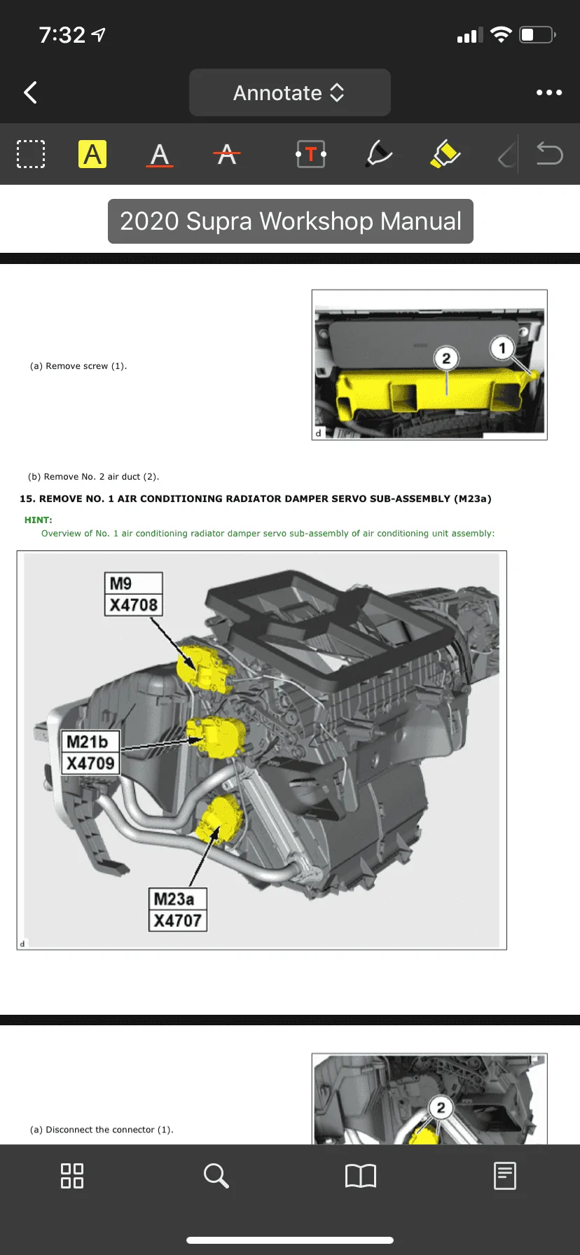

This has to be an issue with the mechanical Vent blender/ air direction flaps inside the dash. BMW called it the damper servo. They might not be switching from the defrost position to not blow air on the windshield and blow it out the correct facial / floor vents. Air should not be coming out of the upper windshield vents unless defrost switch is on. Also make sure you do not have the recirculate switch on A or M. With that switch off it brings in fresh air. With it set to a or m it recirculates damp air inside the cabin.
page 2683 of Supra service manual
