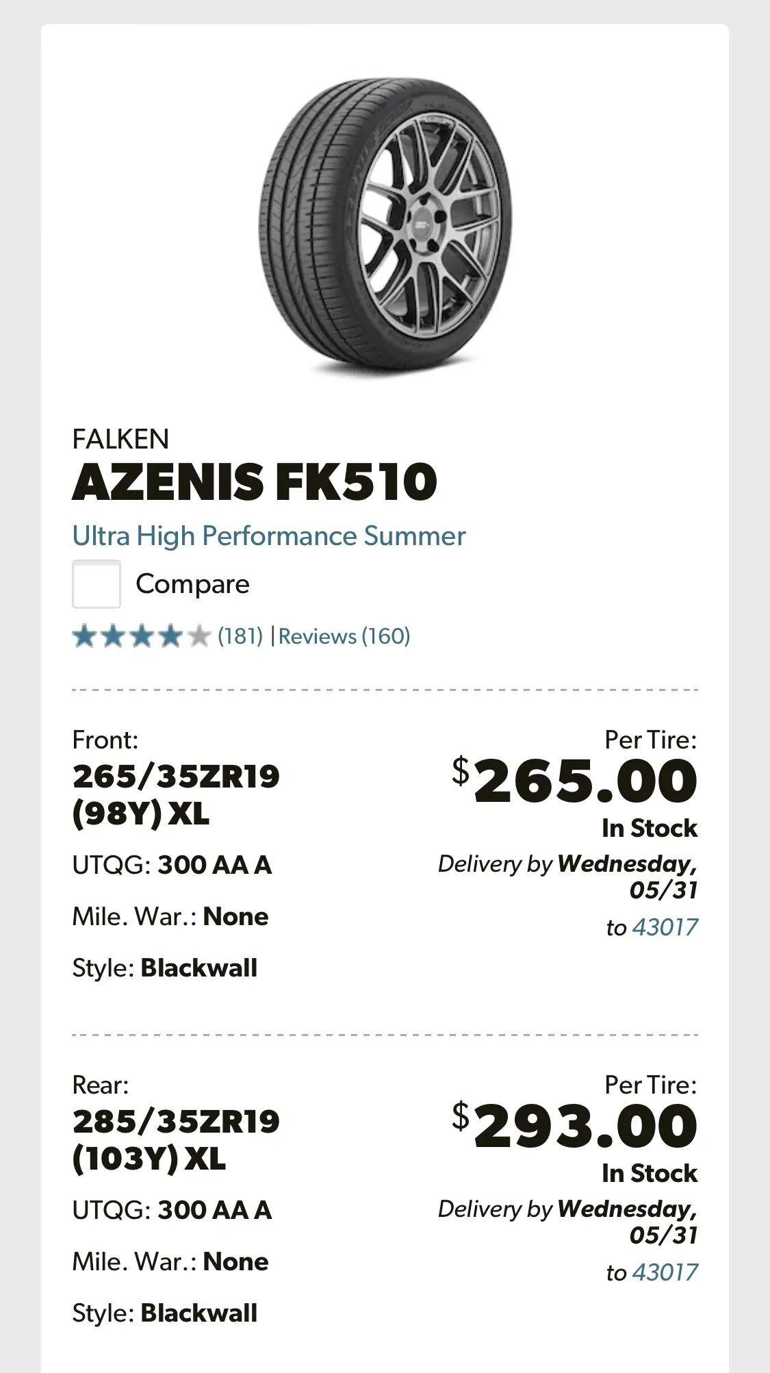

I have these Falken Azenis FK510 tires on my Supra on 20ā€ wheels and itā€™s an amazing tire. Zero negatives here.
Not sure if they are offered in your increased sizes.

~ looks like they do make the preferred sizes youā€™re looking for (the tire rack).

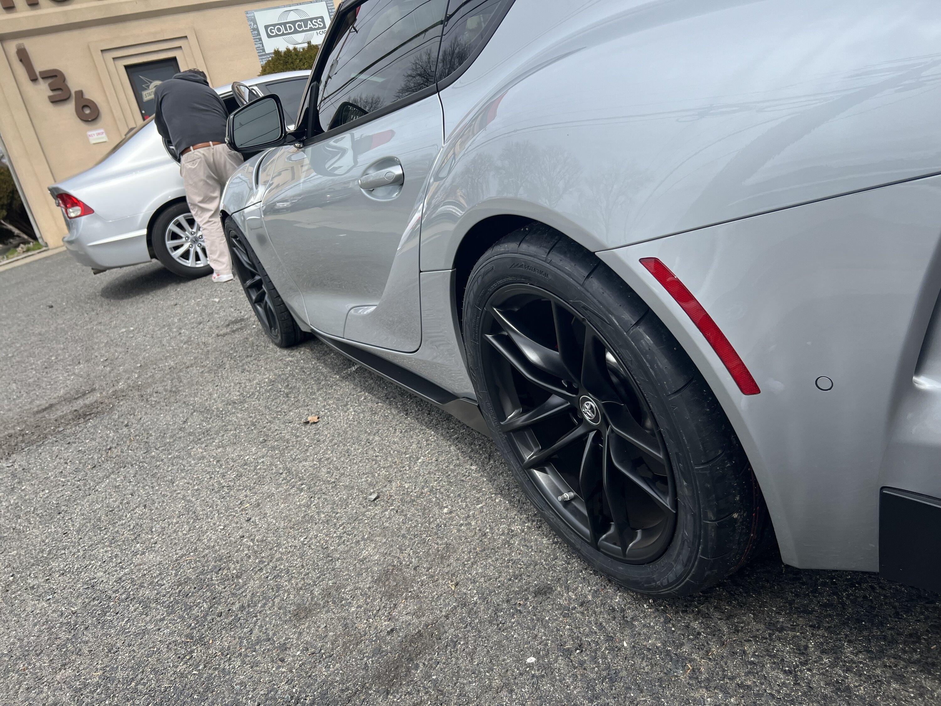

Stock wheel/tire/suspension
13mm spacers on front, 15mm on the rear
front
rear
