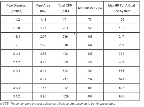

Lets first calculate the exhaust of the Supra. From a quick google search it says on average the car needs about 2 cfm per 1 engine HP. The 2021 Supra has 382 for a rough total of 744 CFM through the exhaust system as a point of reference, in an office building if you have 100 sq ft office you can guess it will have about 100 cfm.
As you can see the 3" downpipe is good for the 744 CFM coming off of the exhaust but the 382 HP is above the recommended max HP per pipe. Note once again this is all rough data from the first google link when i googled "how to calculate muffler sizes."
It is perfectly ok to have higher than recommended flows but in the downpipe you also have the CC which is going to increase the overall area the exhaust can flow. I imagine that the DP is also made of a stronger material than the rest of the exhaust system.
So now that we have made it through the CC at 3" why not just stay with the single 3"? It has to deal with the back pressure and there being more than optimal flow for the exhaust system past the downpipe. You would likely want to do the 3 1/4" or 3 1/2" exhaust assuming any mods were being done. splitting it into 2 is going to cause back pressure at the fittings where it splits but if you have the (2) 3 inch pipes you have more area, so slower fluid flow, less pressure drop, and less back pressure all causing better flow.
