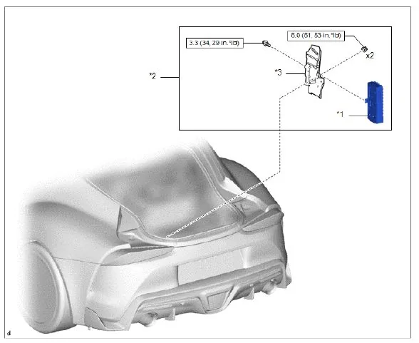

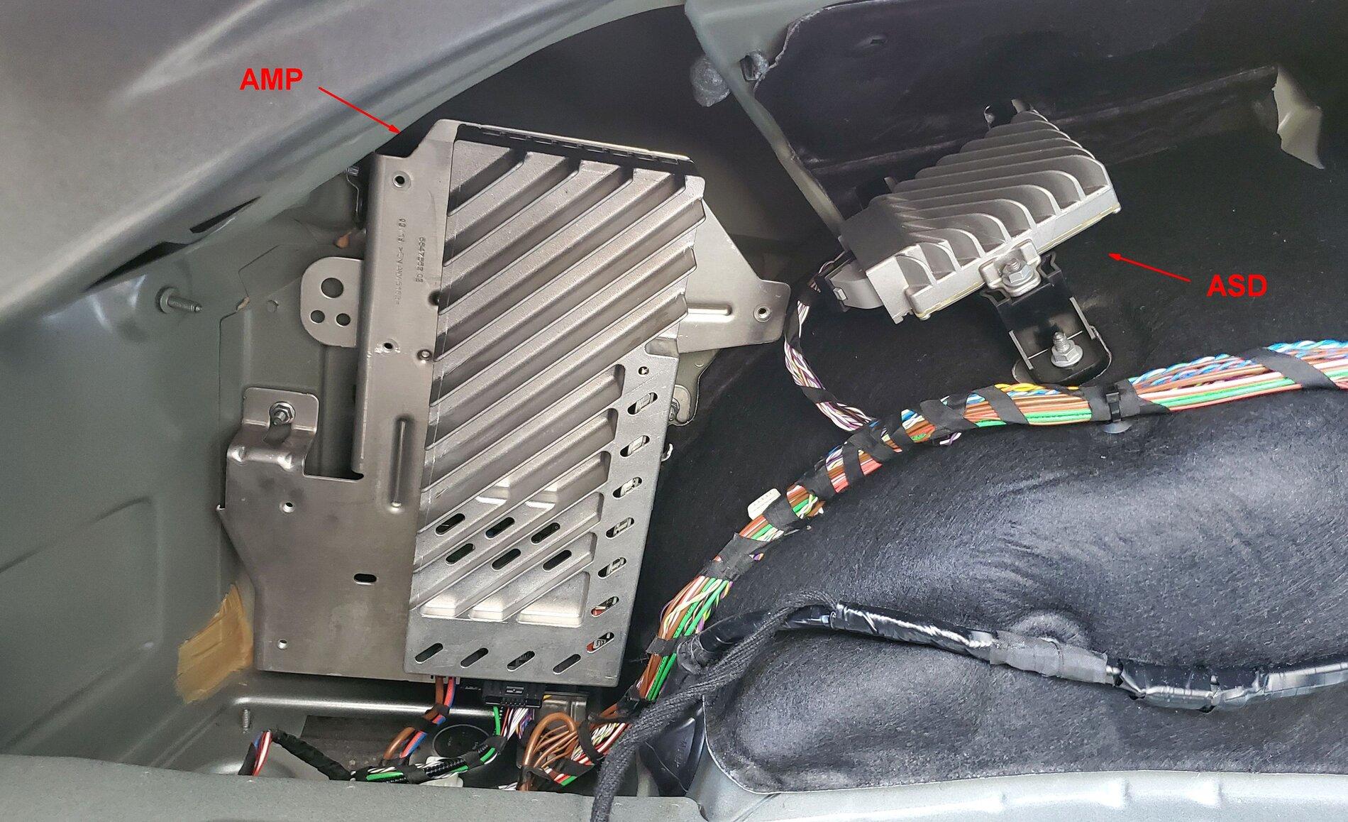

Another option to consider which doesn't require using Bimmercode...
You can also remove the plug from the ASD module to disable it which doesn't require any coding at all...This only takes 15 min to remove 2 panels, unplug the ASD module, and reinstall panels...

I've done both ways and one is really not that much more difficult or time consuming than the other....The biggest difference is disconnecting the ASD plug is free and doesn't require purchase of Bimmercode and OBDII module....
