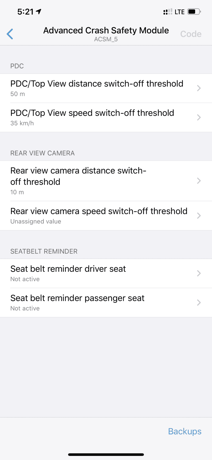

    Don’t see seatbelt minder menu. Where did you change this?

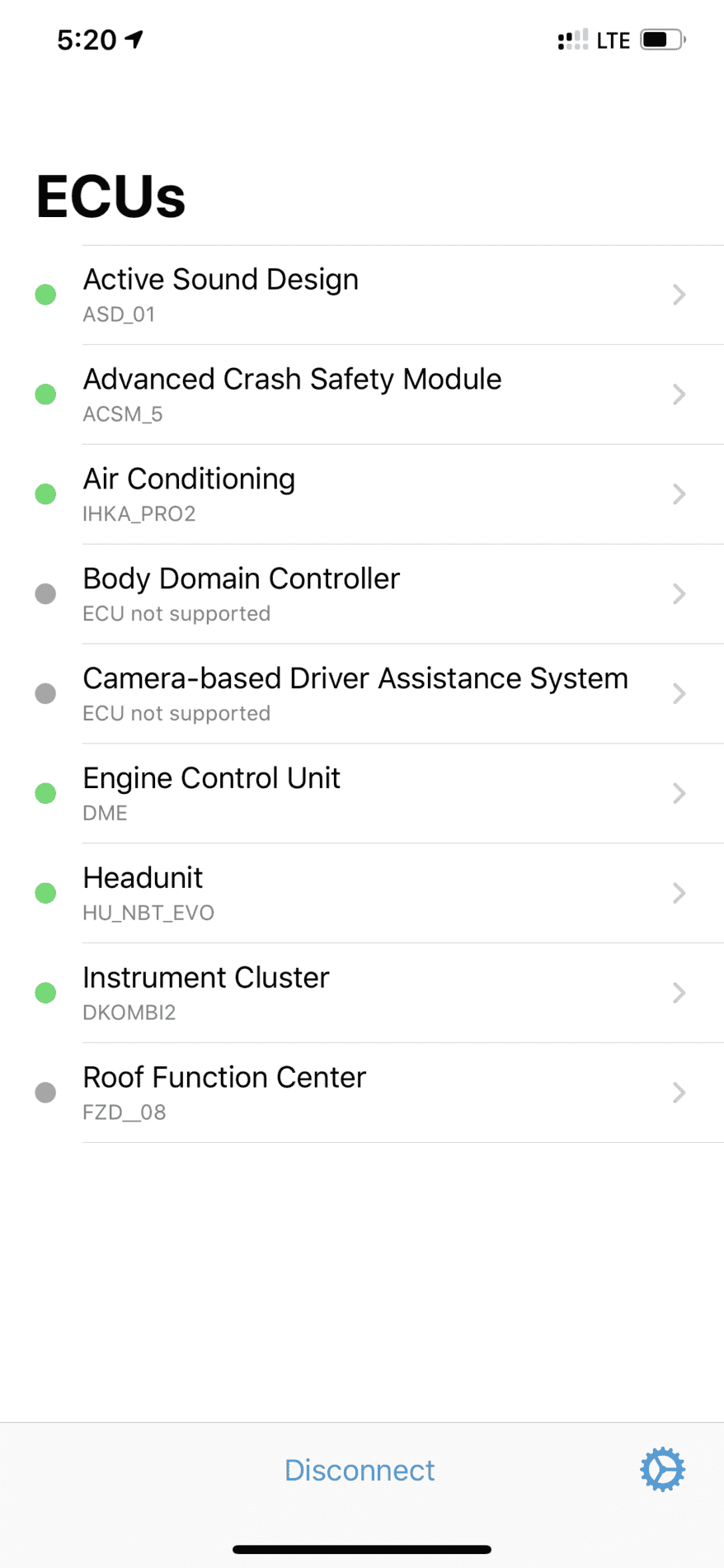

    I believe it was under the advanced crash module

  15. Brian04
    Brian04 Member
    First Name:
    Brian
    Car(s):
    Joined:
    Sep 8, 2019
    Location:
    Houston
    Posts:
    Liked:
    here’s what modules I have and it is under the advanced crash module as per photo I attached
