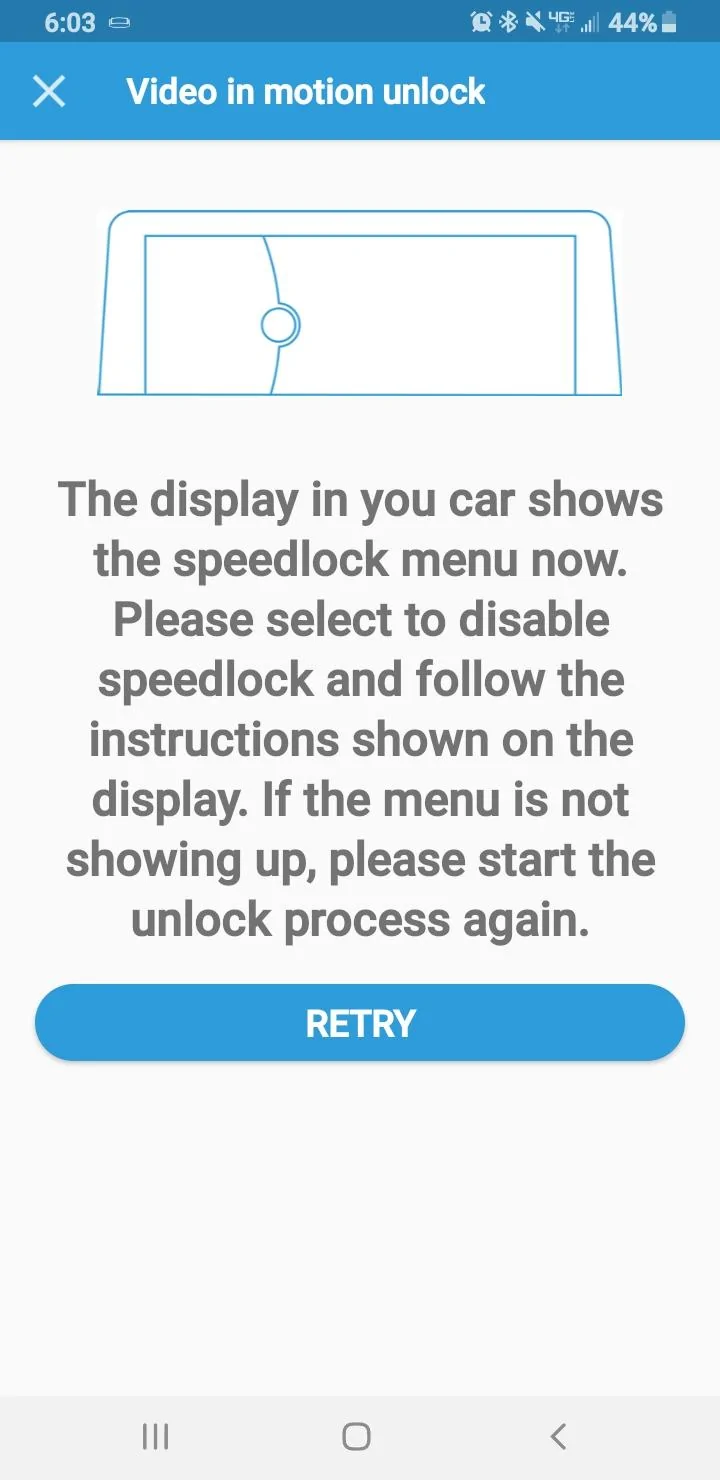

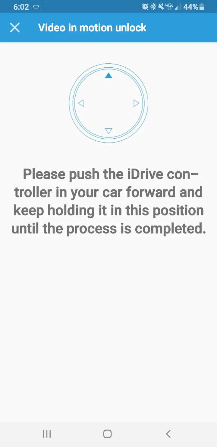

There is a stage that I was able to do with my JCW that I cannot find on the Supra for ViM it tells me to go to setting or location and the Supra just does not have it. the guy who said he did it never replied when I asked how he moved past that stage.
spike89
Oct 7, 2019
1966 Mustang 1989 Supra 2017 Tacoma 2020 Supra
Look at my post in this forum. Post #15. Make sure to do the step after coding. I have always had to do one retry to get it to show the cdmm speedlock.
Here are the screens from the final step of VIM.
