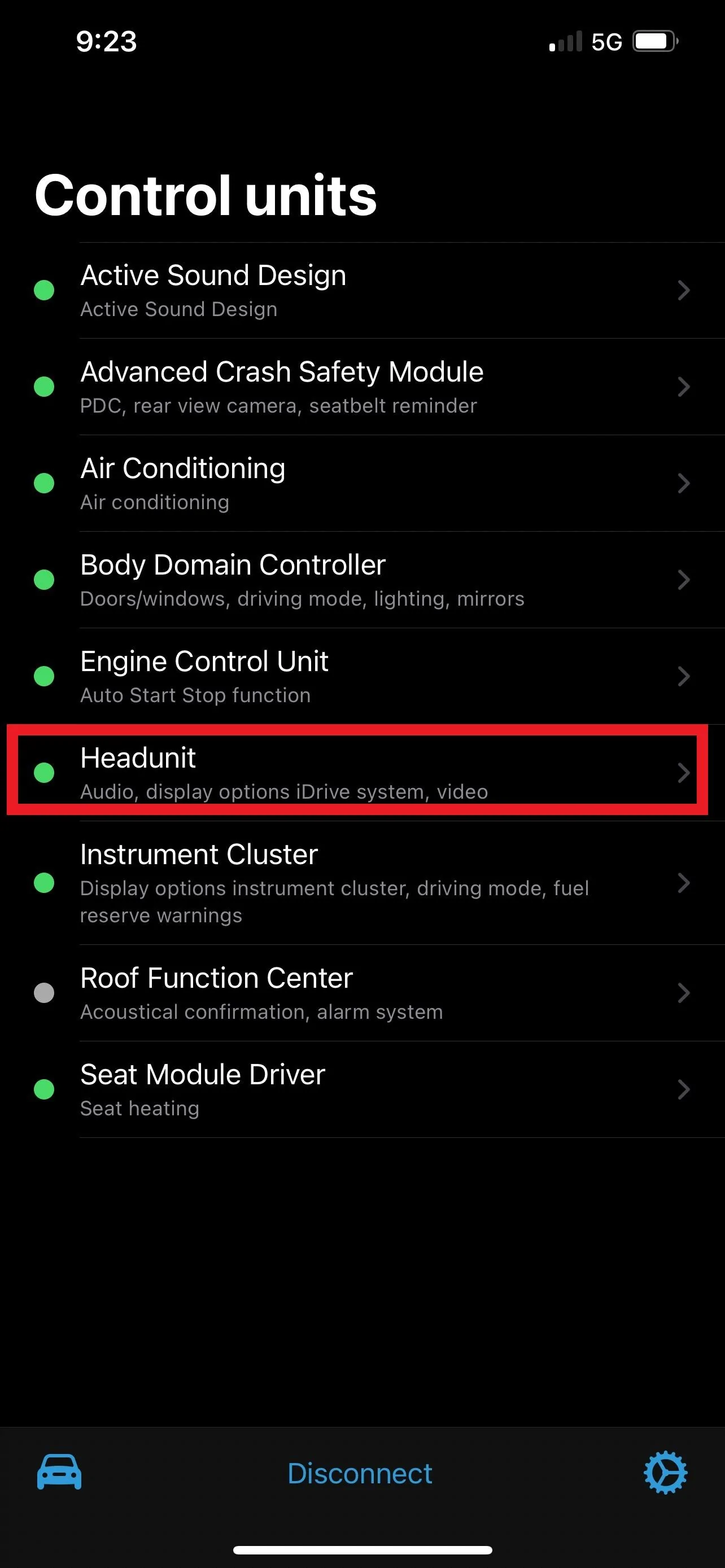

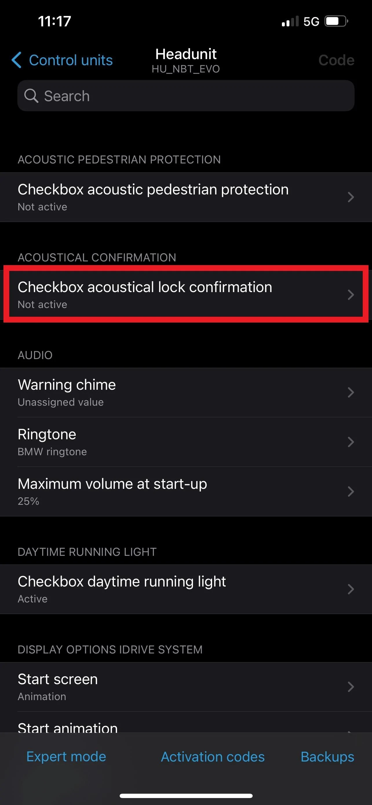

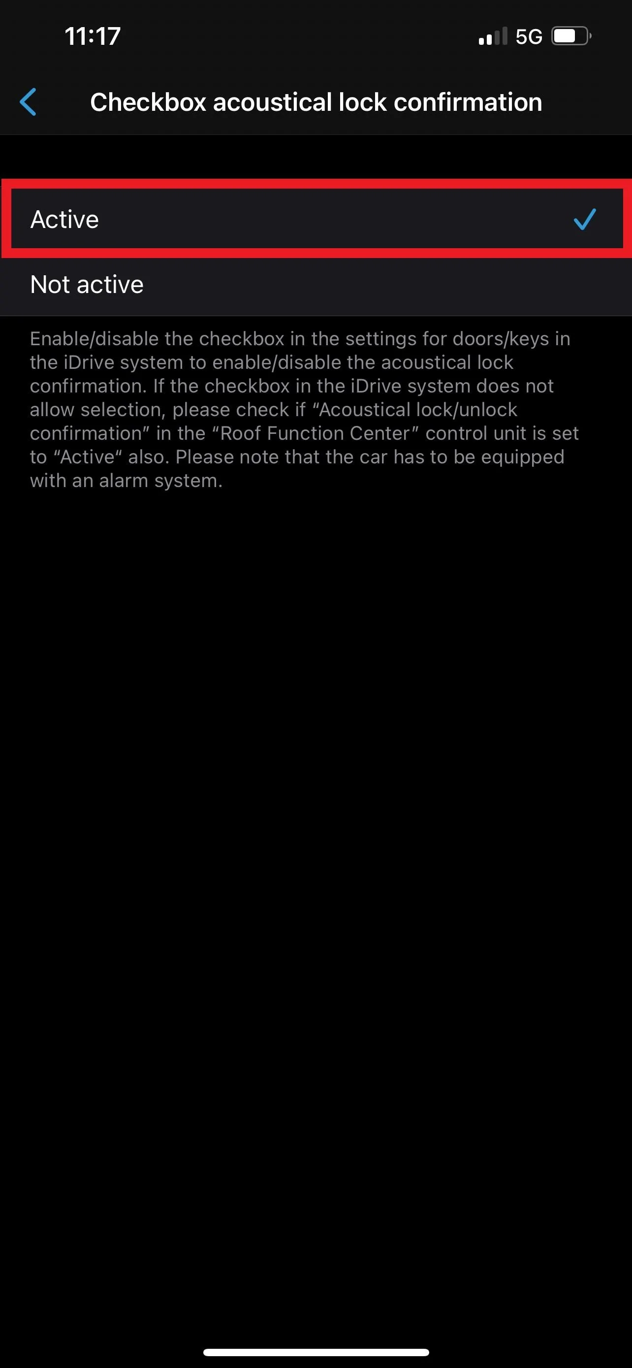

So for anyone wanting to turn off the chirp you dont need to have the "Roof Function Center" control unit enabled in your bimmer code app. From the bimmercode main menu navigate to "headunit", select "Checkbox acoustical lock confirmation", then click "Acitve", then code that shit.

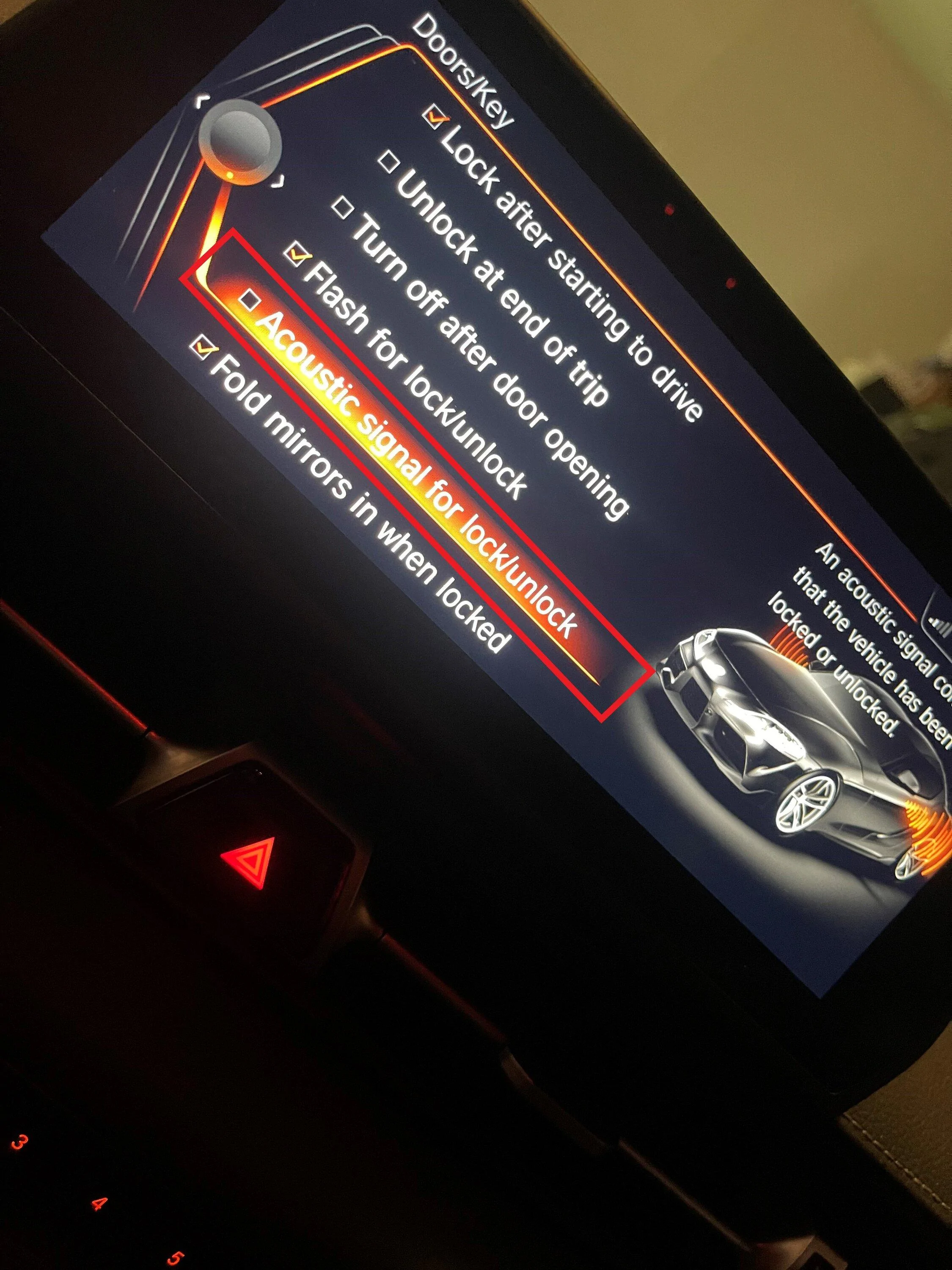

Now you in your head unit navigate to Vehicle settings -> doors/keys and you should now have an option to turn off the chirp. Thanks everyone for helping out ?!!!
Also, you have to have the car running to turn this feature on or off on the HU. I tired disabling it after I turned the car off and it didn't do anything. Once I turned it back on, I could uncheck the box.
Thank you! Thank you! Thank you! Was annoyed I couldn’t turn it back off since I lost the Roof Function module after the recall. I want to keep the chirp but turn down the volume and I can’t anymore…yet.

So a heads up, BimmerCode has an update that brought back the ability to use the Roof Function module.

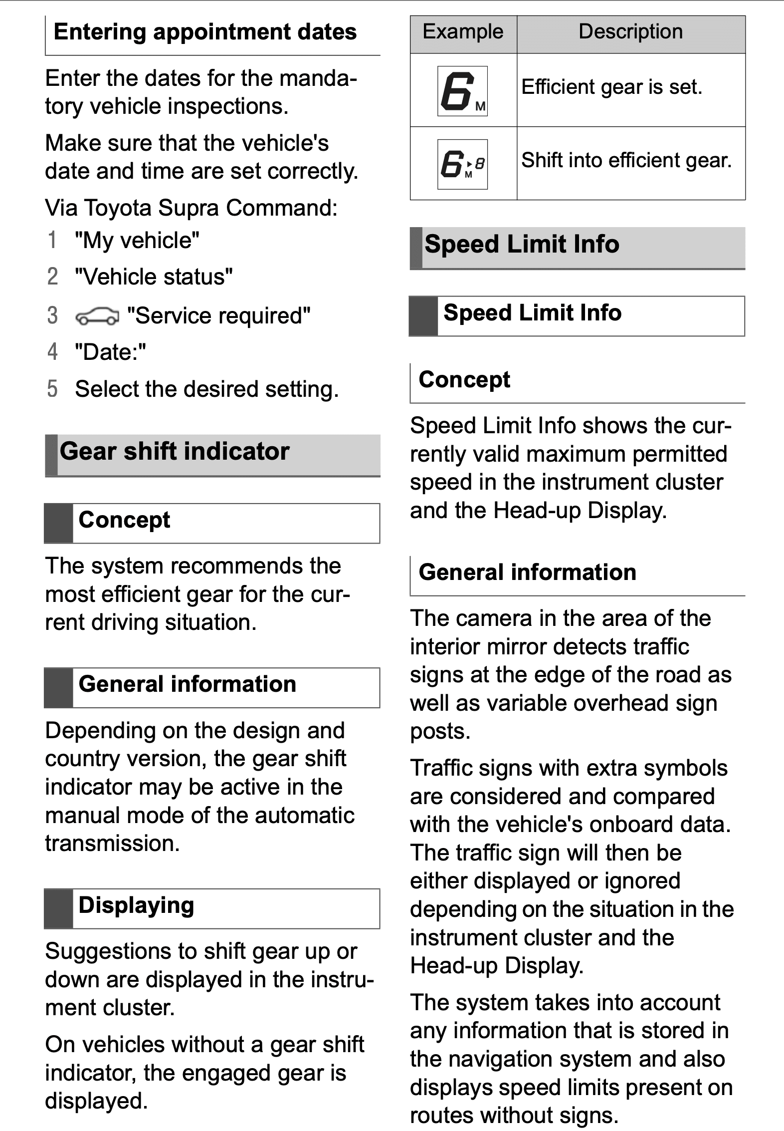

Anyone found a way to code out the the display advising you what gear you should be when in "manual" mode?
i.e. you're in 6th gear and it's telling you to change to 8th. Super annoying and distracting.
What? Never seen this!
SCZ4
Apr 22, 2022
321
136
Texas & Scotland
'20 Supra 3.0 Pro
^ Exactly this. Does it both in sport and normal mode when the gear lever is in manual. Wouldn't mind if it did it in normal mode, but not in sports....

That is definitely not a US car thing. Helpfully you figure it out.
