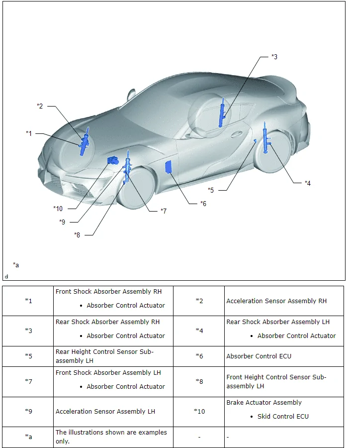

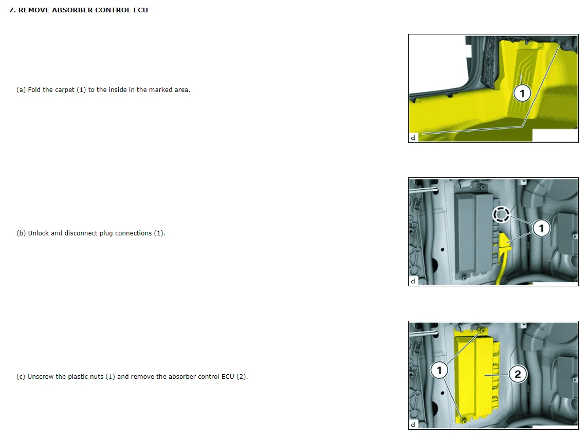

Today I have coded out EDC and TPMS, and Im really happy with that. One thing is left to disconnect the EDC module to get rid of annoying warning. It doesn’t affects anything, now I can turn off traction and it will not turn on automatically, but I want to have a clear dashboard.
So, does anyone knows where is EDC module in the supra? i want to disconnect it
