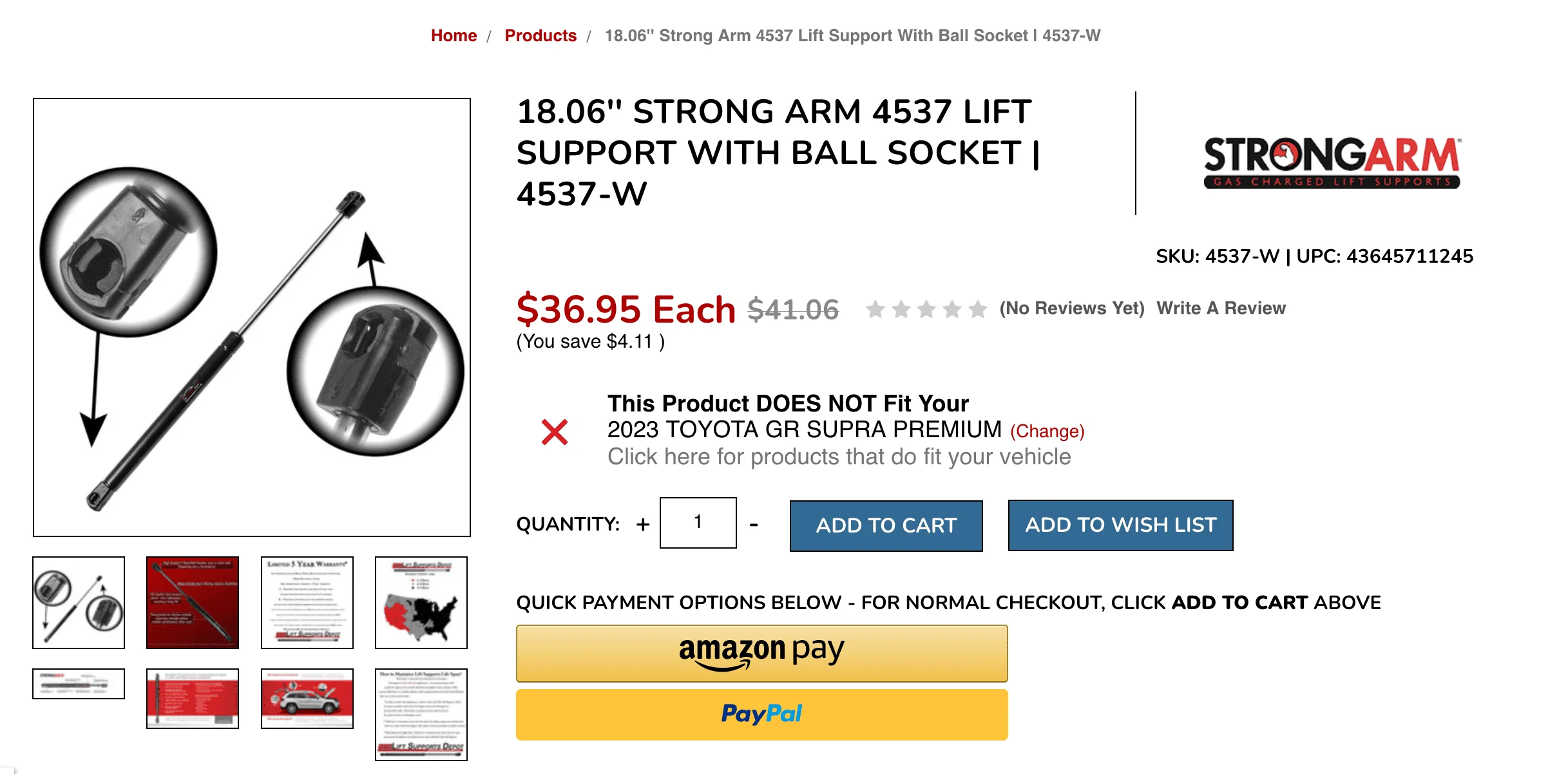

Do you have a link to the ones you used as I also have the Adro wing and there's been a few different links to various hardware in this thread. Cheers.
Also, the ones you quoted seem to not fit according to the site? Help!

Just want to confirm which one works. I’ve seen the 18.03“ one and the 18.3” one and the measurements show 19” or does it matter as long as its around 18”?
You’ll have no problem with those! They’re the exact ones I ordered.
