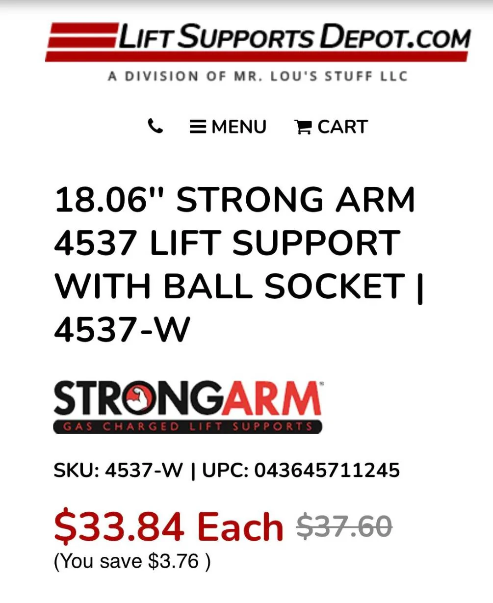

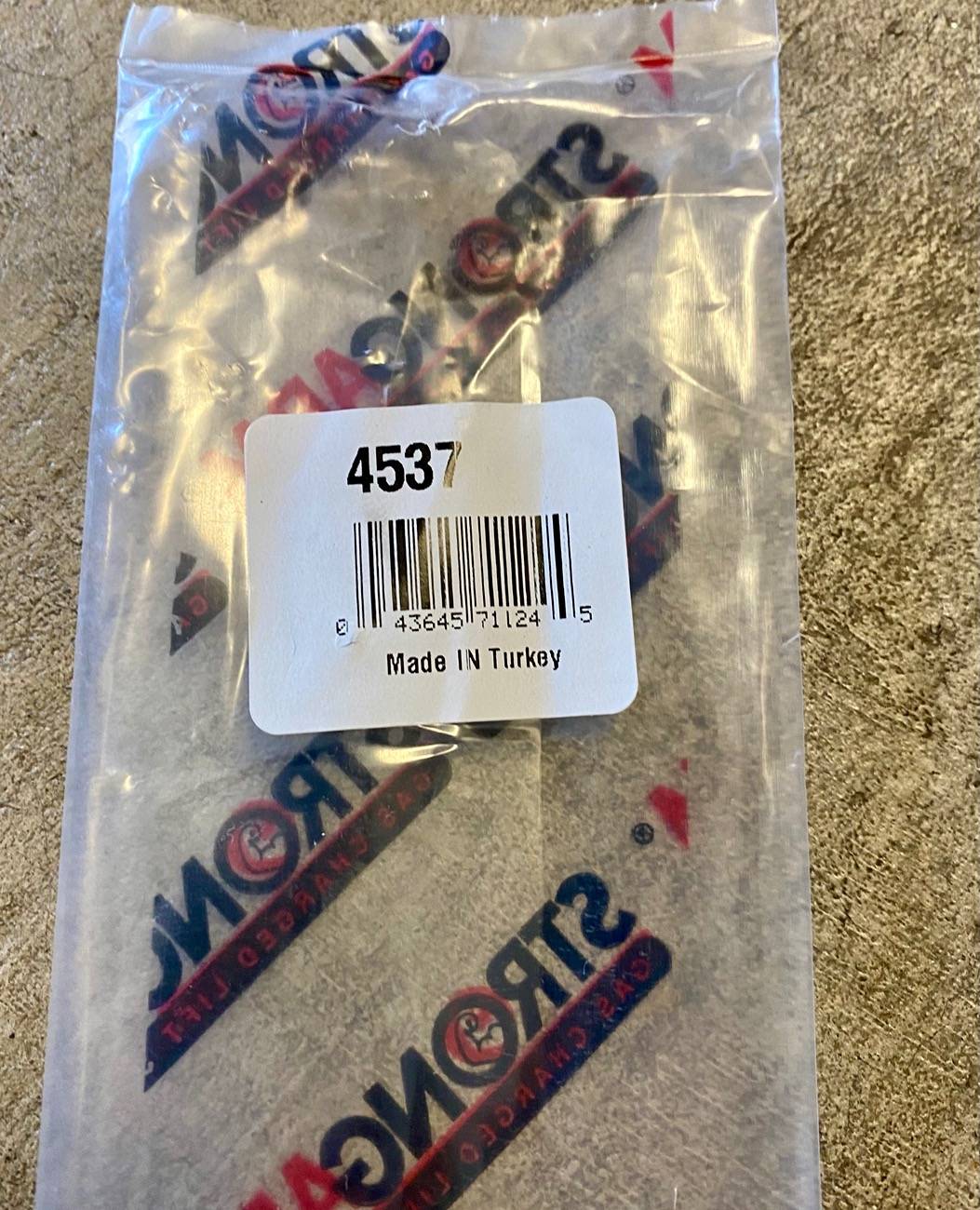

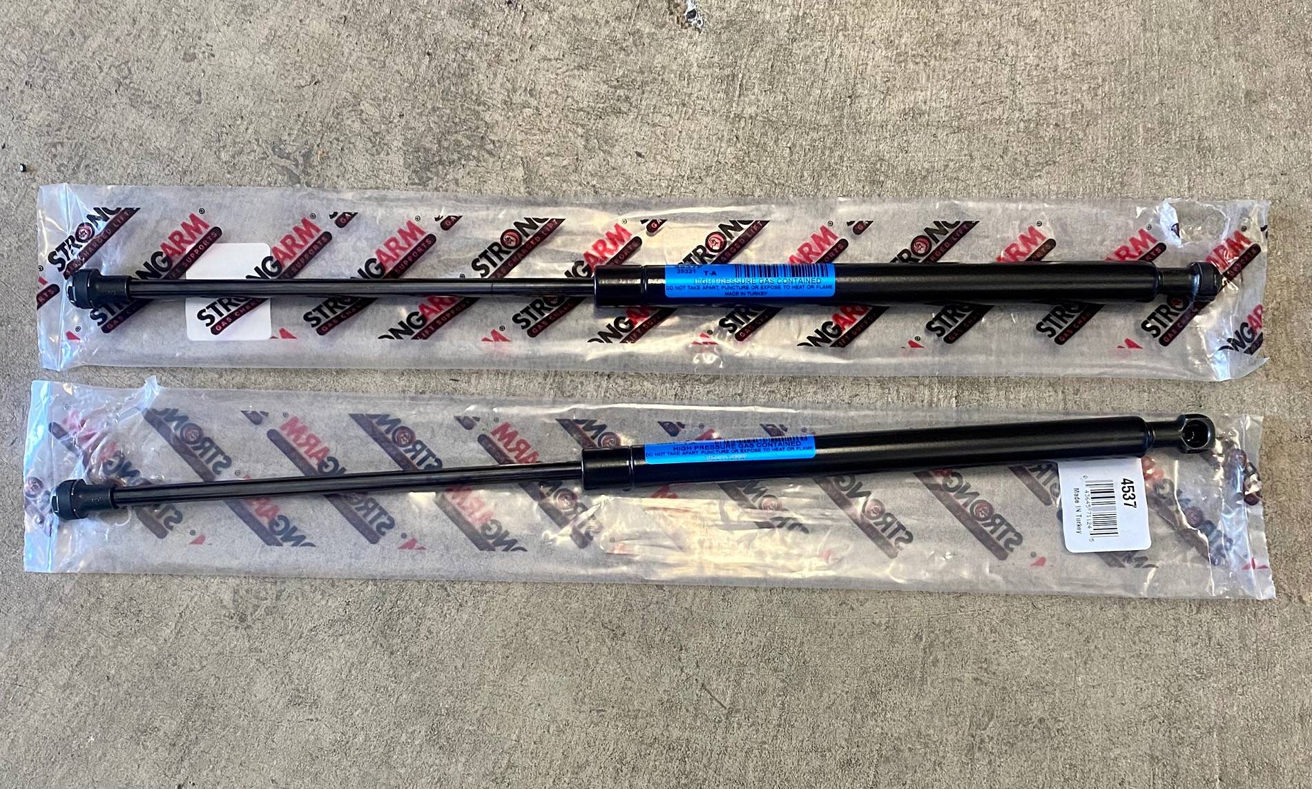

This time I measured the car and it seems the OEM length is around 18.06, this is measured with the tip of the tape measure on TOP of the bottom ball socket, so this isn't a "middle to middle" measurement:
I've ordered 2 of the longer struts (the only 18.06in was 129lbs, 9lbs stronger than the previous) with 116lb force to see if this will help:
https://www.liftsupportsdepot.com/1...-with-compact-10mm-ball-sockets-pm3680n10s-w/
Then I ordered the same 2 springs above, and another posters 90mm red springs, I'll try both and compare:
https://www.amazon.com/dp/B096FMC37...colid=3D6WGNFDMJ56C&ref_=lv_ov_lig_dp_it&th=1
