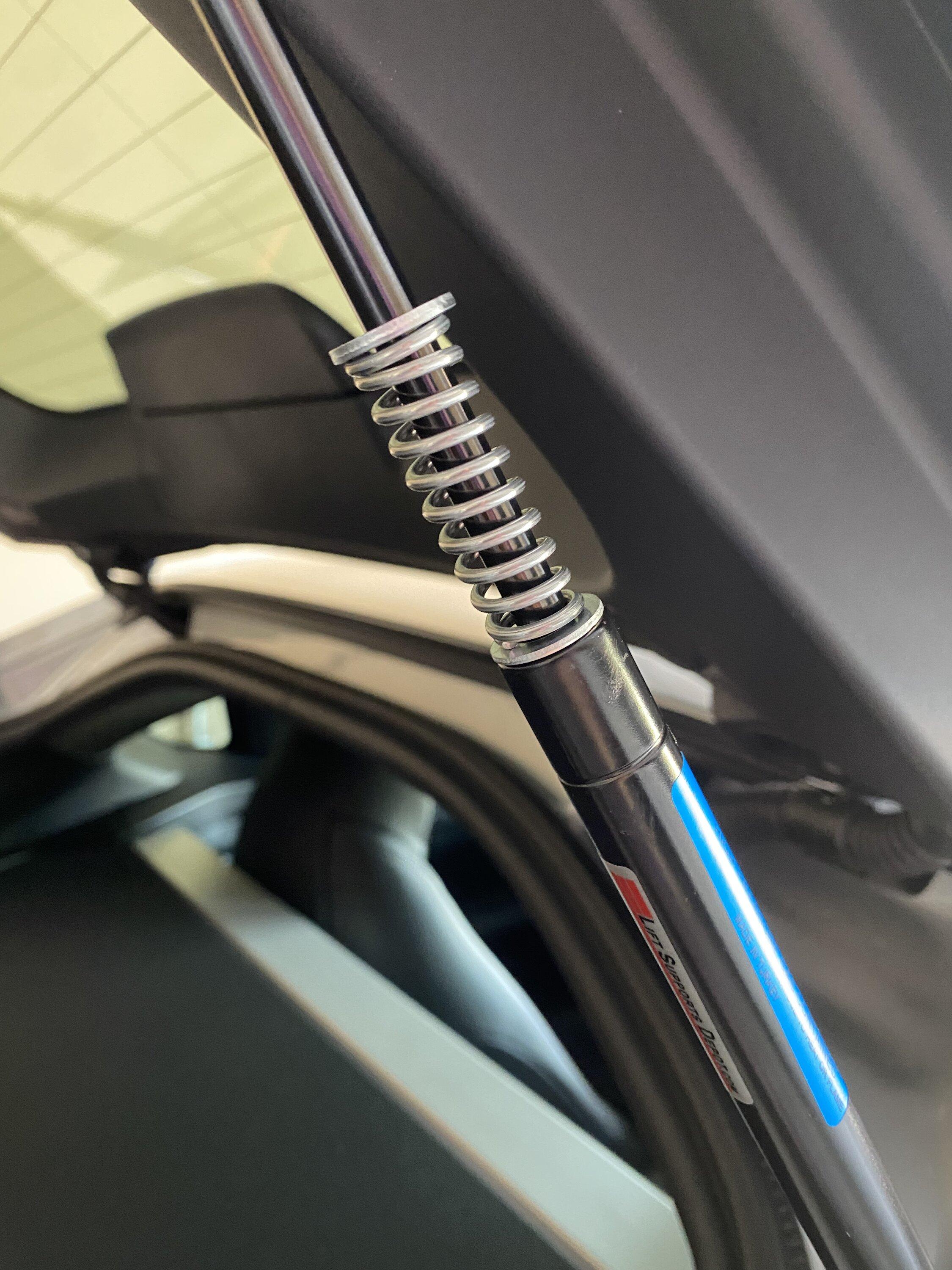

Just installed the 2 blue springs, its are pretty strong. Maybe after awhile it will be better.
DO you have a wing?

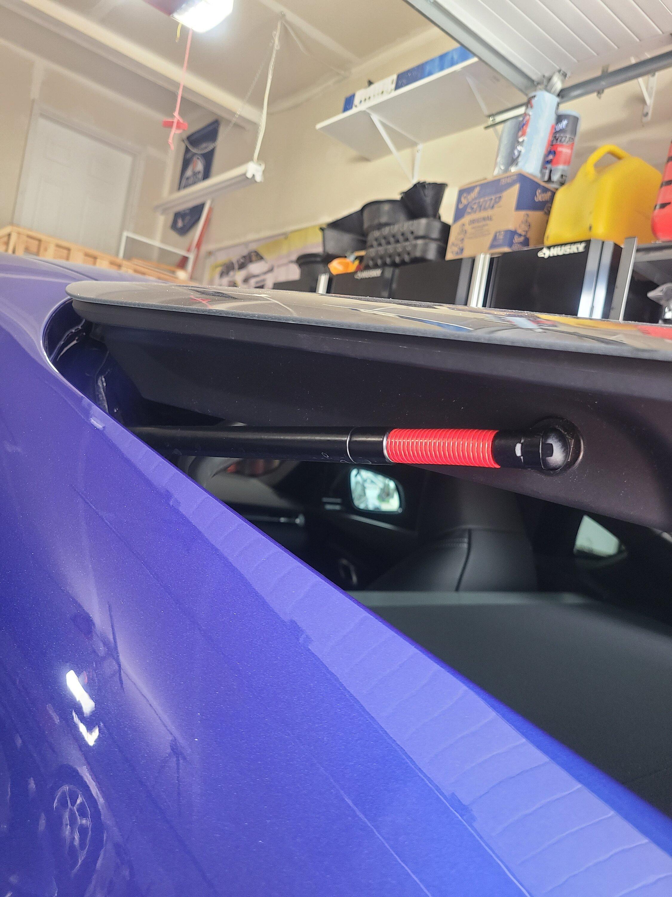

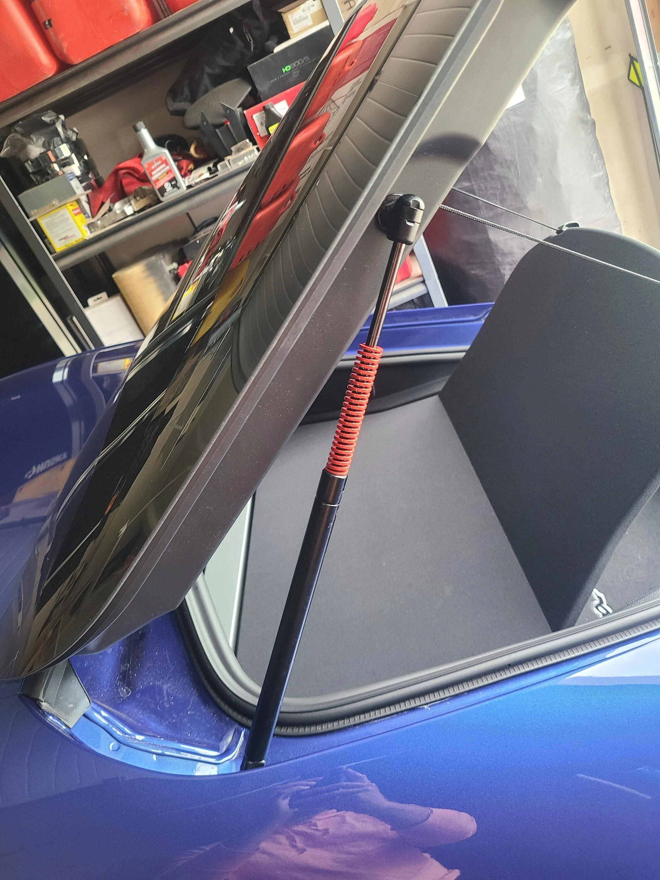

Red springs? It is a harder spring than the blue one, I went this route due to the weight of my spoiler.
Did you adjust the bump stop?

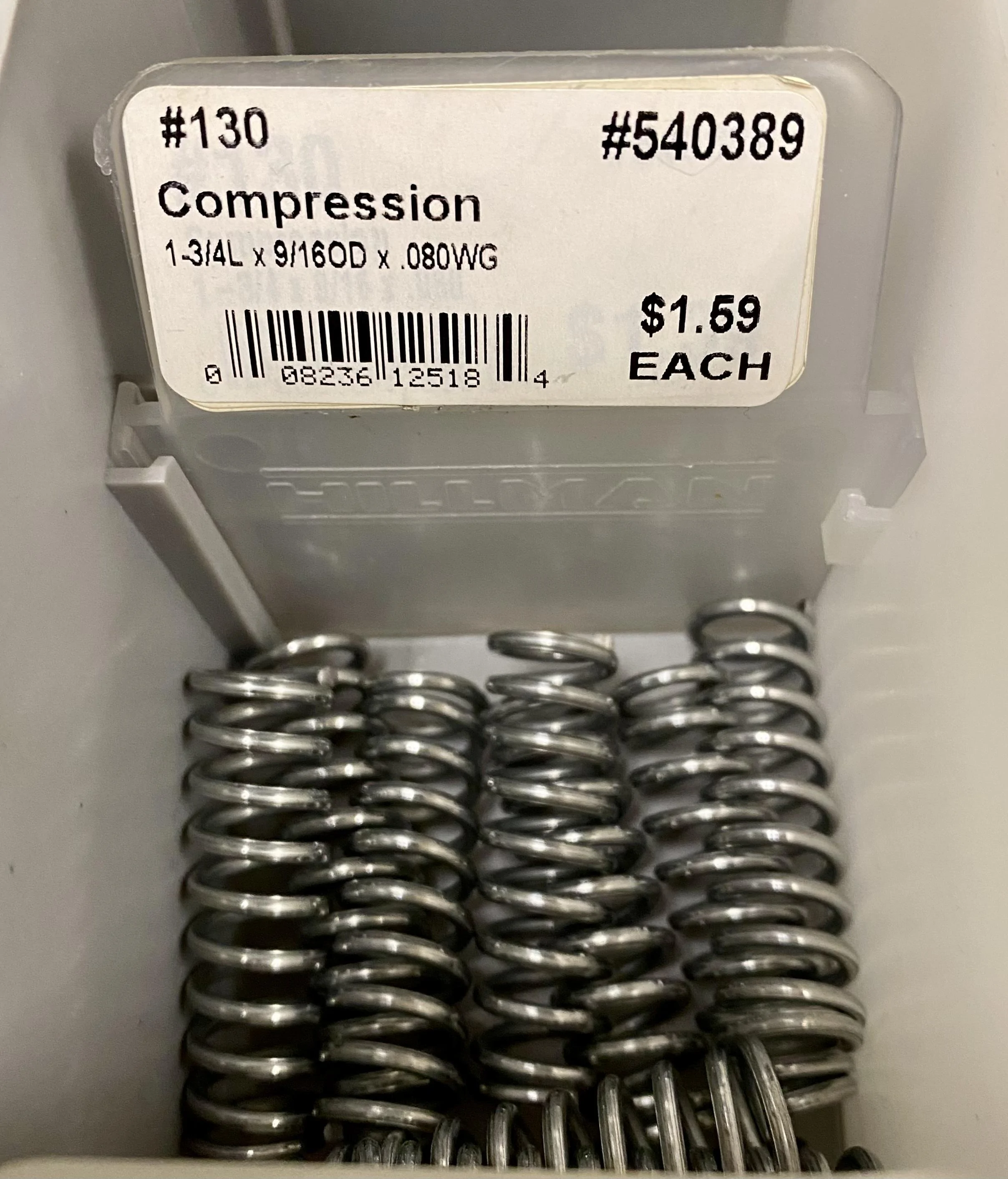

Perfect solution now imo. I went with the shorter springs (one on each side) in the 1 3/4” length. Specs are listed in the image. Super elated with the end result.
Do these rattle at all when you’re driving?

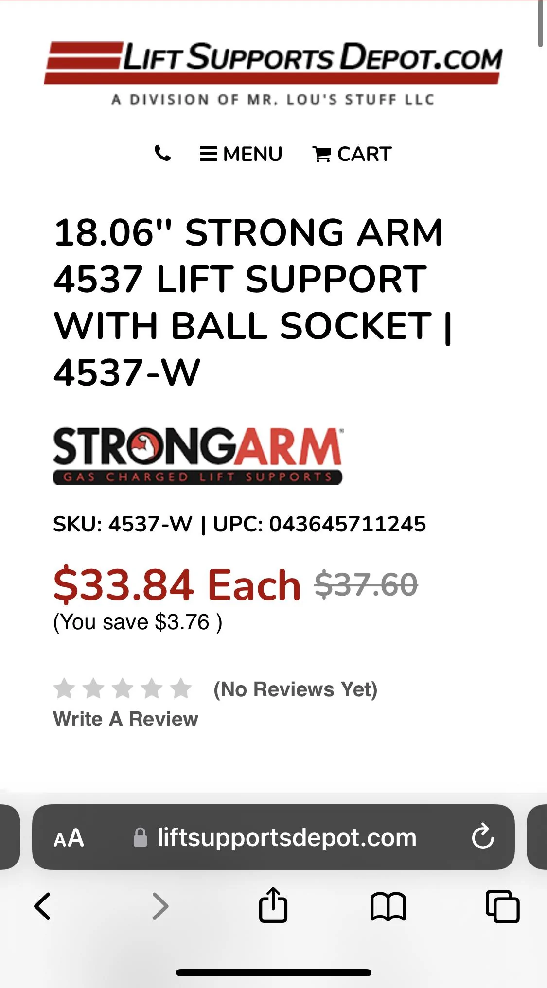

I use these with a Verus wing and it works perfectly to keep the hatch up: https://www.liftsupportsdepot.com/1...10mm-ez-release-ball-sockets-se170p120ez10-w/
