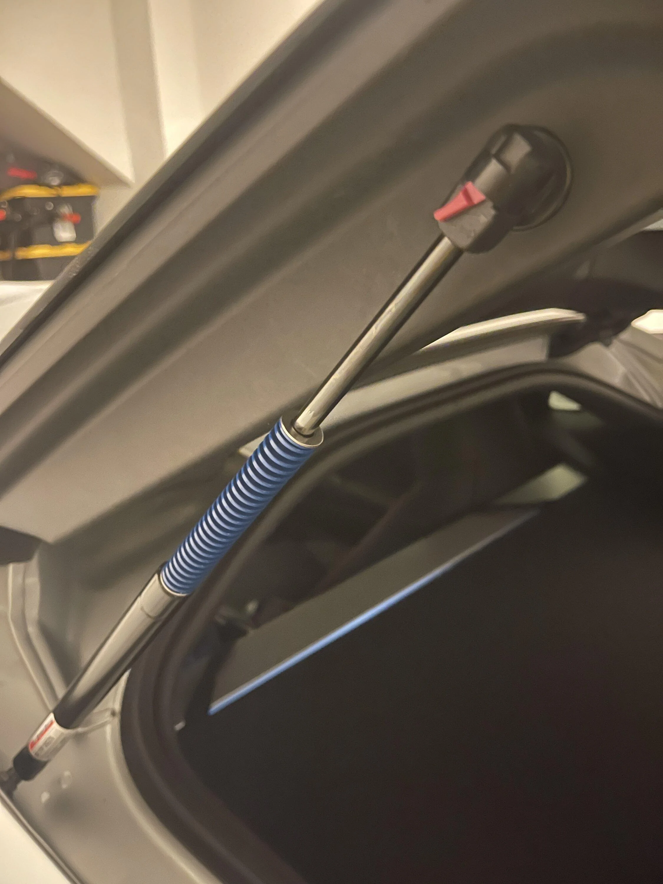

1 3/4 - 2 1/4 is the best length for the helper spring but the strength / compression is the spring is key factor.
The regular spring I bought had the near exact specs as the spring you bought. I’m guessing my strut is different length than yours because even with the trunk near closed, the strut isn’t even close to compressing the spring. In the video, you can see how much length I needed just to get a good compression.
I’m returning the struts for the some similar to BadOne’s. It’s going to be 17” instead of 18”. The ones I previously used were from Amazon.. :fear:
With the shorter length and stronger weight support, I’m assuming the blue die spring should work better alone. Seems 100lbs is strong but not enough to push open alone without a very compressed spring. I’ll play around with the spring setup again once the new struts come in.
Just want the jiggle to stop when fully extended.

Update for y’all. Here are specs of my final solution. The shaking at the end isn't as rough as the video shows. It will pretty much go away once the struts and springs settle in. Specs below:
Struts:
  • Extended Length A [in]: 17.00
  • Stroke C [in]: 6.80
  • Compressed Length B [in]: 10.25
  • Force (Lbs): 120
  • Force Newtons: 534
  • Shaft Connection: Quick Release (Nylon) =10mm=3/8"=.39"
  • Body Connection: Quick Release (Nylon) =10mm=3/8"=.39"
  • Rod Diameter (MM): 8
  • Cylinder Diameter (MM): 18
Spring (Qty. 2):
Spring (Qty. 4):
  • Length 50mm
  • Inner Diameter 8mm
  • Outer Diameter 16mm

When you initially install, like my video, it seems a bit forceful/jerky. It’s because the strut and spring are new and haven’t settled. (The trunk has a long range of motion, which allows for additional vertical movement, so the jiggling/vibrating you see in the video isn’t really harming anything.)
After some time, it won’t be like that anymore. I opened the trunk earlier at dinner to show a friend and it opened just fine.
My earlier experiment with different springs ended up not opening the trunk anymore after settling in. That’s why I opted for a more robust spring (die spring) and a stronger strut.
Overall, I’m pretty satisfied with the Lift Depot struts.
