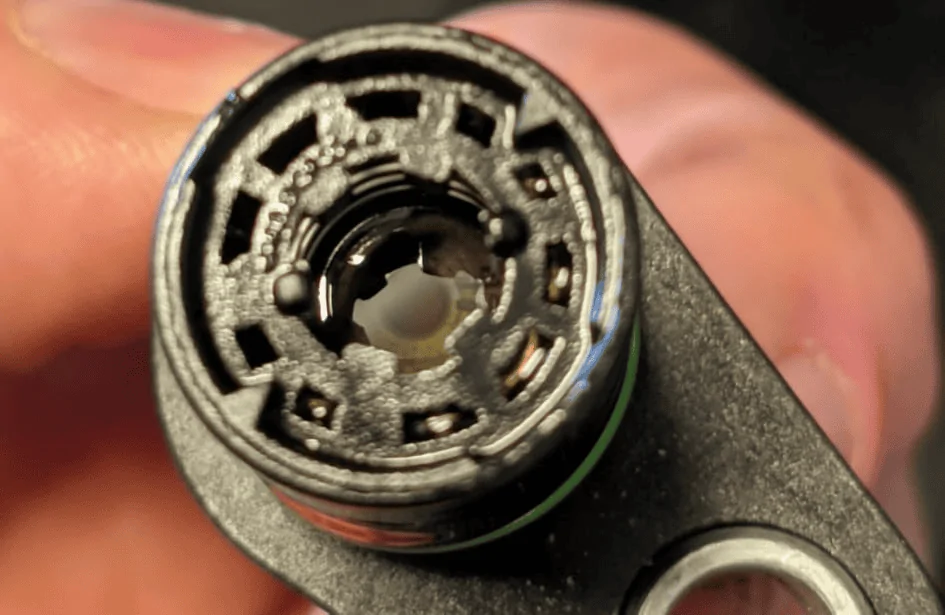

I haven't driven enough miles to answer this question directly. But what I can say is that both the PCV and CCV lines had oil contamination in them when they were removed to install the catch cans.
Here is a picture of oil in the PCV line. The CCV line had similar oil contamination. Both lines connect to the turbo inlet adapter that's attached to the front of the turbo (black plastic).
I found disgusting oil residue spattered all over the inlet pipe, and I'm only at 3000 miles.
