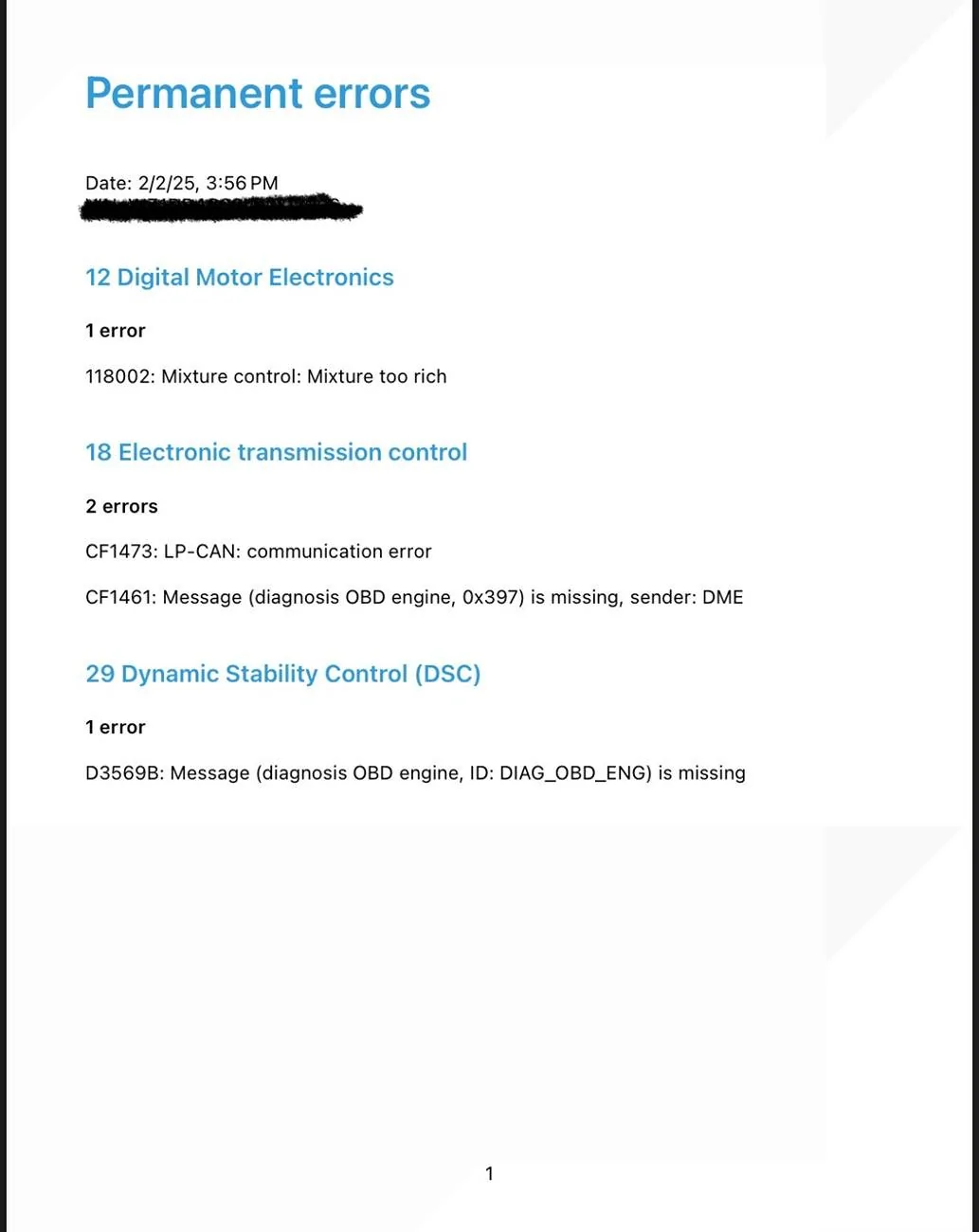

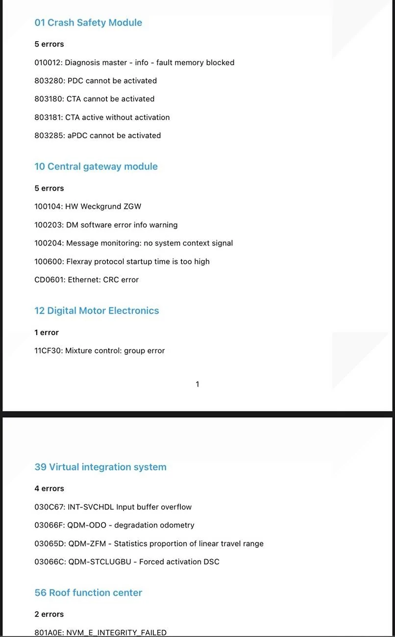

I haven’t thought about it like that but have definitely been wondering what sensor it could be. I just scanned it with BimmerLink and didn’t get anything that I didn’t already know. I did see that cylinder 1 is still misfiring more than the rest even after moving that spark plug and coil to other cylinders.
