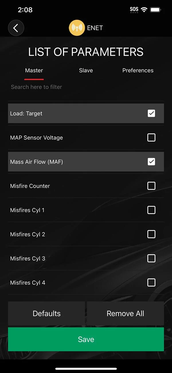

Ill try to get those custom log parameters for the misfire counter to you before you get the car back out. Hopefully before the weekend is out. So we can try to narrow down the cylinder.

I apparently missed some of the posts on this thread. My gap on my spark plugs is also .022, but could adjust them to .030. I did the misfire counter via the and misfire on each cylinder via the MGFlasher app and as you can see it's misfiring on several cylinders. This was just at idle for about 20-30 seconds. So I no longer believe this is an injector issue and maybe is as simple as cleaning a sensor (O2 or MAF) or plug gap issue.
