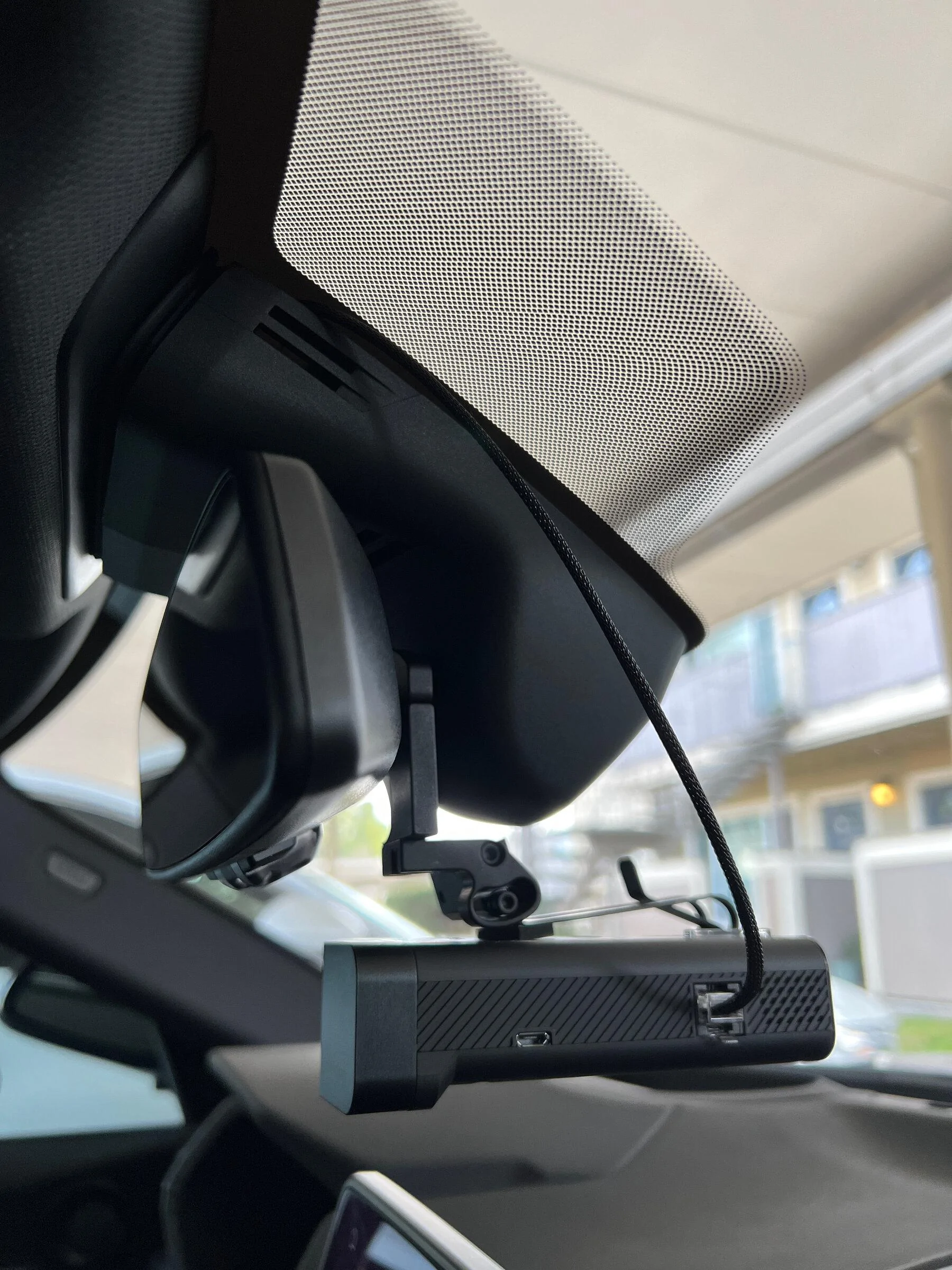

I did that for my dash cam as well since my parking mode battery pack is in the glove box.

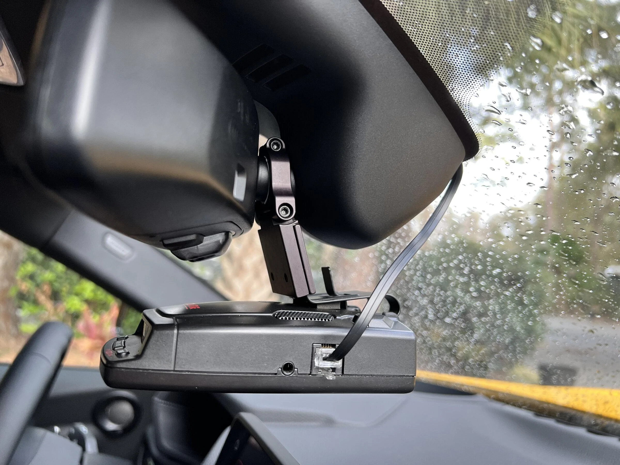

Here's a photo of my final install. The only thing is, the two suggested wires for the rain sensor control, do not shut off, so my radar detector is on all of the time. In time I will try and pin out the mirror wires to see if there is power that is only on when the ignition is on, unless anyone has figured it out already.

Did you figure out which wires to tap so radar is not on all the time, only with ignition?
Karttrackowner
Tony
Feb 13, 2022
LaFayette, NY
2022 Supra 3.0 Premium, 2006 Porsche Boxster
Actually it turned out that it turns off after a while on its own, not sure how long, but I know when I come back to my car, it’s off and as soon as I unlock or open the door, it comes back to life.
