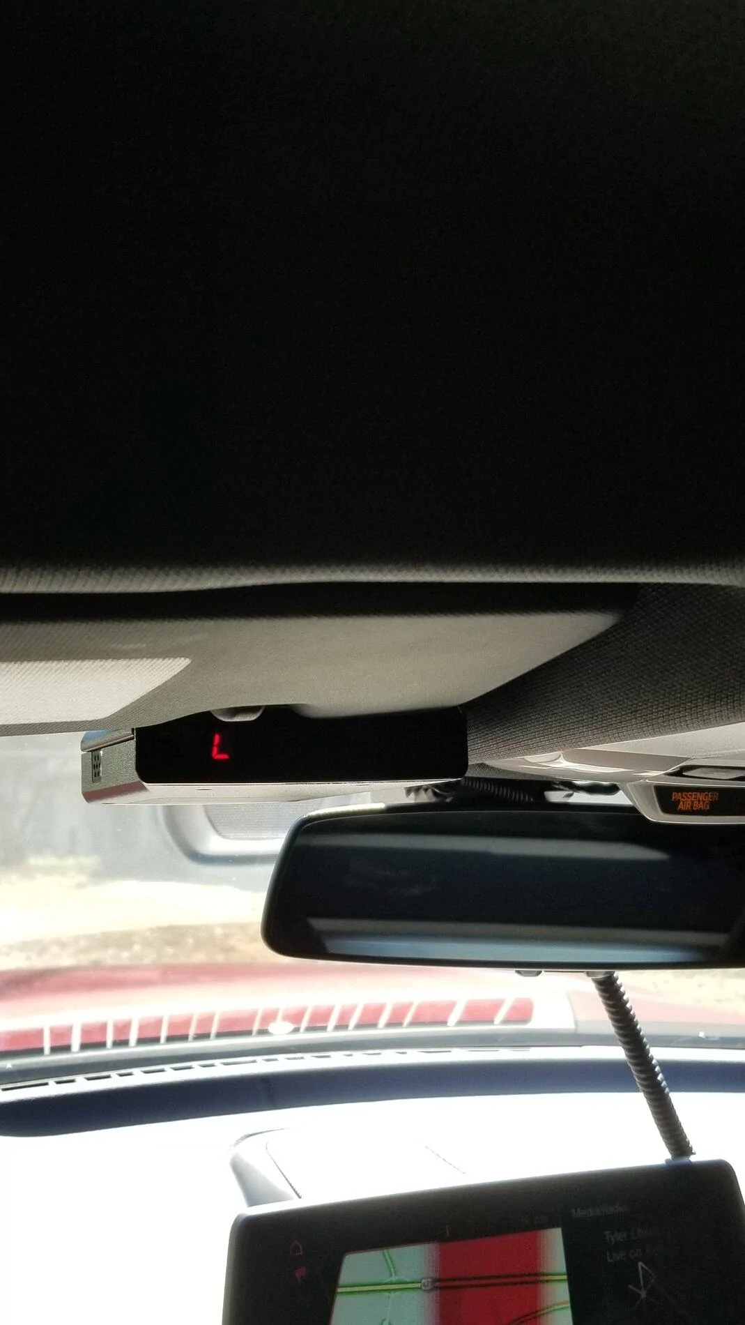

Not the greatest picture, but anybody that wants a inconspicuous place to mount your detector, the visor mount that comes with the Valentine v1 gen 2 will clip to the headliner and leaves enough room for the visor to still flip down and hide it. Also feel fairly confident that it's well in line with the rear window. After driving a while and getting some hits, I'll report back.
Don't mind the cord hanging down. My previous mirror tap from my last car is too fat for the Supra, so ordering another one.
EDIT:
Made a youtube channel and posted a video of my install. Reconfirming that the large harness going to the mirror works. Brown is negative, and red/blue is positive. Takes about 6 minutes to turn off after the car turns off.
Wow, very discreet and clean. Keep us updated on the performance or if they're any ways to test and log the signals from that location.
EDIT:
Hey bud. Now that you've run this puppy for a bit, how is it doing for picking up rear radar in that location? I'm about to follow your lead as my v2 arrived this weekend. Thanks.

I can confirm that mounting a valentine v1 gen 2 on the headliner by the mirror via a visor mount will pick up radar from all directions. Looks super clean and well hidden.
