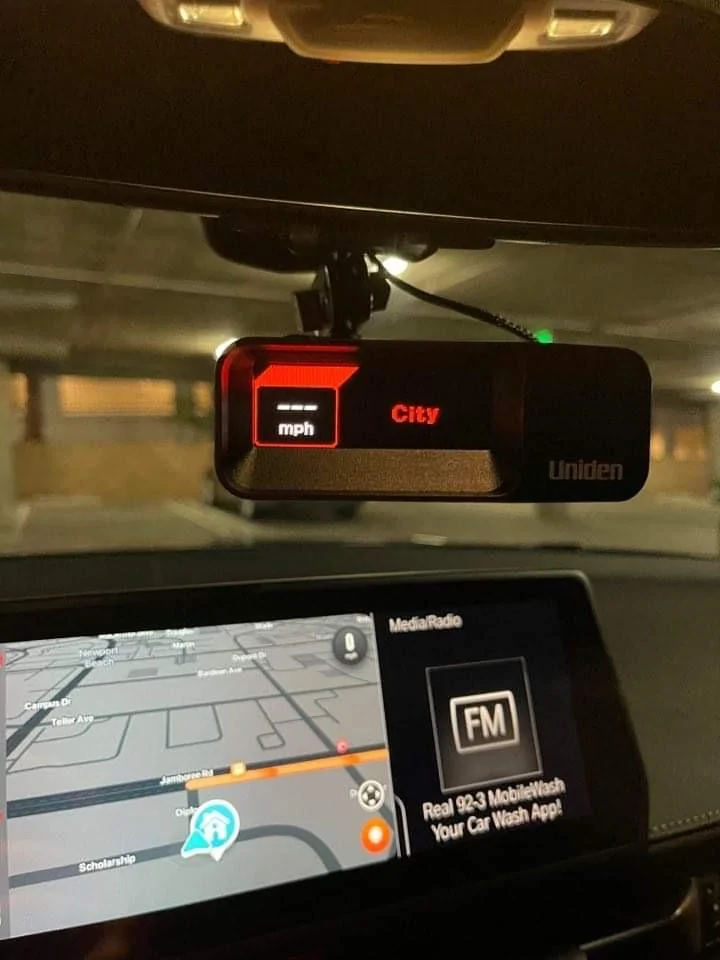

I just installed my Uniden R3 with an RJ11 mirror tap from Amazon.
First I tried the pink connector, which worked, but the unit was on even after the car was locked for over 30 minutes.
Then I tried tapping into the black connector beneath it and it works like a charm now! After 6 minutes, both the 12V outlet on the center console and the R3 power off. :thumbsup:

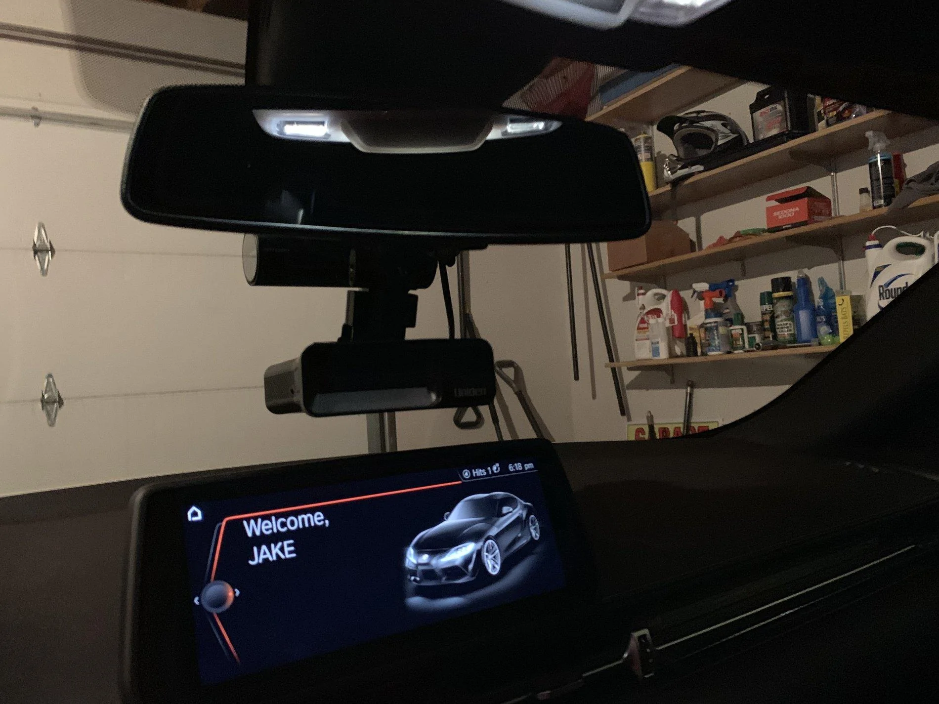

Got my Mirror tap delivered last night and put it in this morning. It wasn't horrible at all getting the taps in. Now the getting the black connector out was a different story. Fixed the escort dash cam to sit more level and straight as well.
How I would rate my install experience.
Removing plastic shroud: 2/5
Removing connector: 4/5
Installing mirror tap: 2/5
Overall very satisfied.
Looks good!

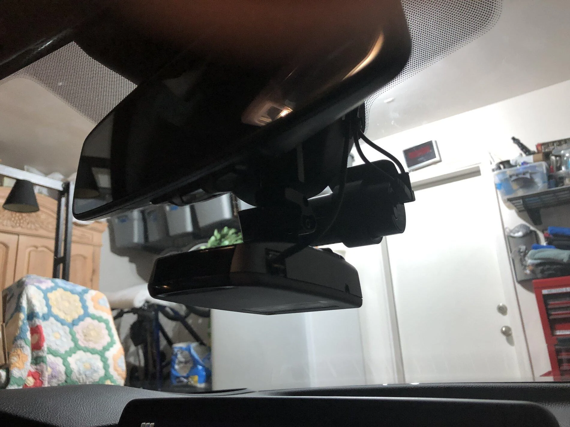

Not the greatest picture, but anybody that wants a inconspicuous place to mount your detector, the visor mount that comes with the Valentine v1 gen 2 will clip to the headliner and leaves enough room for the visor to still flip down and hide it. Also feel fairly confident that it's well in line with the rear window. After driving a while and getting some hits, I'll report back.
Don't mind the cord hanging down. My previous mirror tap from my last car is too fat for the Supra, so ordering another one.
EDIT:
Made a youtube channel and posted a video of my install. Reconfirming that the large harness going to the mirror works. Brown is negative, and red/blue is positive. Takes about 6 minutes to turn off after the car turns off.

That low mount does look good, and will certainly help hide it. My only concern would be the lack of rear view pickup.
