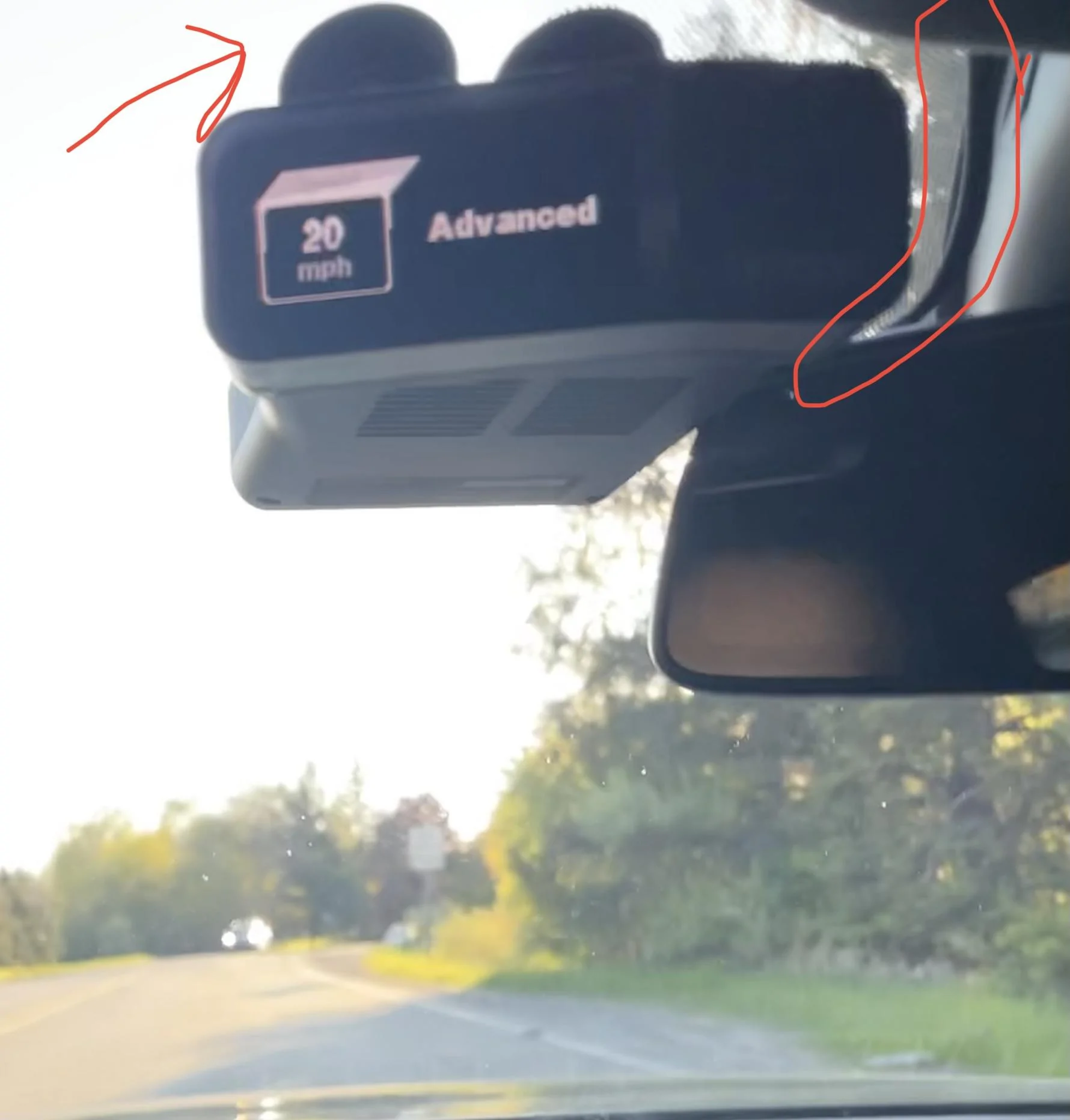

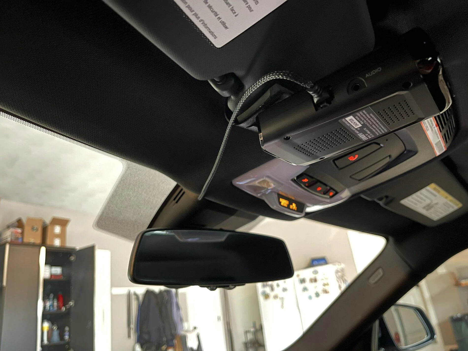

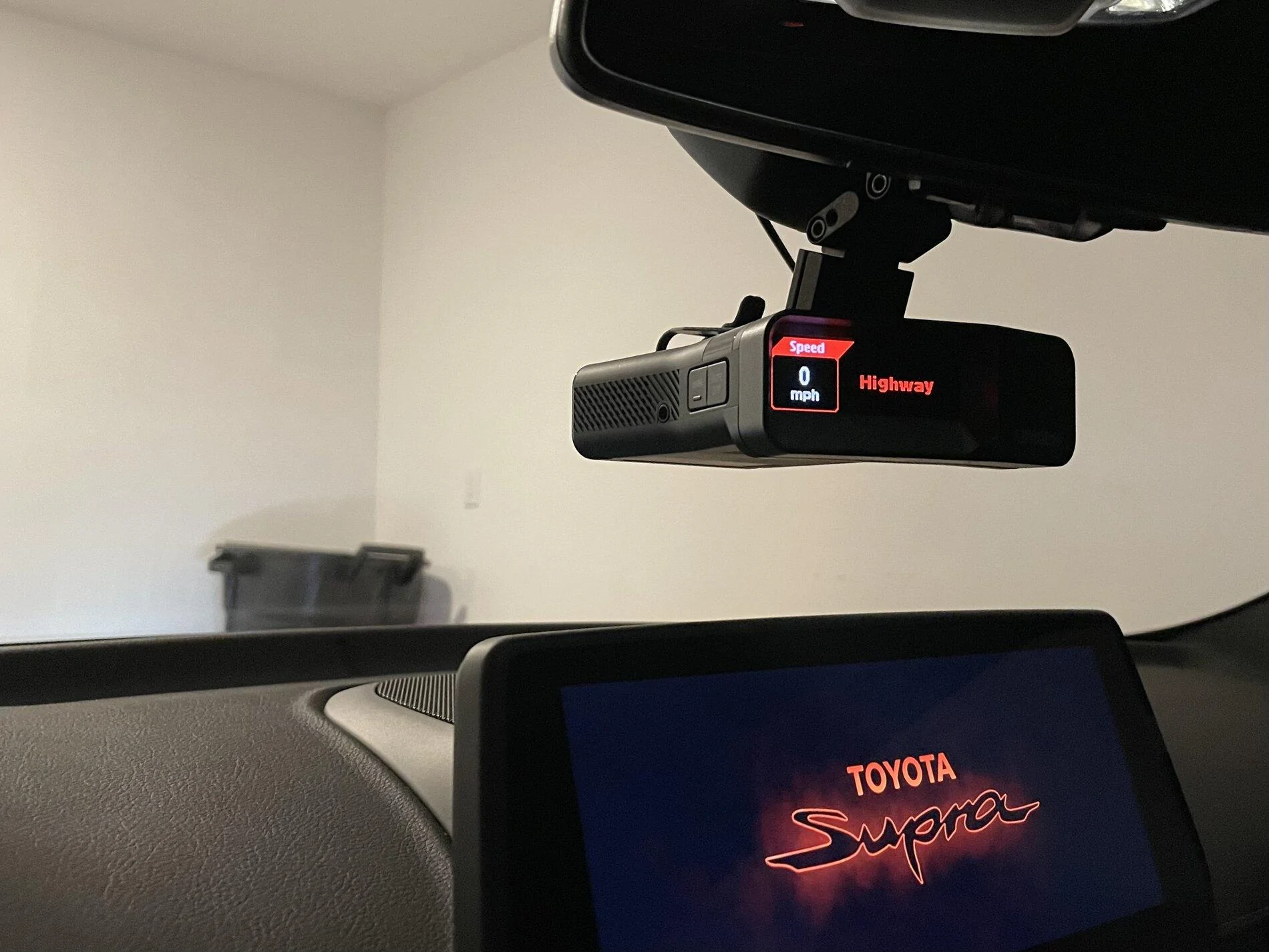

Blendmount +MirrorTap kit MTX-1015. Some might not like how low it hangs. I think I can remove part of the mount to tuck it up but I haven’t bothered.

Newest blend mount mounts from side and leaves out the extra link by default. Hangs beautifully tucked under mirror.

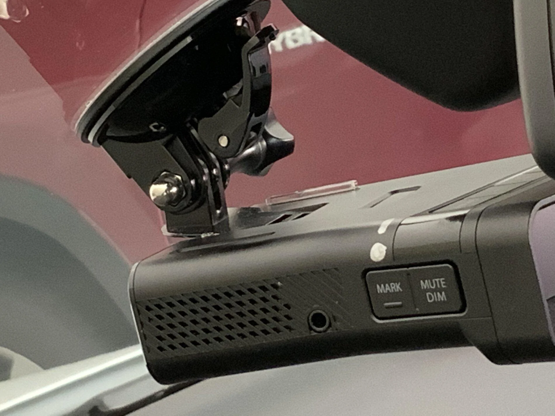

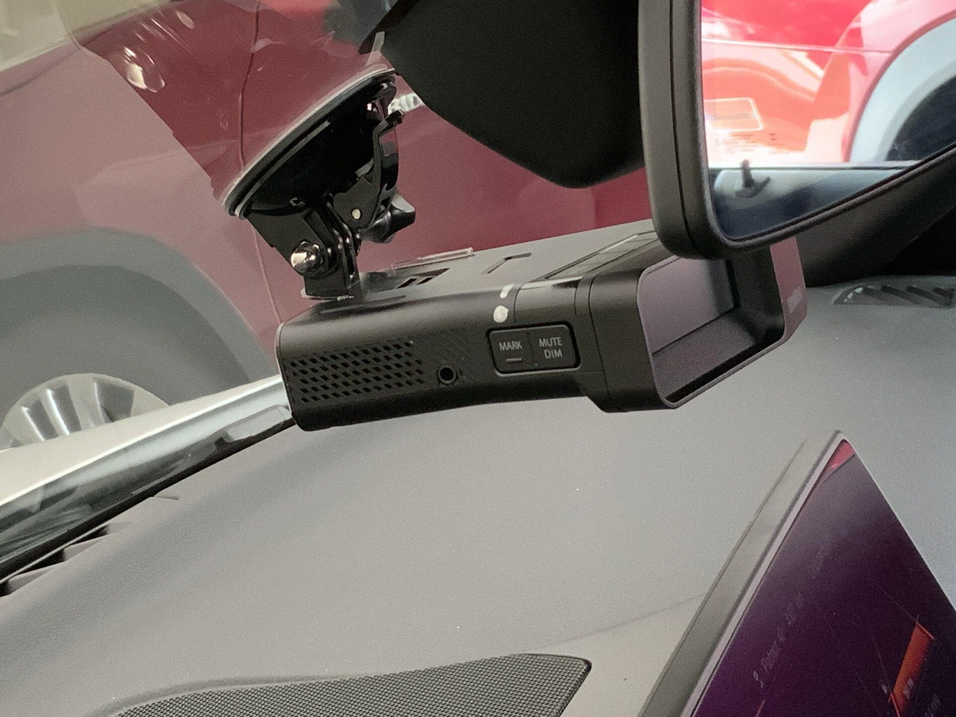

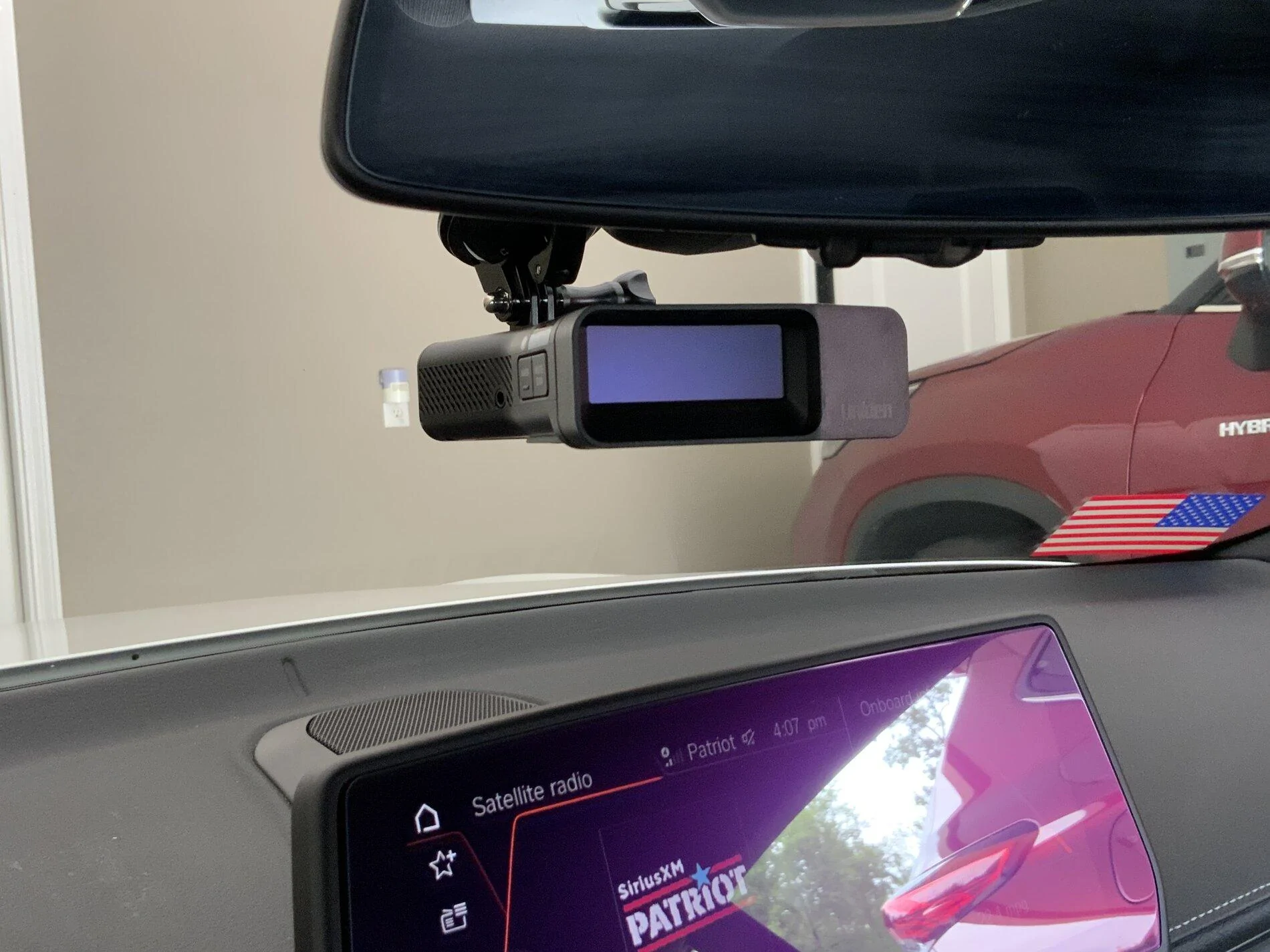

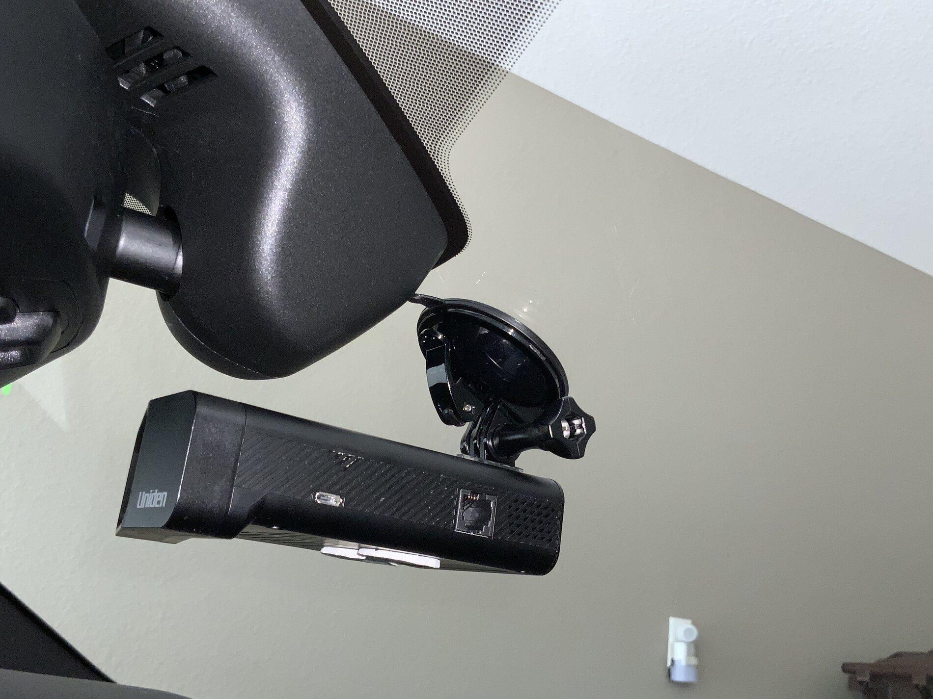

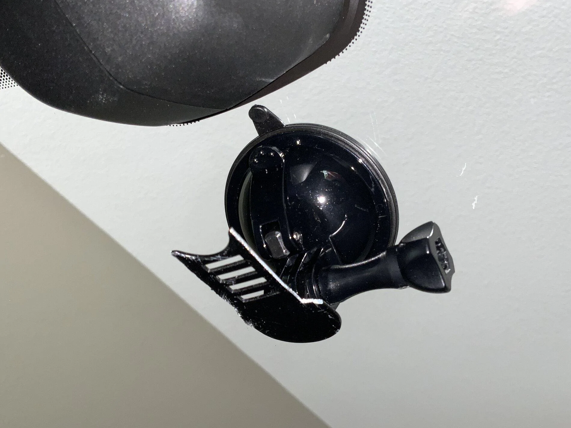

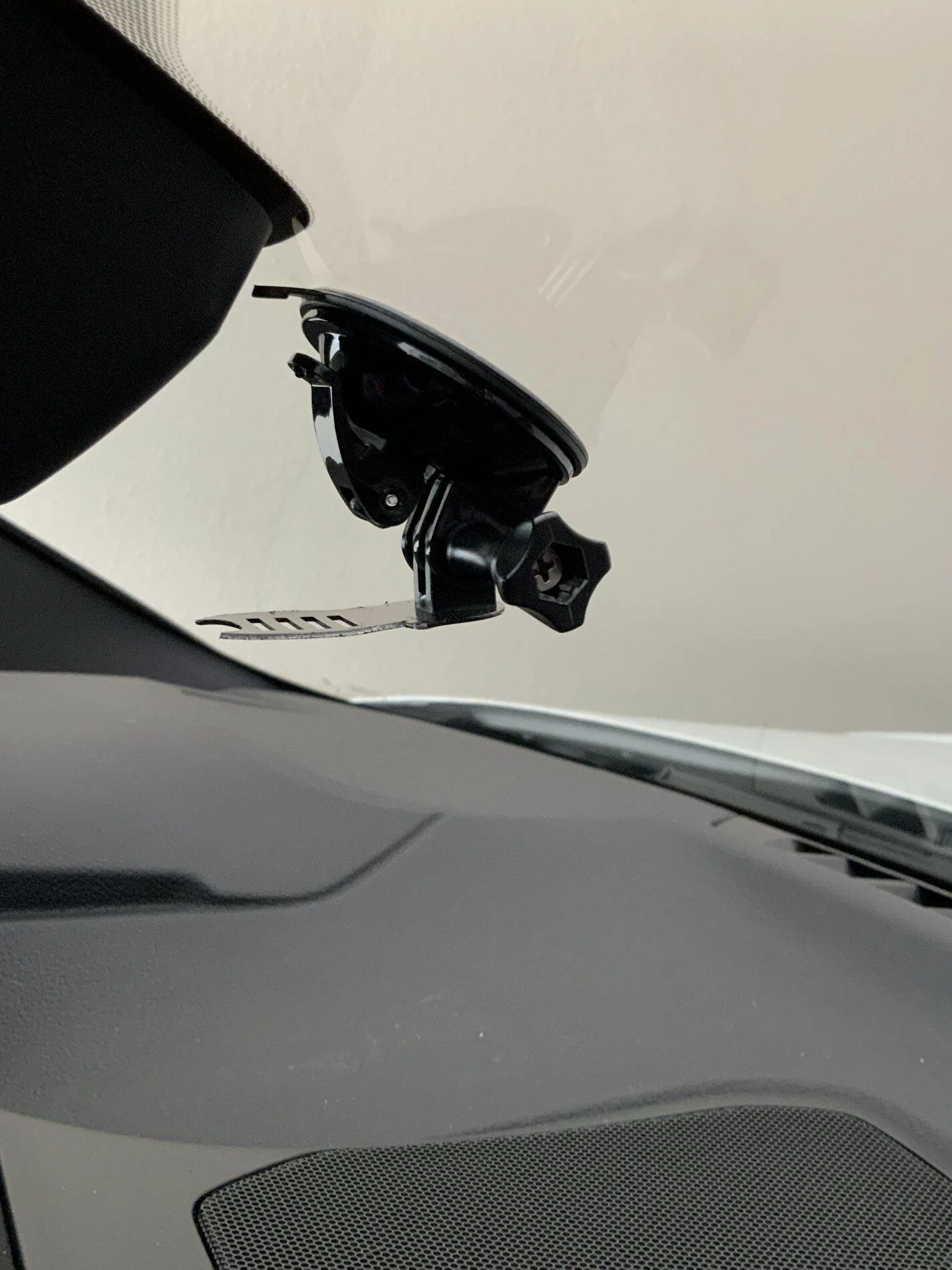

I bought a $16 suction cup windshield mount on Amazon knowing it wouldn’t fit the R7. I took one of those “penny cutting” scissors and trimmed off the sides of the metal tongue and voila. A $16 Mount for my R7.
Minimal vibration, no more than any $99 system I have to imagine. The suction cup also has adhesive and is sticky as hell. Others who’ve complained about this mount’s adherence may be taking it off and remounting it repeatedly but I mounted it once and haven’t moved it. It is very solid even in heat and humidity.
