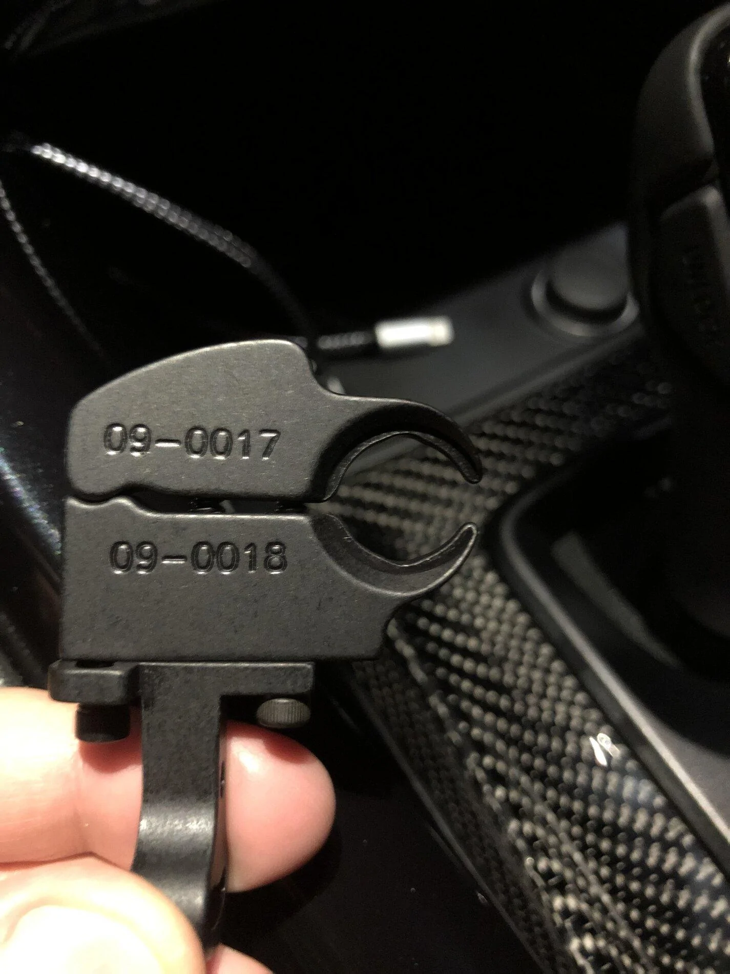

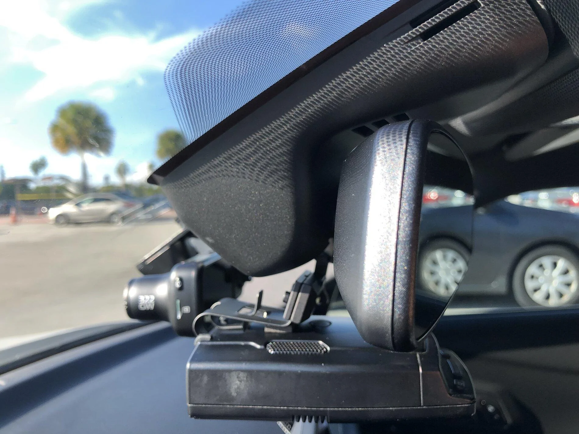

Ahhh this is confusing me even more, I think someone posted that one and said that the stalk was too small and needed to be sized up lol. Guess I’ll take a chance, thanks!
hi I went ahead and purchased this one. The mount on the bottom meant for a escort redline. The top two pieces are the same.
Unfortunately, yes the space for the mount on the mirror stalk i not long enough. So… you have to modify it to make it work.
Advantages, the mount is thin on the stalk, so it allows for more movement of the rear view mirror as intended.
