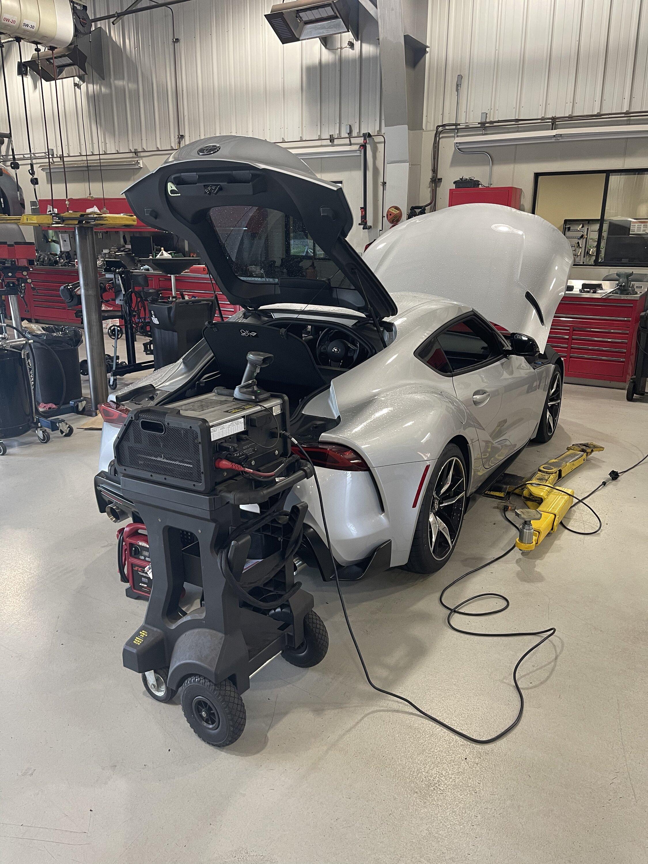

Hey guys, my battery is dead so I jumped it and now when I drive it the dash either flickers or just goes black! Also a bunch of warning lights, anyone have this issue?

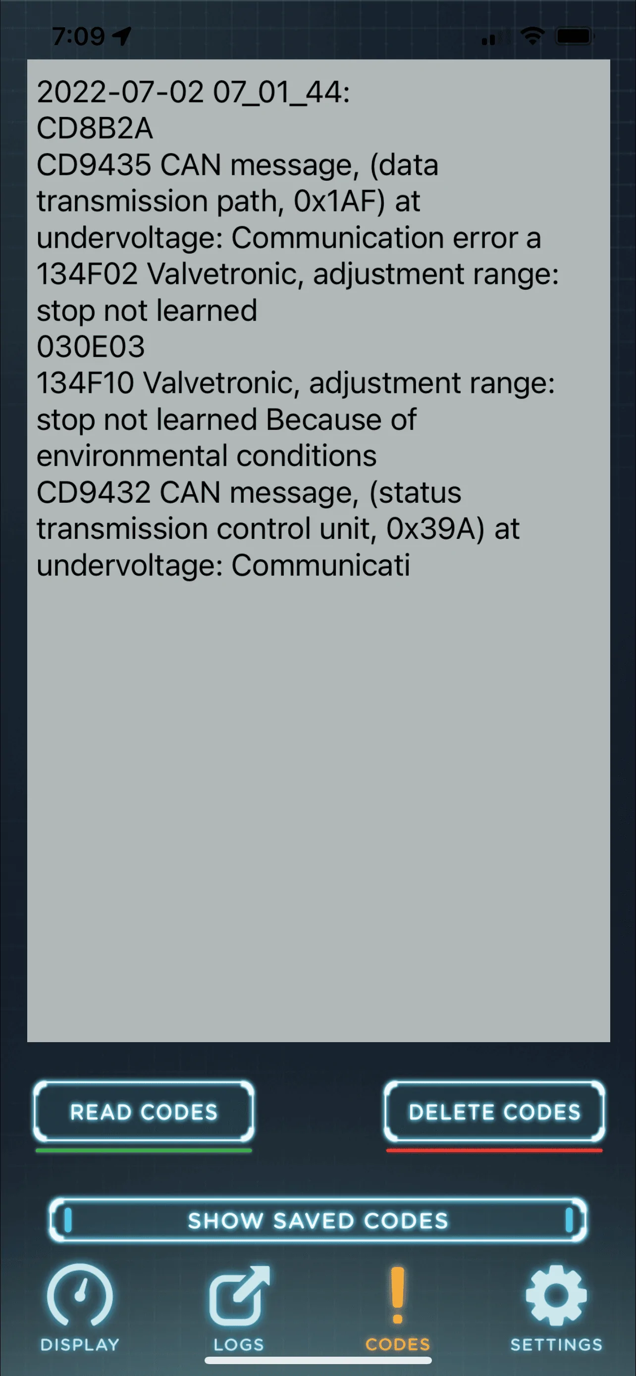

This is what JB4 saw, obviously everything is related to the dead battery, hopefully it didn’t screw anything up…

It is, but I was told it take a special battery charger? It’s at the dealership, they’re going to charge it and clear the codes…
