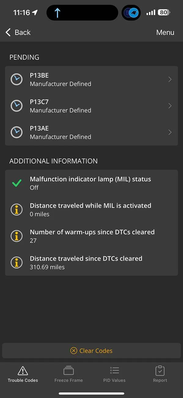

This morning took the car out for a long drive. In sport mode like I usually drive it About 15 miles in I got the Drivetrain Warning Message. Pulled over about 20 miles later at a service area and scanned the car.
P13BE
P13C7
P13AL
Cleared the code and drove the rest of the way in normal. No issues. About 5 miles from my destination. (Now about 80 miles later) At a red light I flipped to sport mode and within a couple of minutes the warning came back.

Well, for starters, I believe the first code is referring to a bad connection or short at your bank 2 knock sensor. So, I'd check there.

Issue came back after clearing. 2 of the 3 codes remain.
P13BE and P13AE
Did some digging and found this
https://g87.bimmerpost.com/forums/showthread.php?t=2024033
Seems to fit issue description, manufacturer date etc. Of course it’s in a nearly impossible place to reach without removing the intake manifold. All for a $30 sensor. Oh well.
I’ll make an appointment to bring it in on my next day off.

Just wanted to circle back to close this thread. While others had success clearing the code and just driving the car to resolve the issue, basicallly chalking it up to a low battery charge, I was not as fortunate. I didn’t think it would be my case since the car is usually always on a tender whenever I don’t drive it.
I replaced both knock sensors with oem parts for about $65. Wasn’t too difficult. Just tedious. Just watch a few videos on replacing the intake manifold to understand what’s involved. Drove the car for a little over 100 miles and so far no issues.
Production dates on the old sensors were 11/02/22. New replacement sensors were 9/19/23.
