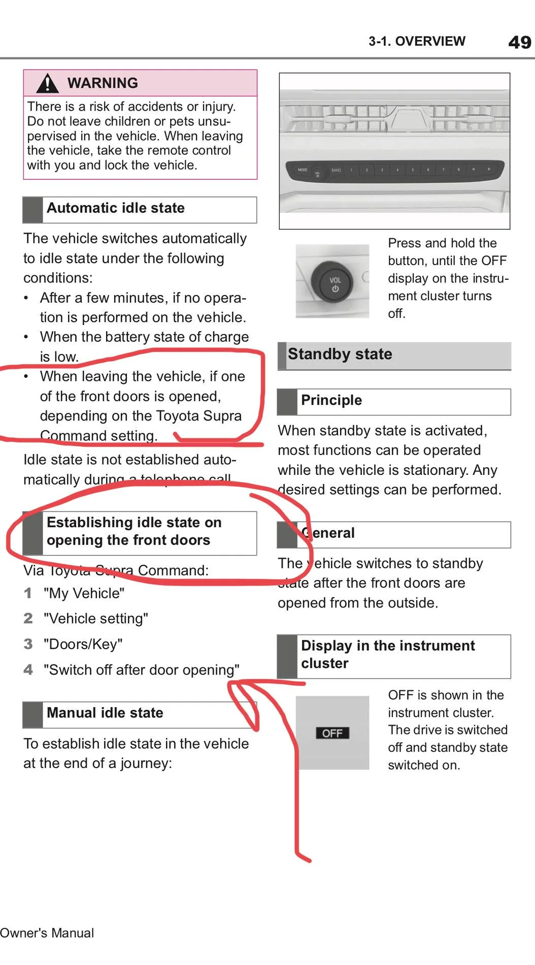

I’ve been reading the manual. Is it possible that the car has been left accidentally in standby state instead of idle state? Also, it appears that the 12v plug is always drawing power and can drain the battery if an accessory/device is left plugged in.

It’s interesting that this car is more like a PC than a car with regard to power. It has multiple modes and it doesn’t behave like other cars with a start/stop button.
As others have said in threads here, to make sure you get to idle mode (off):
-engage the parking brake -AFTER- switching the engine off with the start/stop button
Or
-hold the power button for the stereo after the engine is off.
Or
-there’s also a menu setting that will establish idle state when a door is opened.
This seems kludgy to me, I wonder what struggles led to such peculiar extra steps.

There may be a setting in iDrive to power everything off when the driver's door is opened (after shutting off engine). My M40i has a few ways to do this, but I set it to power off as soon as I open the door. My other BMWs did not have that setting and would only power down when the door was locked or the keyfob went out of range.

Yes.
I mentioned it in my earlier post but here’s the excerpt from the manual.
