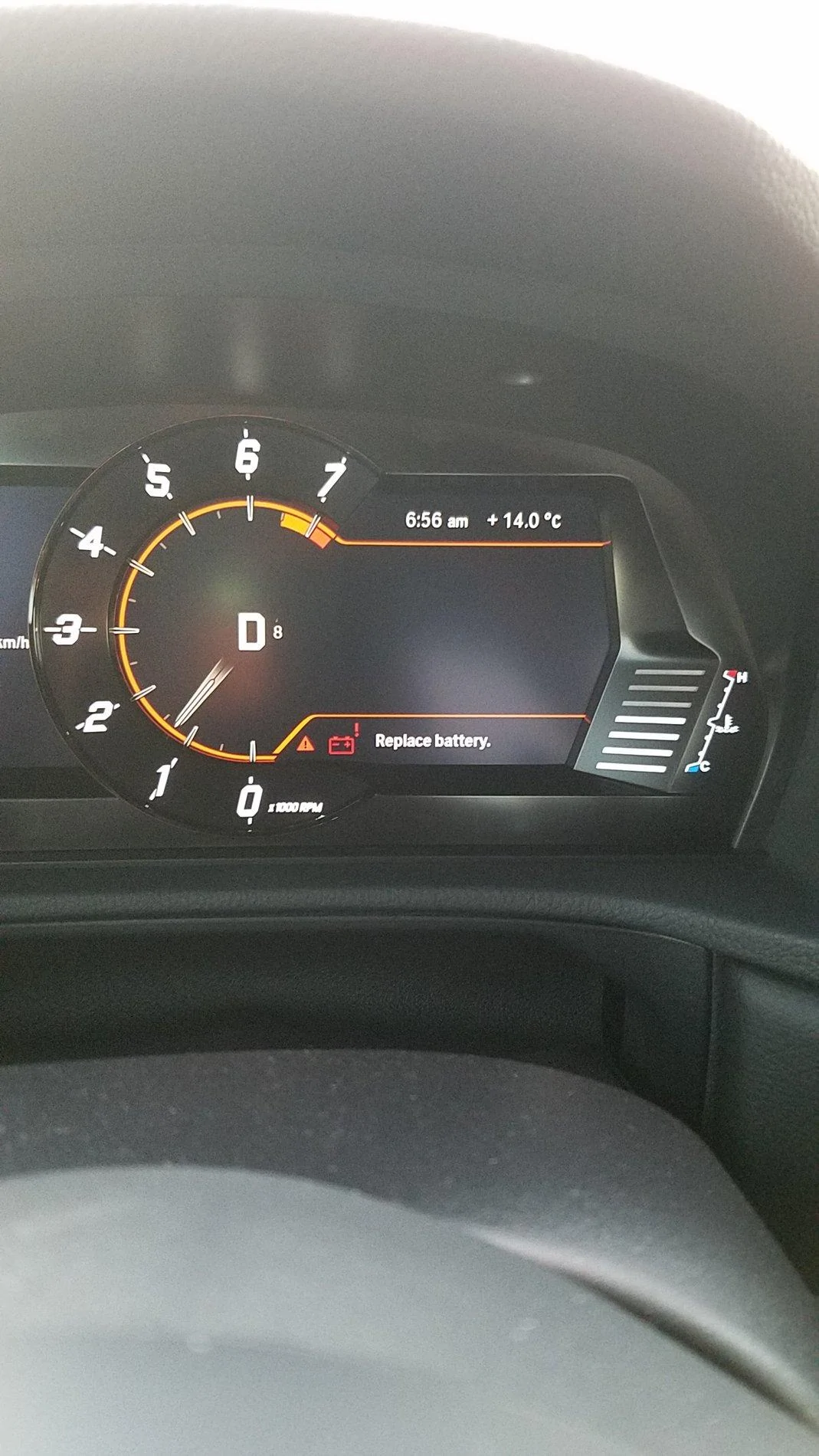

I got this same issue with my supra. The dealer is ordering a new battery for me. I tried charging the battery and the charger shows 100% fully charged but it still show to replace the battery.
If the Supra battery drains below 30 % before reaching 200km milage this message will show up ..but it can be solved by charging the battery and clearing the code.
