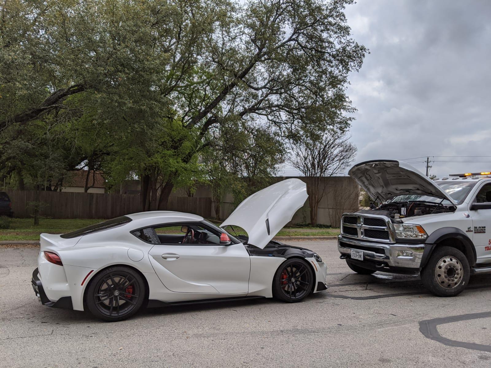

Same issue i had too. Bought my LE brand new from Round Rock Toyota and noticed it had the "Replace Battery" warning on as well. When i asked the dealer before driving off the lot, they simply said it was sitting on the floor for a while and it will go off after driving it. Drove it for couple of weeks and the lights were still on. Had to take the car back to the dealer to charge up. It didn't seem like they were aware you had to register the battery for the lights to go off (I had to tell them that I saw someone sharing on the Supra forum about their experience with dealer). Left the car with them for a couple of hours and finally it was all good to go. Great.
Fast forward couple more weeks, the Supra's battery is completely dead and wouldn't start from my garage. Had to call Toyota Roadside Assistance to jump start it. After driving it less than a mile today, the car shut off completely in the middle of my neighbourhood. Had to have the guy come back and tow it straight to the dealer.
Hopefully Toyota is able to replace the battery and resolve this battery issue. Anyone else had to go through this ordeal?

Sounds like a legit bad battery. I know the non-registering is a common issue as the sales team is not aware of it. That being said, the dead battery has to do with the fact that the battery is still running despite you not being in the car...
digicidal
Jan 13, 2020
1,042
1,386
Las Vegas, NV
If they were able to charge it and register it... the battery was still well within specs - so it being dead is because it sat in idle mode for way too long most likely (or some other parasitic drain caused it, but if you didn't add a dash cam or other electronics without shutoffs I doubt that).
If you locked it then it should have been fine, but if you didn't - and keep the keys too close to it, it might not fully shutdown I suppose. How long between drives was it sitting (and how short were the drives)? Even when I lock mine, I've usually already shut it down completely by holding the radio power button 3 secs. before I even exit the car. Shouldn't need to do both, but it's become a habit.
