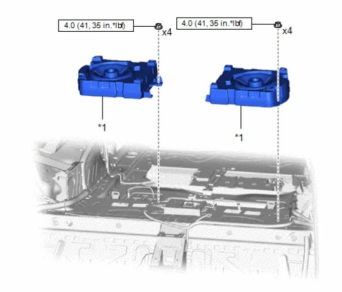

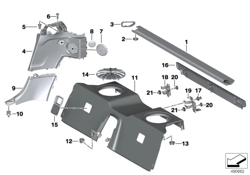

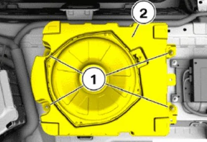

I found some pics of the subs in the supra shop manual...really pathetic looking
