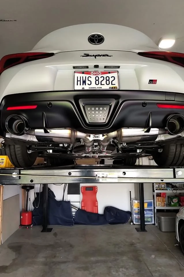

It has been great, sound level is just loud enough that I am slightly concerned about local EPA laws (especially cold start) but exhaust note is fantastic, albeit with a slight drone. Can confirm no CEL, with OZ supra as well. Thanks for hooking me up with the AA DP.

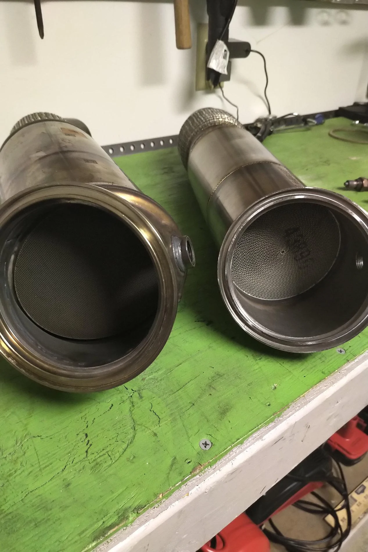

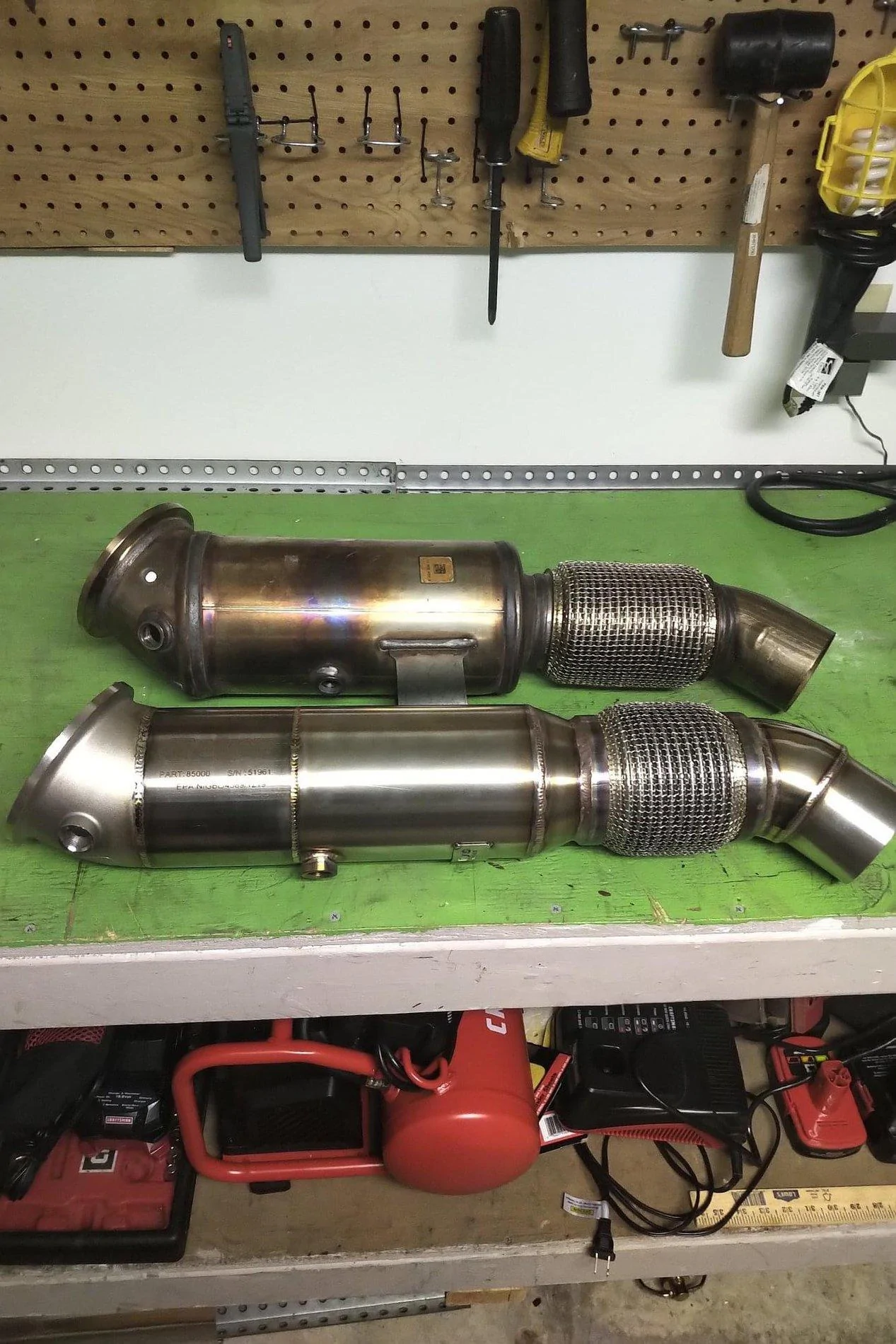

Well i also did not have any other part of the exhaust on the car, as mentioned i am still waiting for some parts... so it was not like i could plug the dp into the exhaust to support it and angle it into position using both hands. I literally had to support it up and against the car with my left hand while reaching up along side it trying to pull the vclamp on and tighten it by hand just enough to be able to keep it against the car with enough force to be able to drop my left hand. I think the clamp is all the way around it now, a few times in the process i felt the clamp around it at the bottom even able to hold it in place unsupported but along the top i could feel the clamp was misaligned. Most likely as i was holding it up and against the car it drooped a little as i tried to hand tighten the clamp. A bracket to hold it up there would sure have been nice!
i did not realize that the overall diameter of the aa dp was so much smaller than stock. Maybe the inner diameter is larger or the same but the outside is definitely narrow. For them to mount a bracket in it, it would have really extended far out.
a real nightmare to mount without an exhaust on the car and without help. I would not want to do this again.

Which part is smaller diameter? The transition from the catted section to the flex pipe in the picture looks much more favorable in the AA. From the angle of the photo it looks like that could be a bottleneck in the OE piece.

Looks great!
The circumference of the stock dp is 17.5" and of the aa dp is 14.5"
The picture below very much highlights what I am referencing. I am actually surprised, I would have though the situation would have been reversed.
