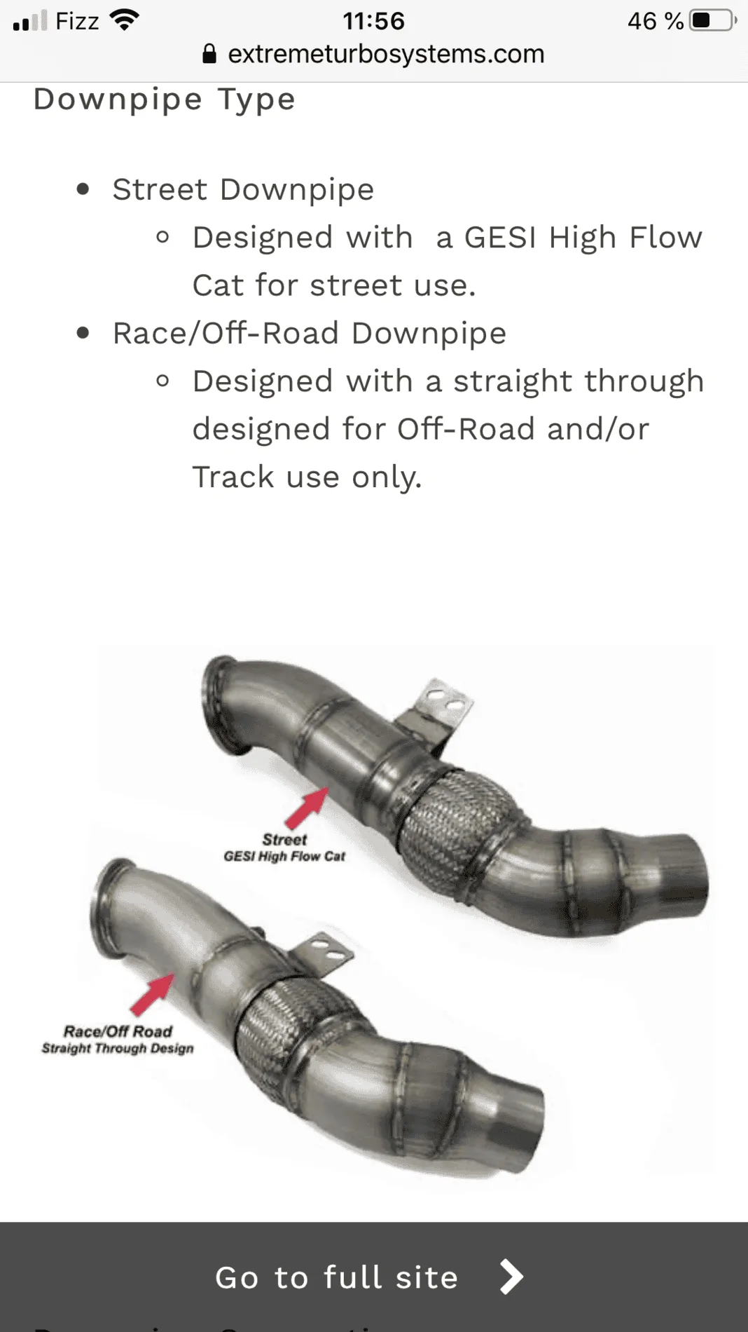

The ETS catted downpipe uses high-flow GESI cats, does it guarantee no CEL? Or should I buy the AA?
Also, when using a tune or piggyback, is there a major WHP gap between a high-flow GESI catted DP vs non catted DP? Didnā€™t find a clear answer about that.
As per Speedindustry 5-10 peak hp difference between catted and catless
Been running AA catted since December on a stock tune and no CEL
Tried it with a BM3 stage 2 for a month no CEL too
