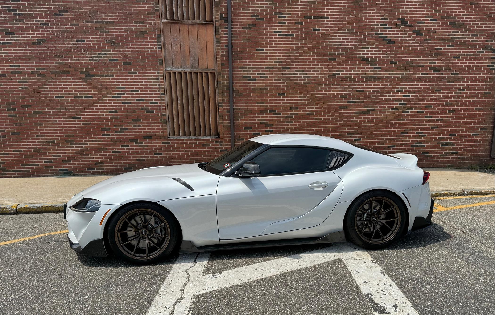

Whiteline is a pretty even drop of 1” front and rear. Ride quality in comfort is about the same. A bit more stiff in sport mode. Josh @Meraki Autoworks has great prices over there. Here is mine on 265/35 and 295/35. Not quite as low as swift, RSR super down or eibach but still lower than the euro spec Eibach. Zero regrets here!
is there any advice you would give with installing them. I saw that you said you had to call whiteline and they weren’t any help. I was just wondering what you did with bump stops or did you purchase anything to install it and have no issues. I’m going to run te37s 18X10 +25 / 18X11 +34 5X112 and I just want a little gap between body and tire
