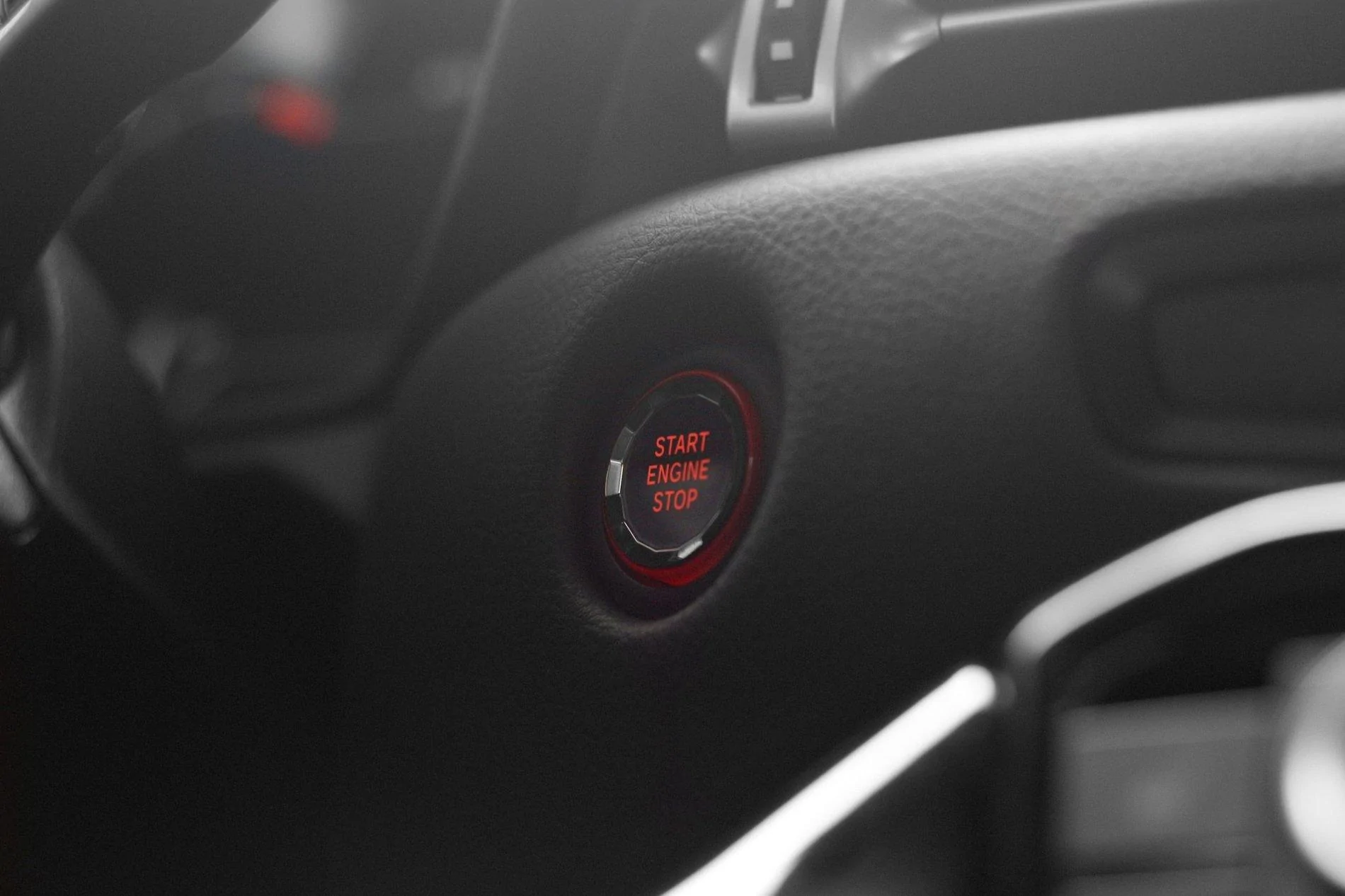

Best way to remove Start Engine button?

I’ve tried everything short of pulling apart the interior. I want to avoid that, any tips?

I used a clay bar.... Warmed it.... Then stuck it on.... Waited a minute and let it set..
Then pull hard and fast....
Worked great

It worked for me with the supplied putty...try this approach below with it....
I had success after I rolled the supplied putty into a ball and placed on small smooth bottle cap I had...I then pushed that onto the button and pulled back quickly...this provided much more surface tension and the button came right off!

Just tried to install mine and my button just won't come out. Tried 10+ times. Still no sign of it coming out.

i used claybar on mine. heat it up a little so its more workable. maybe even the 3M double sided tape stuck to something and pull it straight out. or last resort to a hot glue gun stick, but it might be a pain to clean the button after.

The crazy thing is...I tried the 3M tape as well. It did much better than the putty but still didn't come out. Think I should stick some 3M tape on the button and let it stick for a half hour then try it again? Clay bar is my next step after that.

heating up the 3M also helps it stick much better. try to stick it to a bottle cap and use the bottle as leverage? haha idk just thinking of something for more leverage.

Try using clay from a clay bar. Make it the same size as the button and about 1 inch long. (Like a tootsie roll shape)
Warm it in your hand until it's sticky. Put it on the button and then run your ac on full while holding it for 2 minutes.
In one motion... Pull straight out .... So fast u almost hurt your arm.
If u fail.... Do it again.

Picking up claybar a little later and will make my last attempt today. If it doesn't work, i'll try again tomorrow. This button is going to come out!
