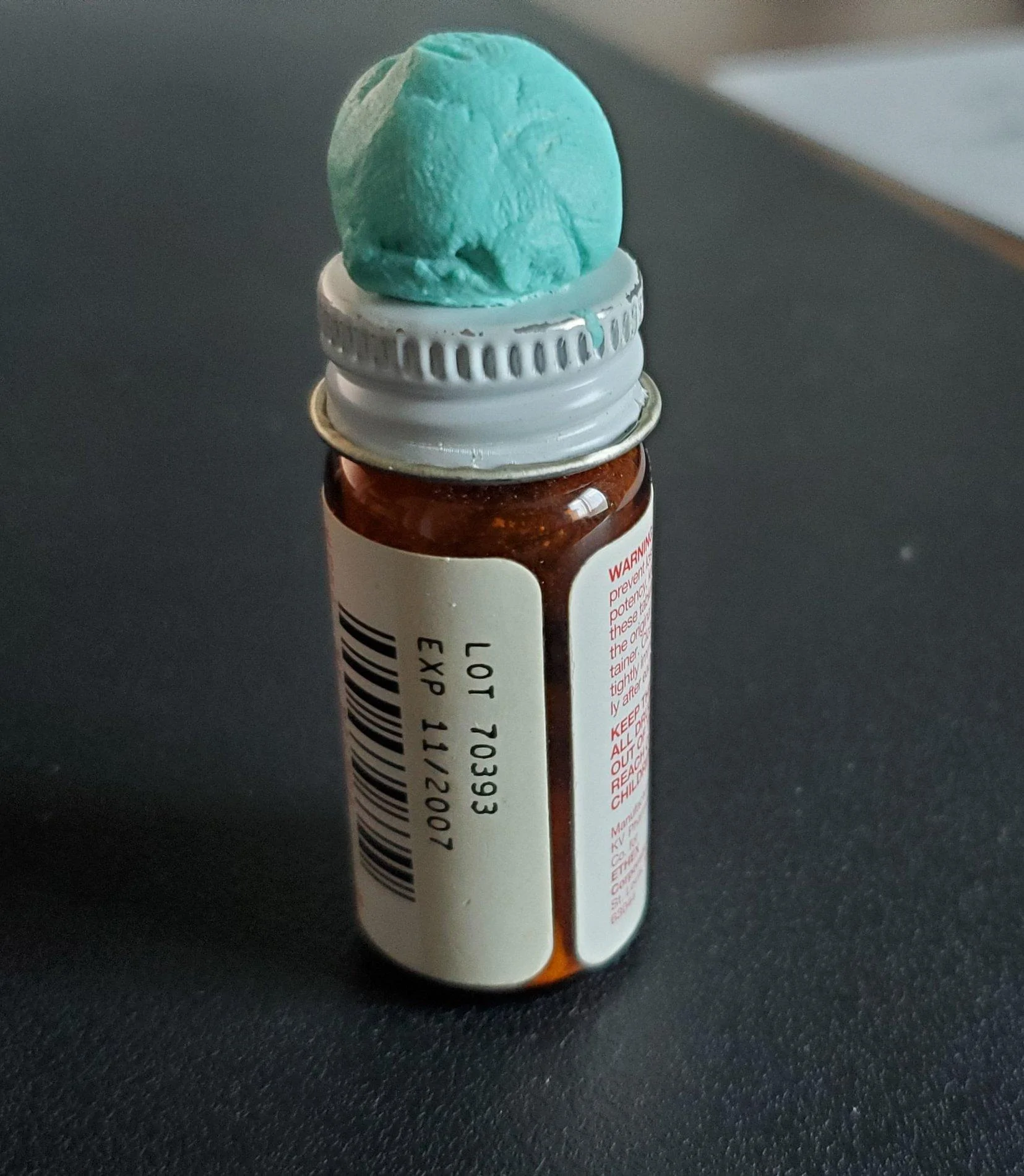

I had success after I rolled the supplied putty into a ball and placed on small smooth bottle cap I had...I then pushed that onto the button and pulled back quickly...much more surface tension and the button came right off!

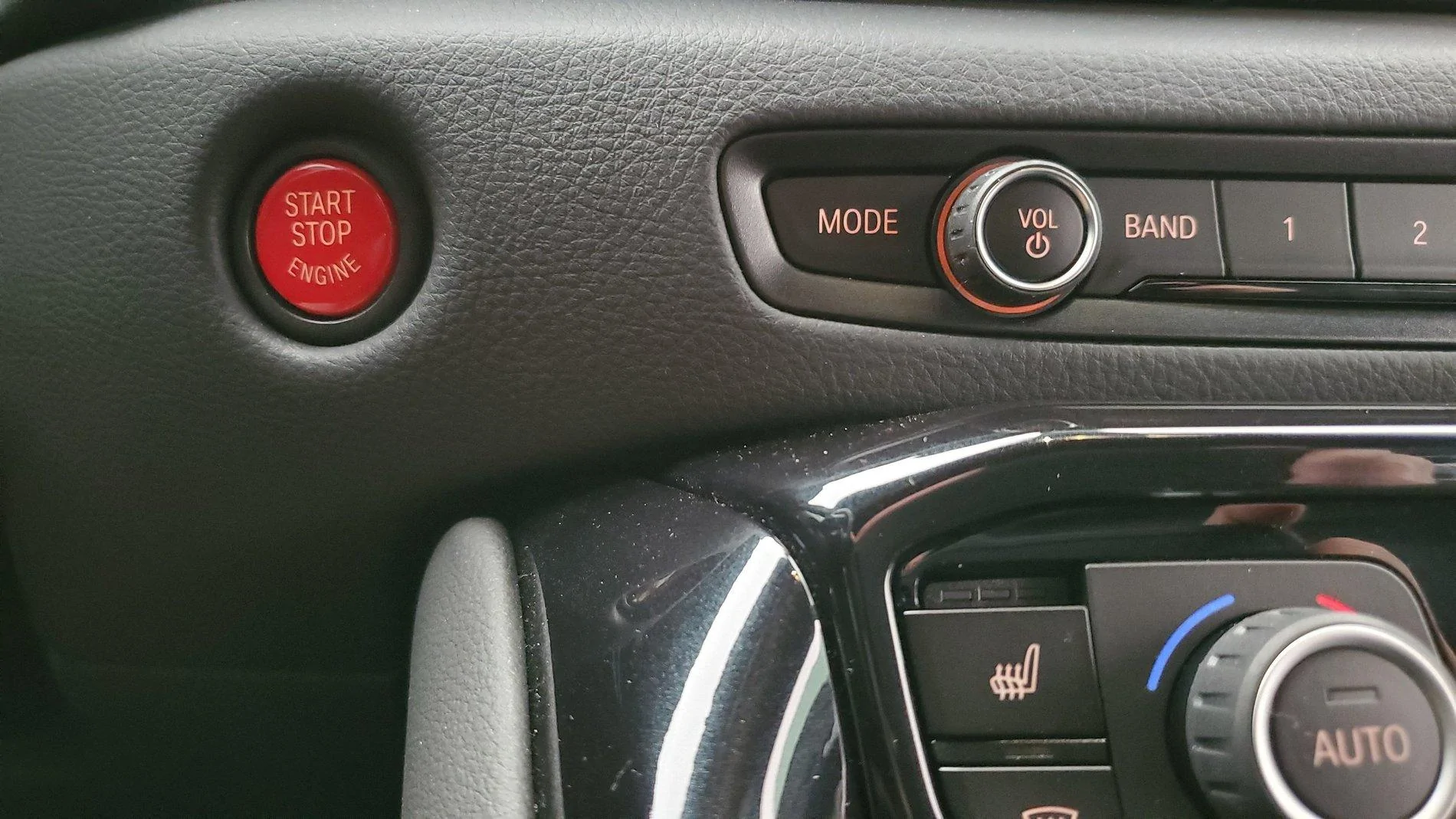

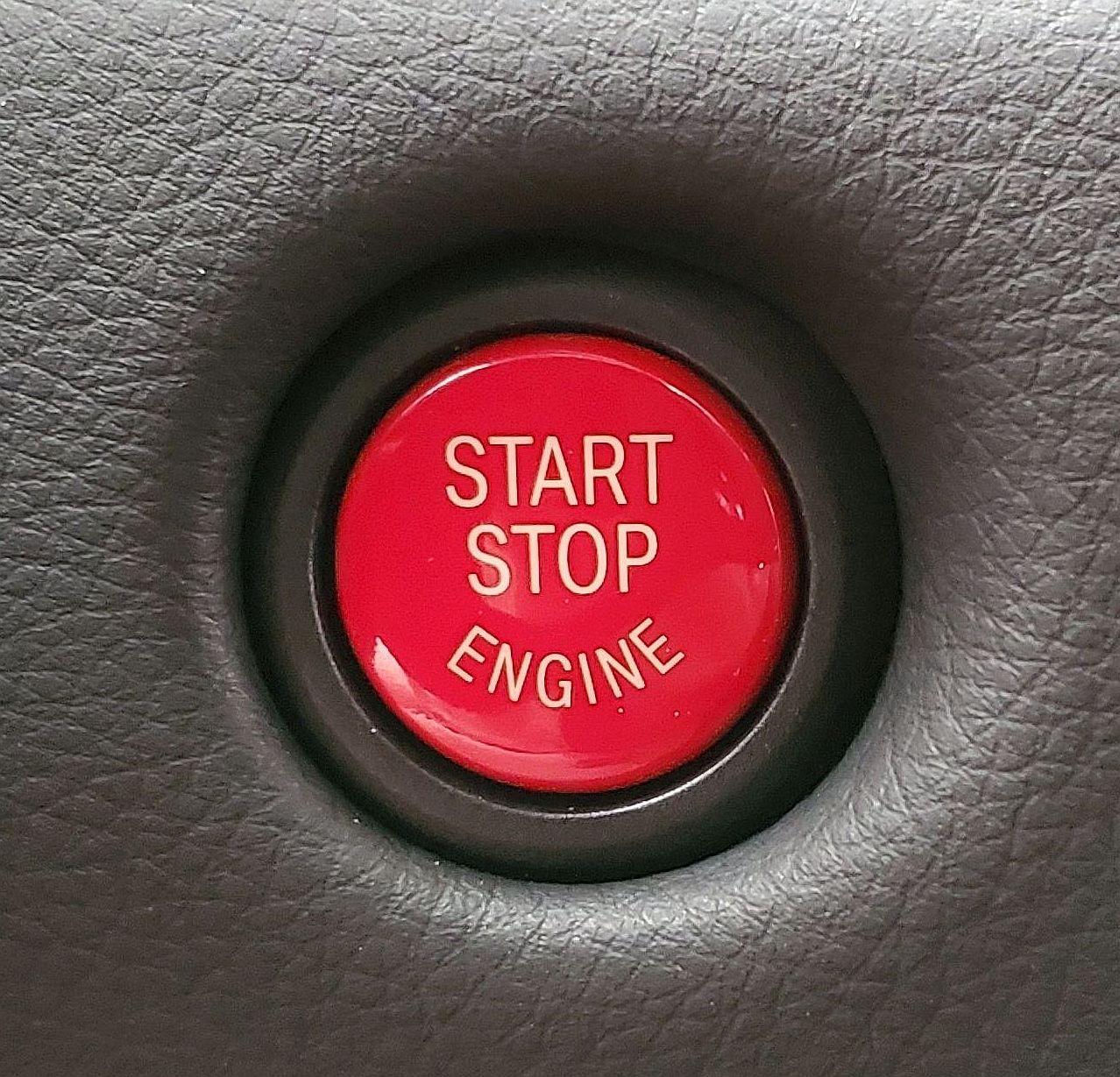

Surprisingly good quality for a $10 button...ha!

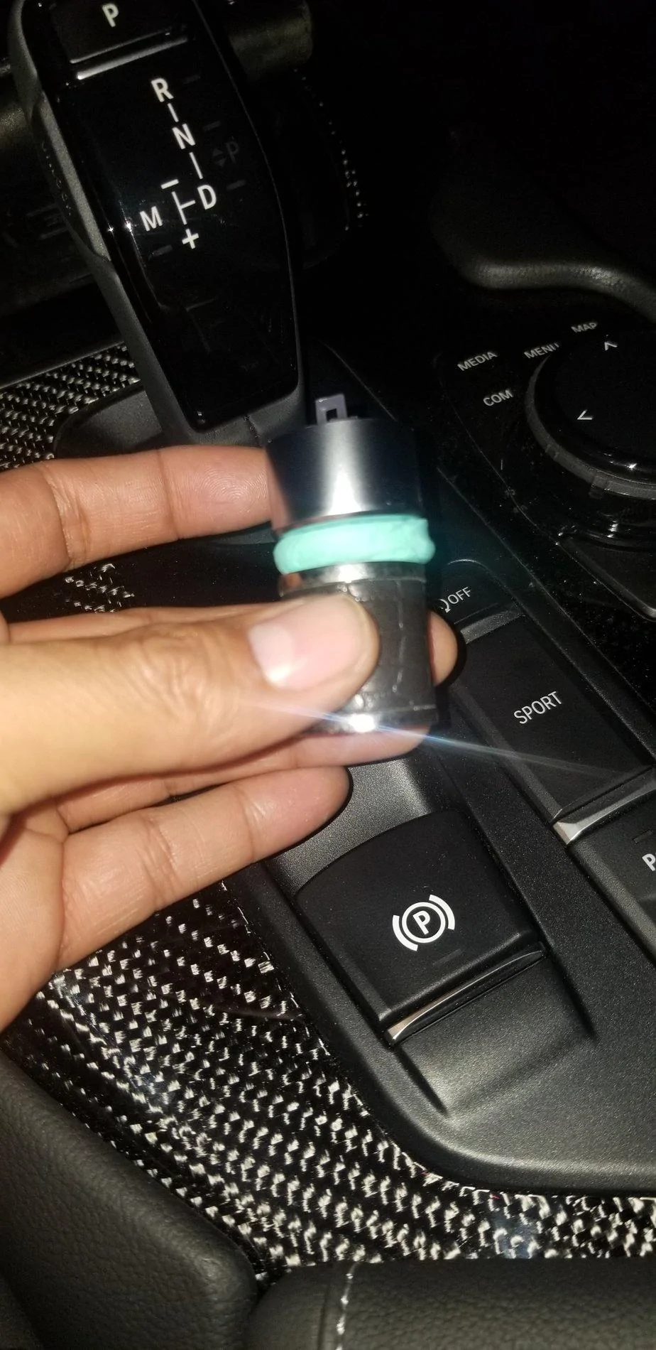

Ok so I tried a few times then finally went looking around the house for something roughly the same size that is metal. My ex wife bought me a bunch of cologne I never use and fuck me it worked. Thank you jimmy choo whoever tf you are lmfao. Got it installed!!!! Used the cologne cap!

I ended up using the supplied putty that came with the button....
I had success after I rolled the supplied putty into a ball and placed on small smooth bottle cap I had...I then pushed that onto the button and pulled back quickly...this provided much more surface tension and the button came right off!
That's how i got mine to come off, was struggling a lot with only the putty but after using a coke bottle it came easy out easy :thumbsup:

Thank you everyone. I was also having issues removing the button with the clay bar, but I took everyone's suggestions, and finally got it done!
I used the plastic cap from the Gummi Pfledge bottle, rolled a small ball of clay onto the plastic cap (Mothers clay bar if it matters), pressed the clay onto the button AND held it for a second, then pulled. $$$

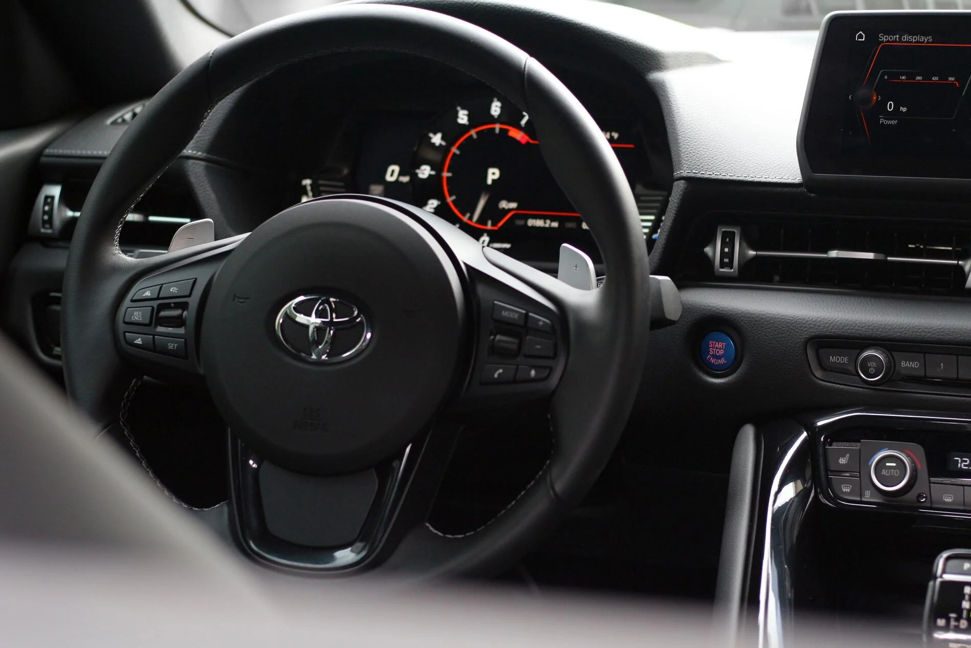

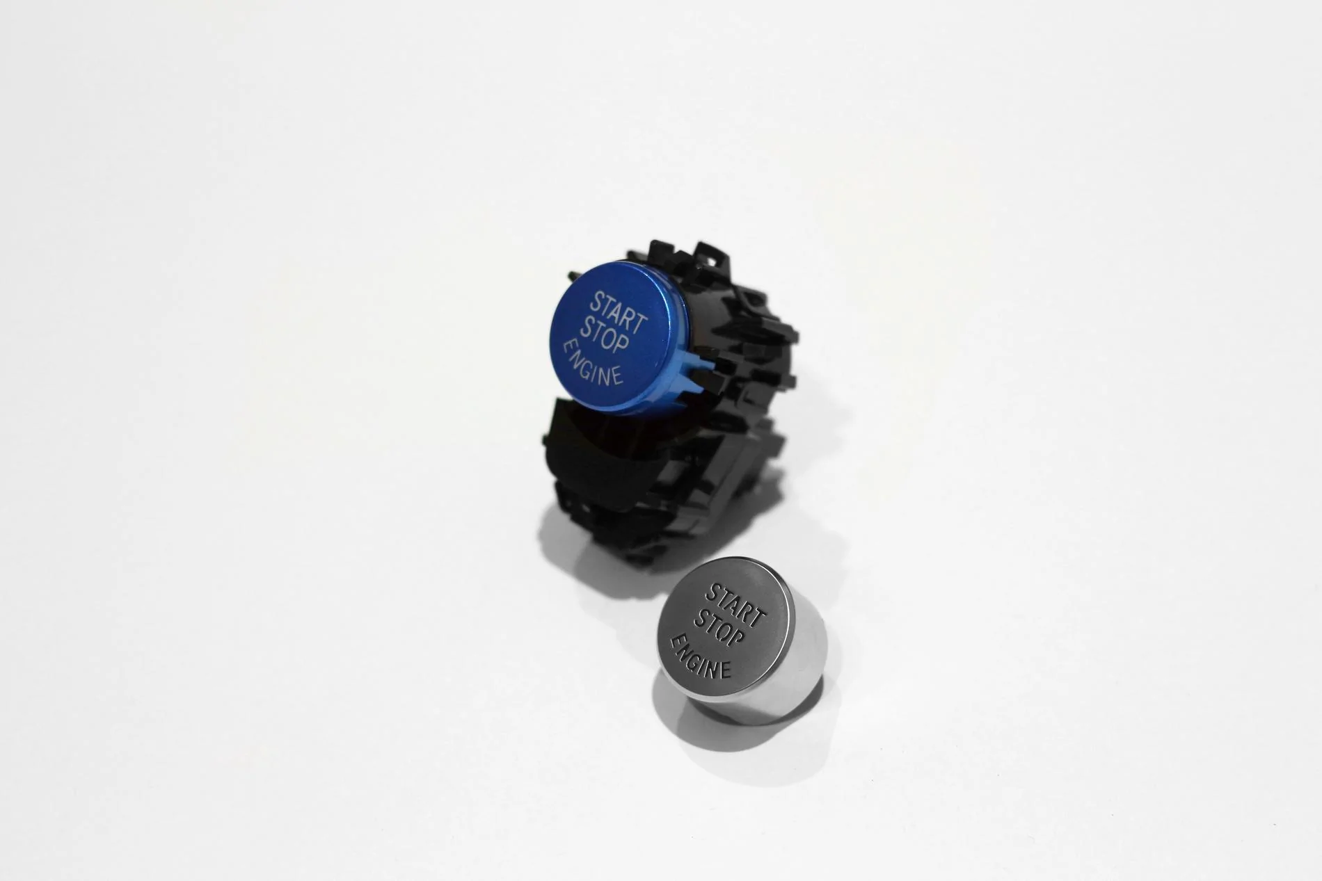

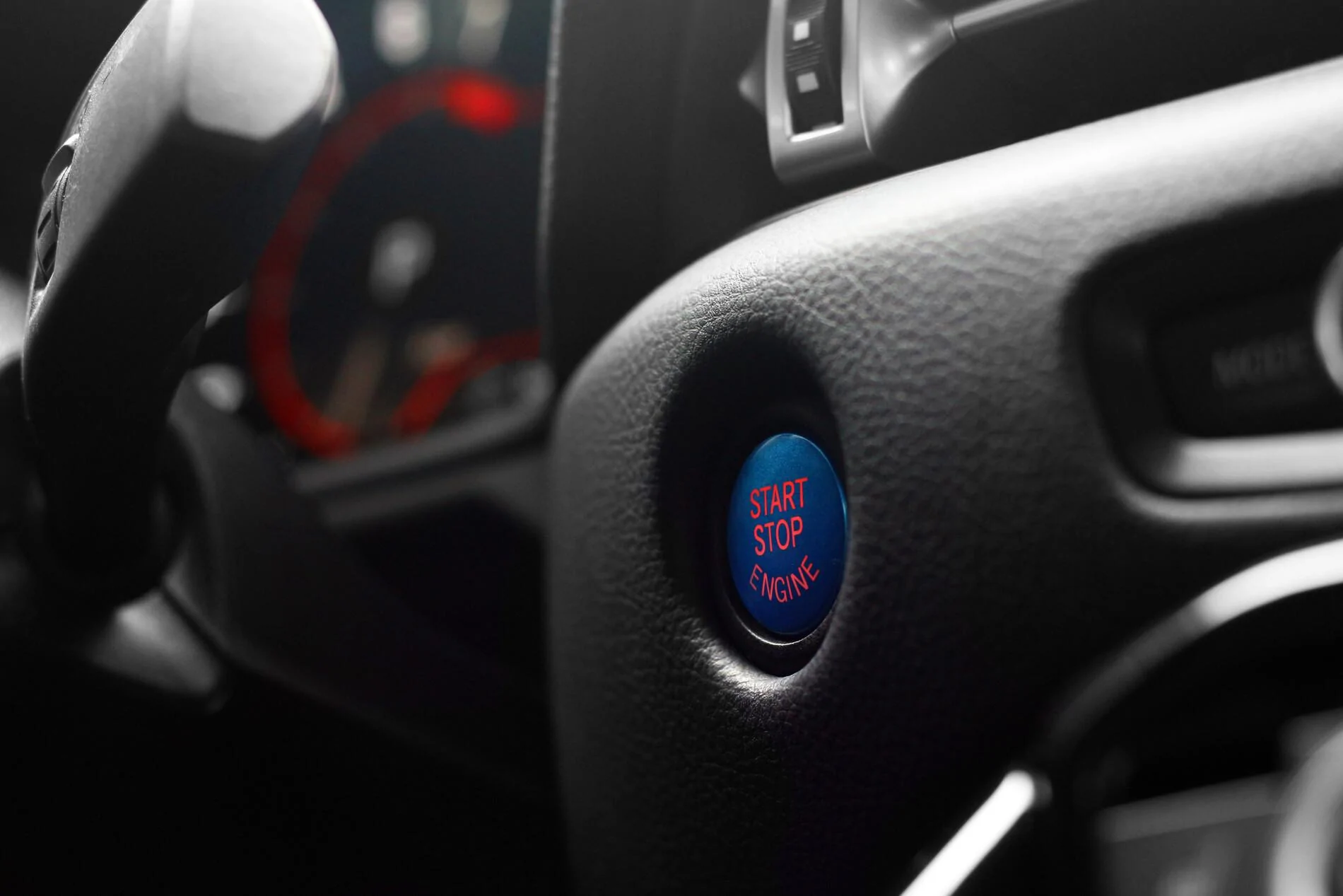

Added the brand new @iND-Distribution Replacement Engine Start Button to my Supra recently. There is 3 color options available: Red, Yellow and Blue. I opted for the Blue as I wanted something a little different from the rest. Something to note not sure If many of you care, maybe the OCD in my is getting the best of me, but I noticed the Amazon ones the text is not quite centered on the button (sitting slightly higher on the surface of the button. I ended getting both and did a comparison just for science purposes LOL. Really love the IND one the text is perfectly centered on the button and the finish is much glossier.
I also saw a few posts online about using a putty or Clay Bar to remove the button. Although that method would only take a few minutes, I didn't want to risk damaging the stock factory silver button or not being able to properly clip in the new button with the 2 prongs. The results turned out great. Some pictures below of my install along with the steps I took to install the button. Took me a total of 30 minutes from start to finish. A nice little mod to really class up the interior. Ended up making a Vlog out of it. Hope everyone enjoys!
