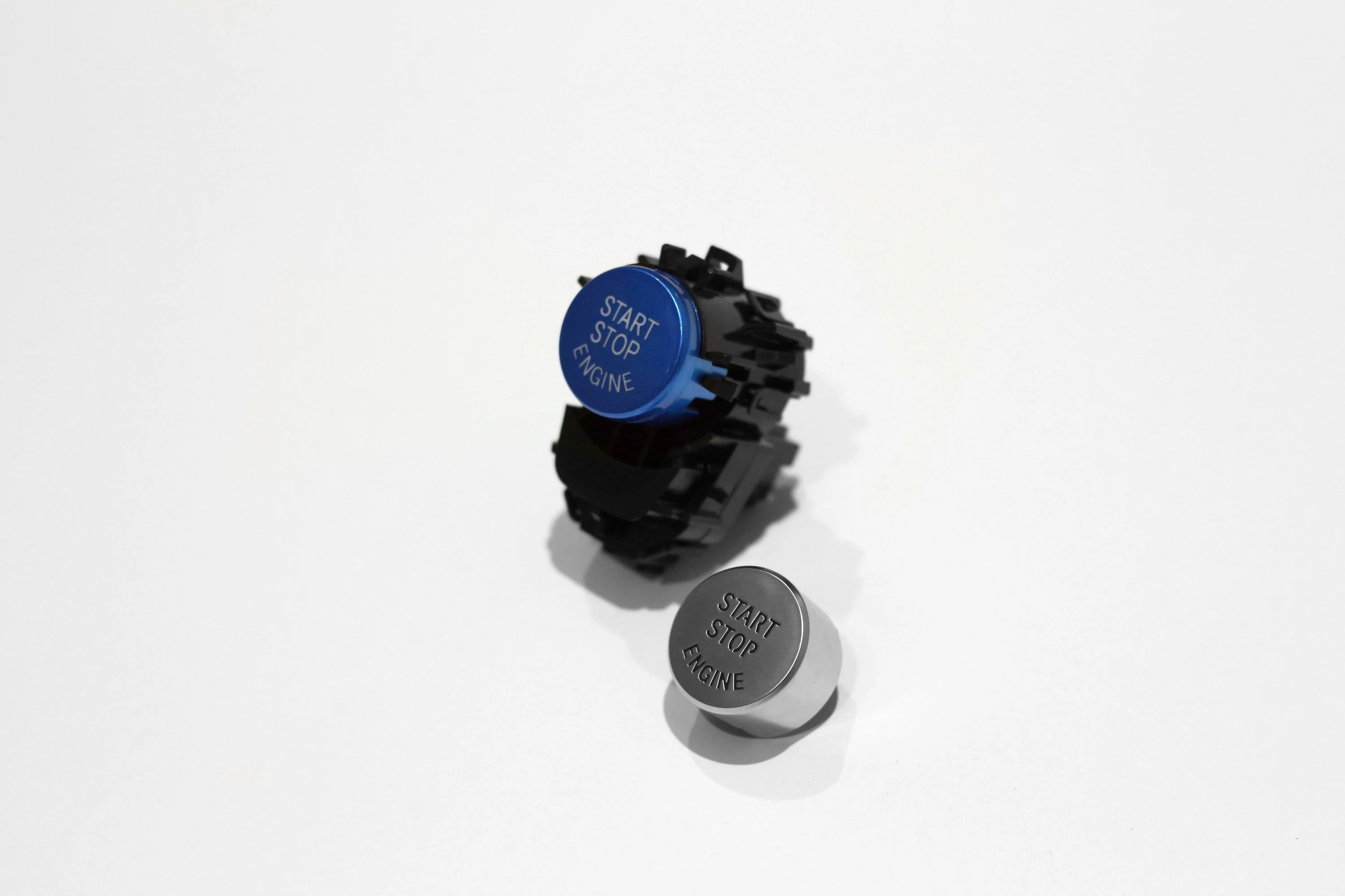

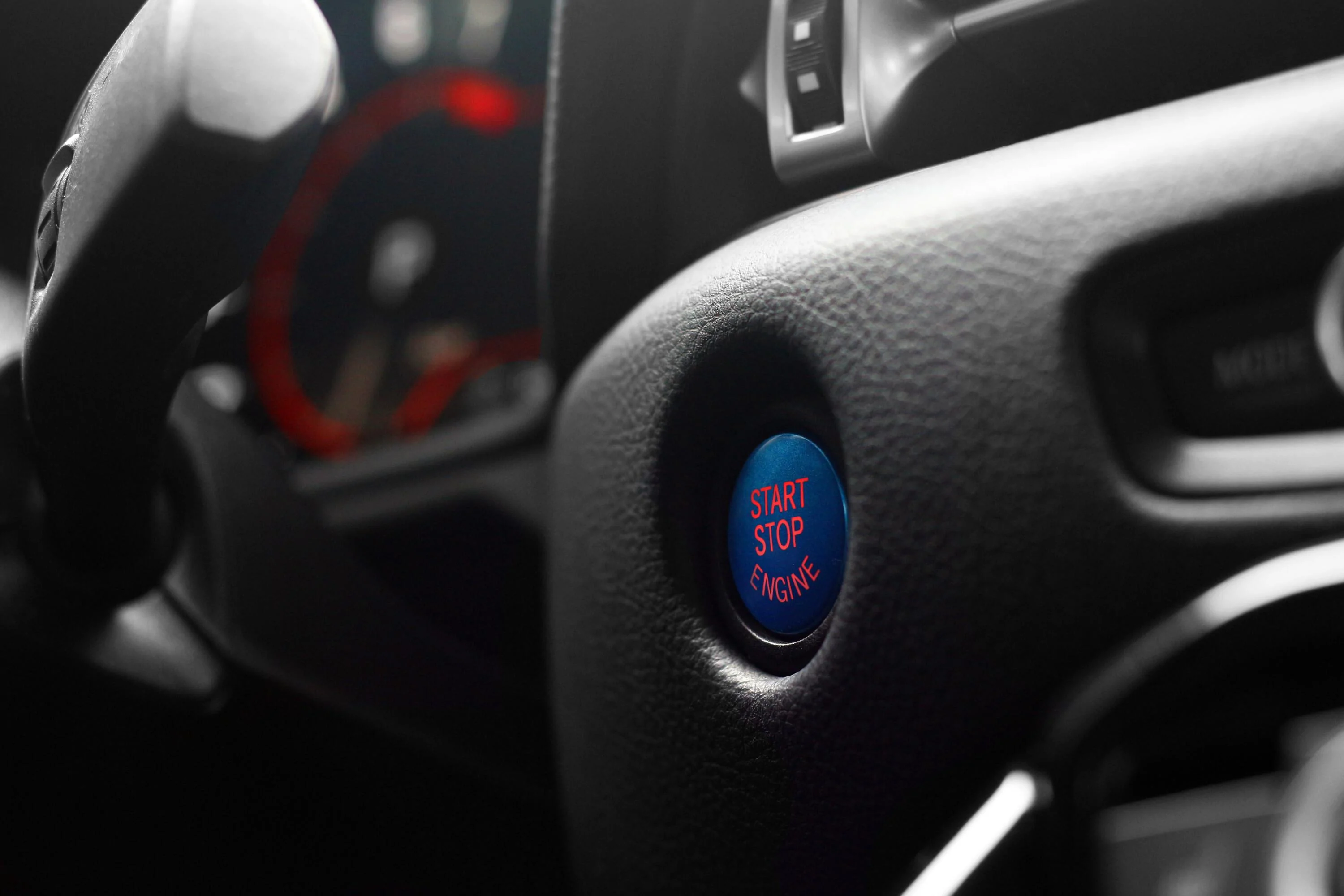

Added the brand new @iND-Distribution Replacement Engine Start Button to my Supra recently. There is 3 color options available: Red, Yellow and Blue. I opted for the Blue as I wanted something a little different from the rest. Something to note not sure If many of you care, maybe the OCD in my is getting the best of me, but I noticed the Amazon ones the text is not quite centered on the button (sitting slightly higher on the surface of the button. I ended getting both and did a comparison just for science purposes LOL. Really love the IND one the text is perfectly centered on the button and the finish is much glossier.
I also saw a few posts online about using a putty or Clay Bar to remove the button. Although that method would only take a few minutes, I didn't want to risk damaging the stock factory silver button or not being able to properly clip in the new button with the 2 prongs. The results turned out great. Some pictures below of my install along with the steps I took to install the button. Took me a total of 30 minutes from start to finish. A nice little mod to really class up the interior. Ended up making a Vlog out of it. Hope everyone enjoys!

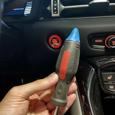

Here’s what worked for me after failing a few times! I didn’t have a good cap to use, so I used a screwdriver’s end. I was careful and positioned myself so I don’t stab myself with the sharp end. I pushed the loctite fun-tak hard onto the screwdriver and then hard for a few seconds onto the start button.
first attempt pulling ended up with a successful removal of the stock button.
