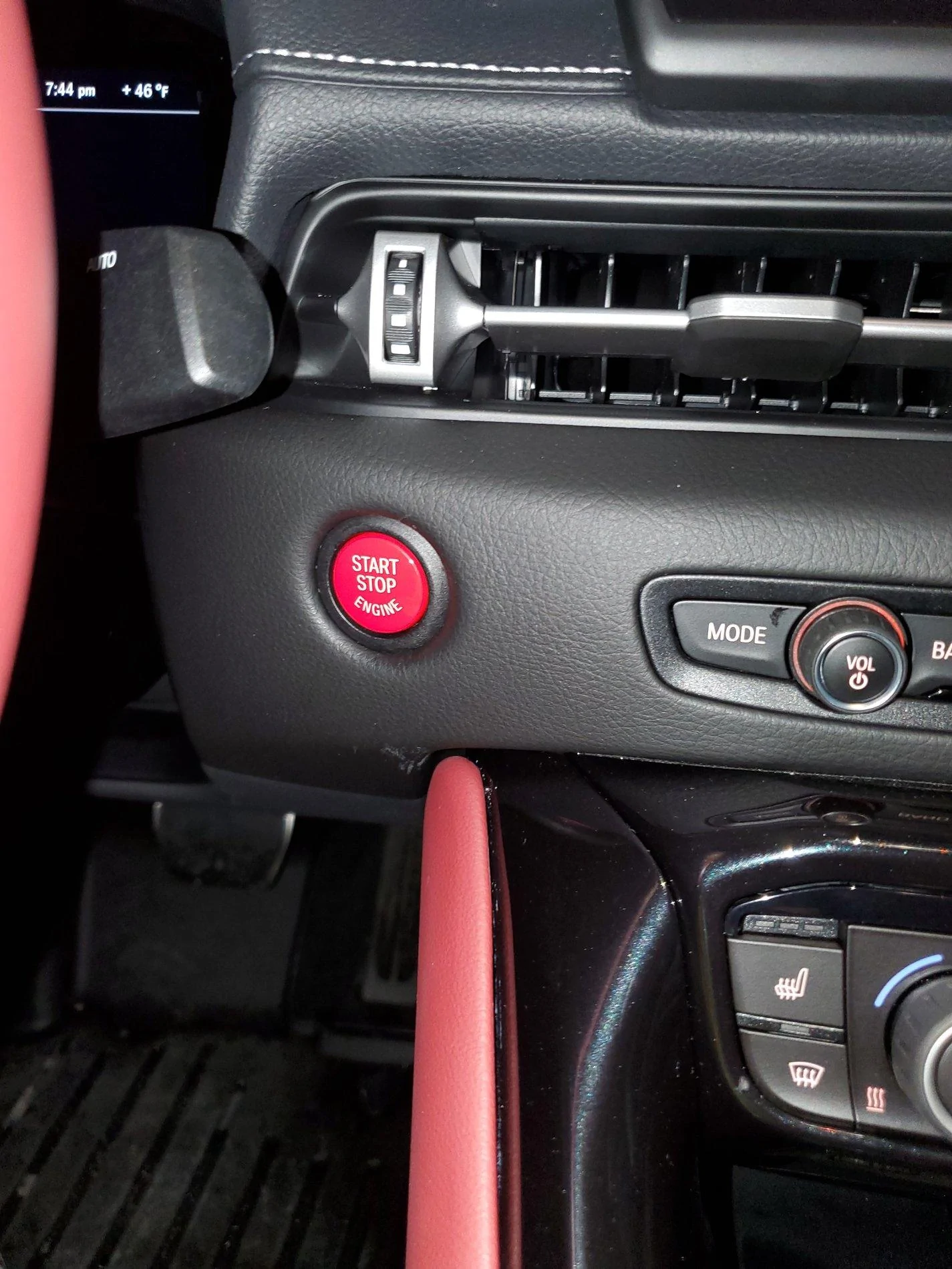

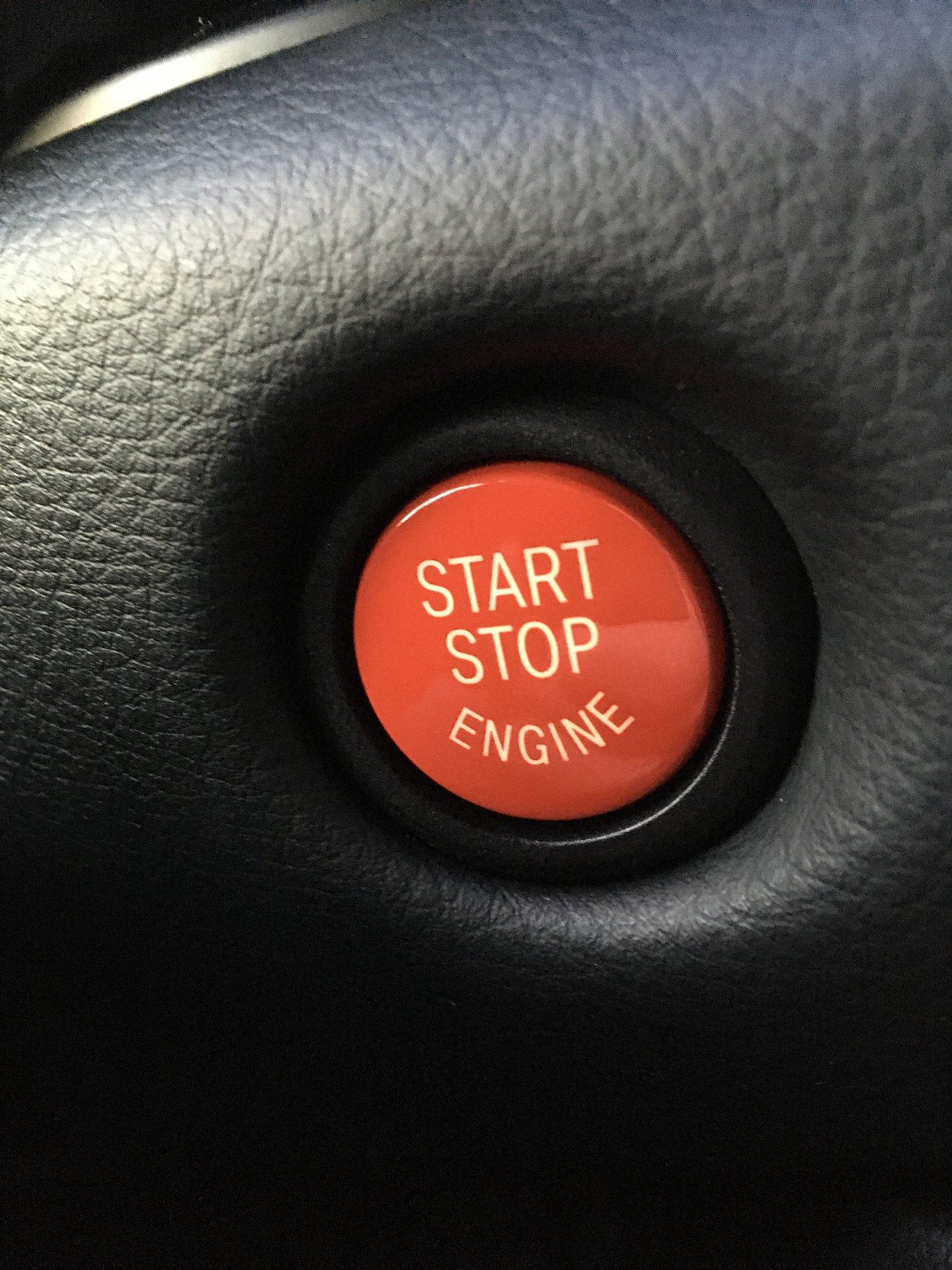

So is there any benefit to buying IND Style's red button (almost $60 shipped) as opposed to this one on Amazon for $10 considering they seem to be identical products?
Same one

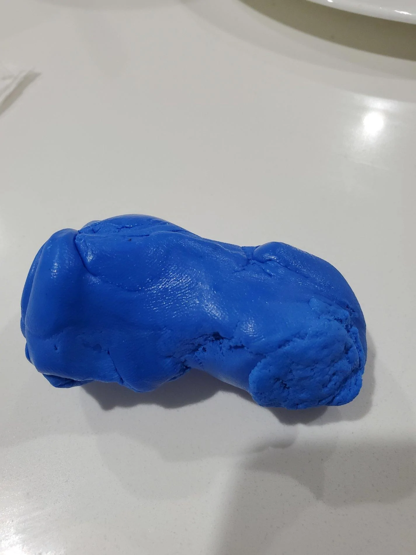

Couldn't get my stock button off with claybar. What kind did you guys use?
edit:
Never mind, used standard gray detailing clay instead of blue soft windshield clay and it extracted the stock button with no issues

was pulling the button out easy with that clay? did you do anything special to get it out?
Yeah i rolled it into a cylinder shape so it was only touching the button when i squished it (not the bezel) and pushed firmly and held for like 5 seconds then quickly yanked it out. New one pops right in!

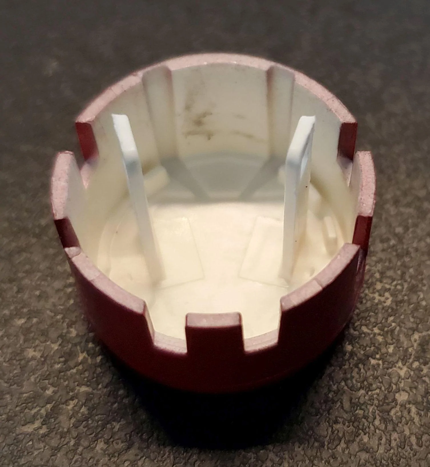

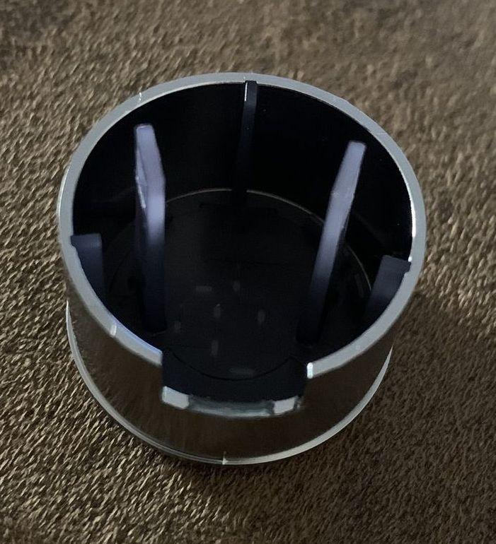

Just received red start button from Amazon...Here is the difference compared to OE as seen from back side...
I noticed there are 3 guides on OE button and I'm not seeing them on red button...Anyone who purchase from Amazon find this to be an issue?
OE Start Button (below):
Red Start Button from Amazon (below):

And yeah....the putty they include to remove the button is useless...

Keep folding the clay over and over until it gets tackier then try. You also have to pull it off pretty quickly or just the putty will detach.
You used a clay bar correct? not the soft putty that was included with button
