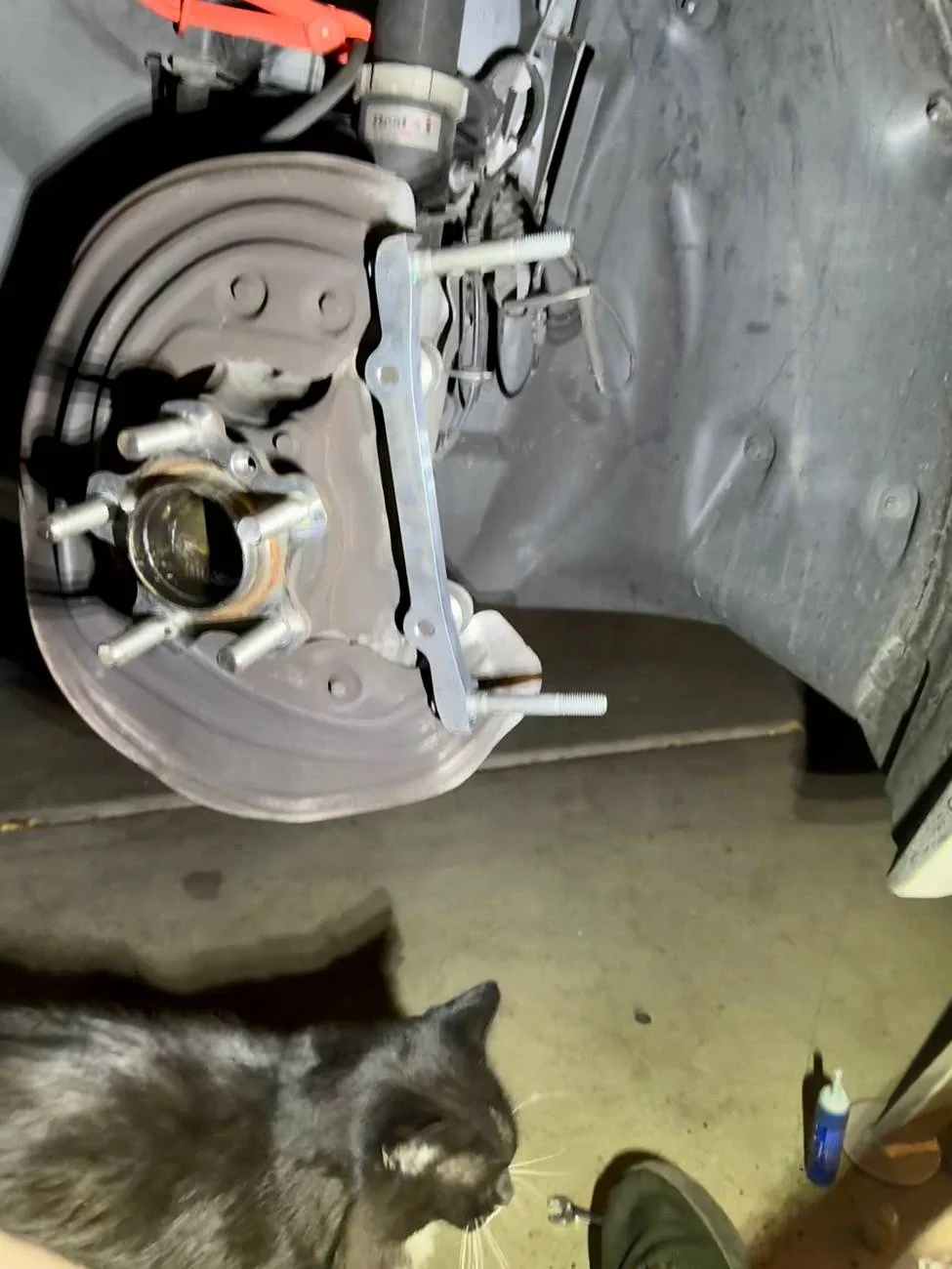

I have more of these adapters if anyone is interested :)
The adapters are made by S2Gizzle. They’re just machined pieces of aluminum that bolt to the Supra hub and accept the M calipers.

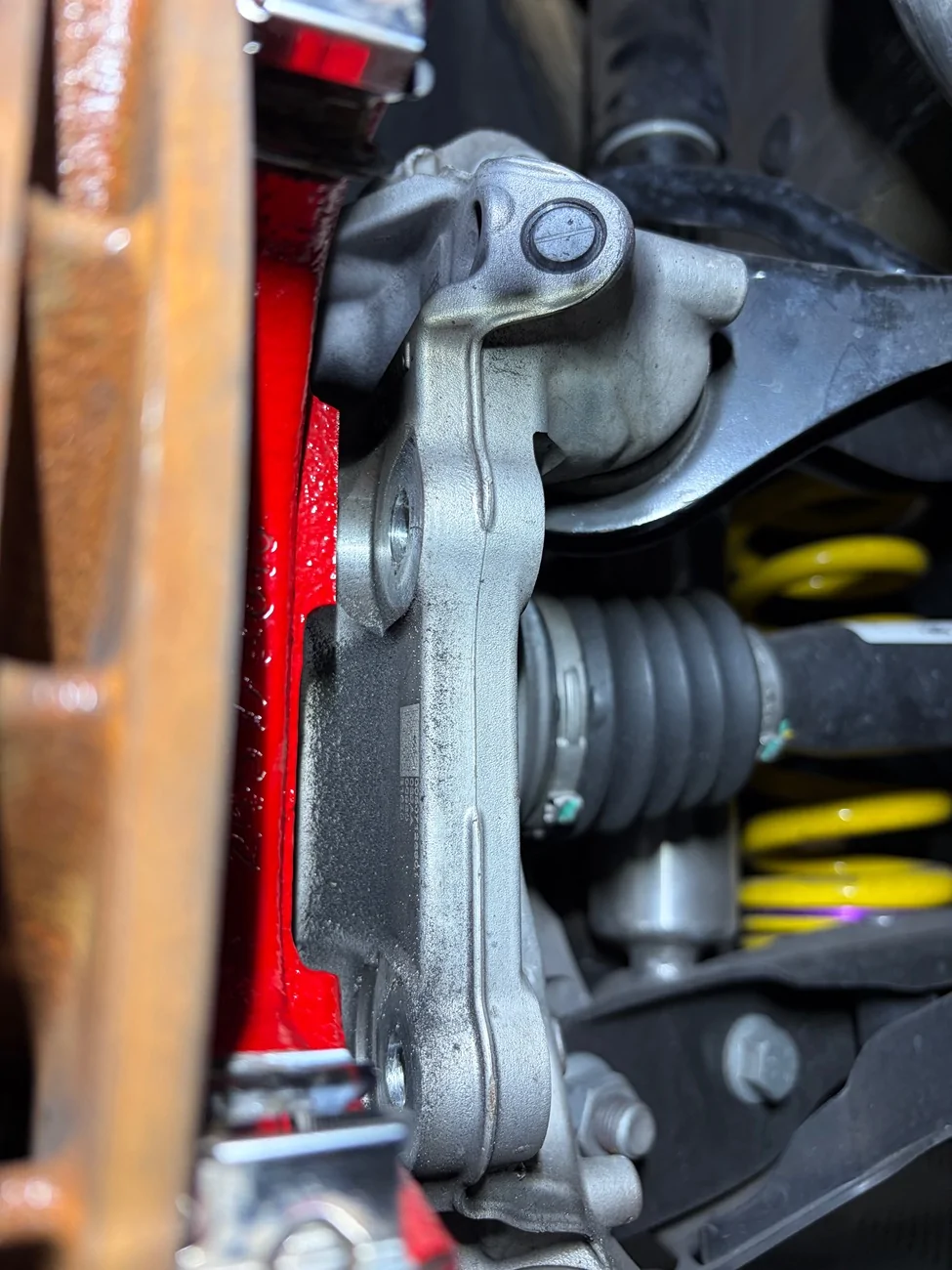

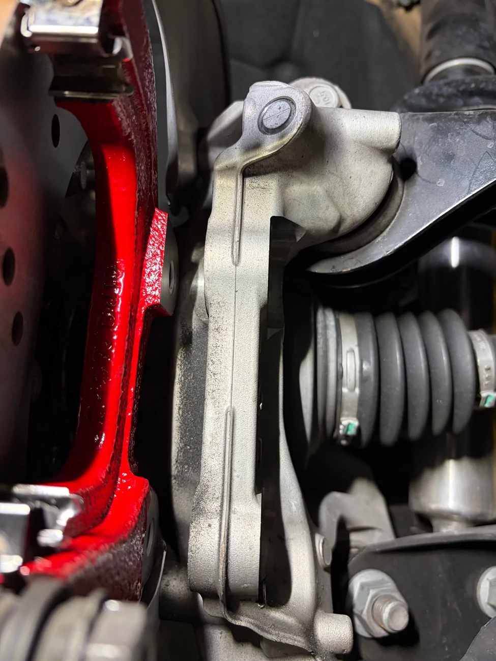

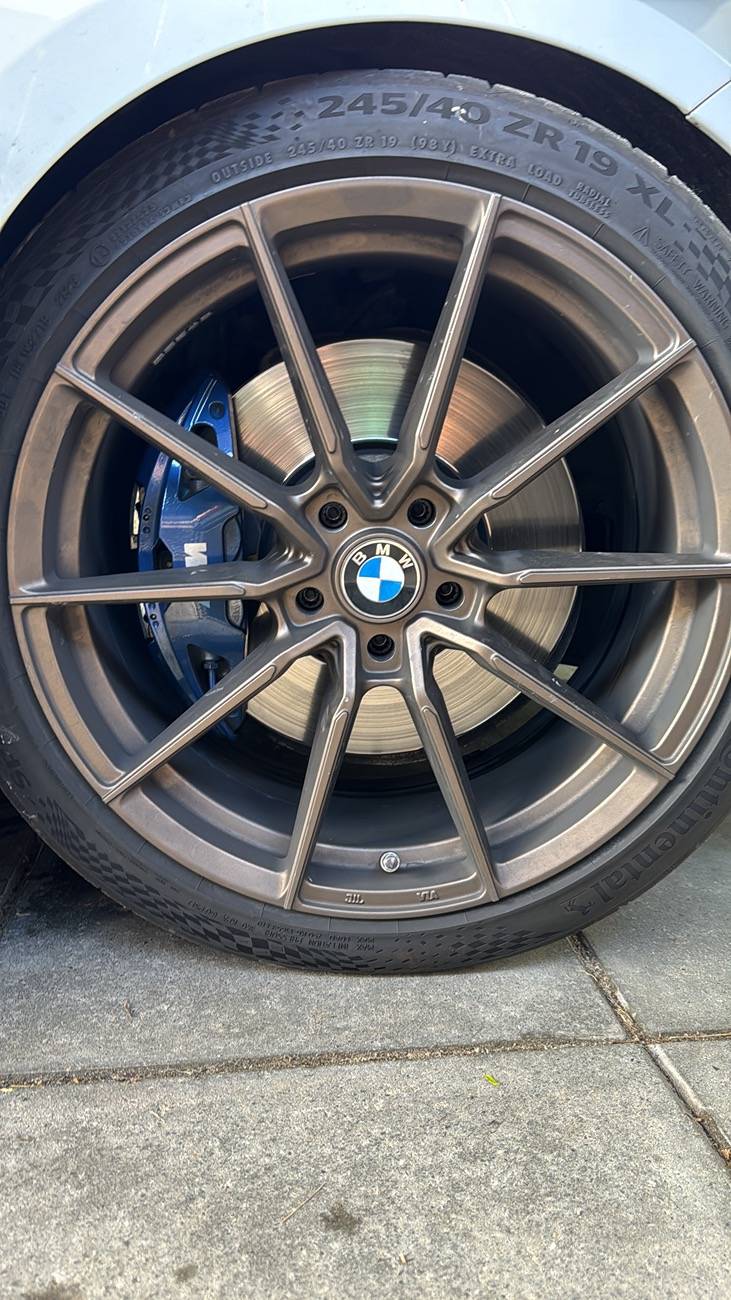

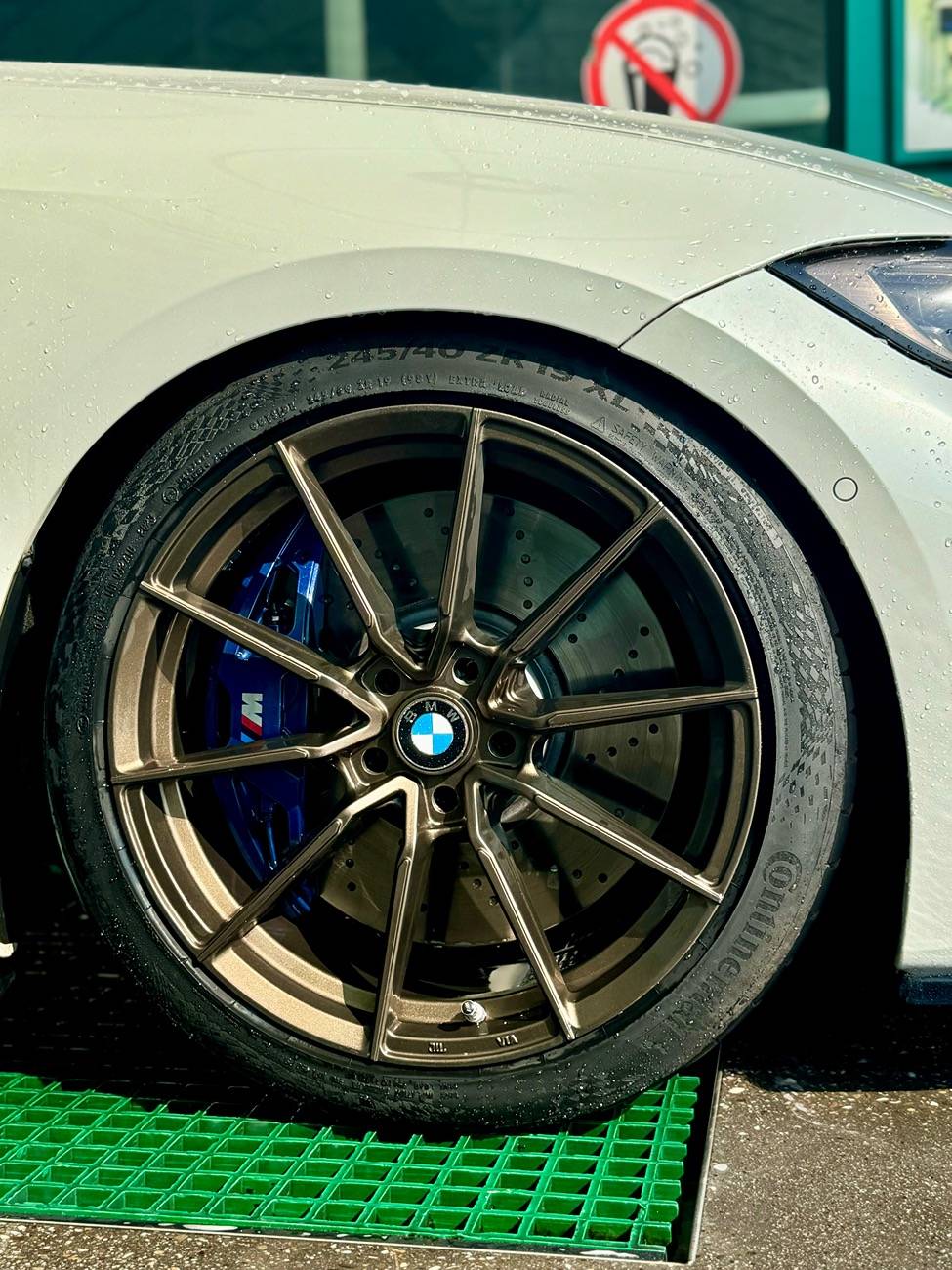

Hey guys, first post here. I wanted to add my 2 cents. I am currently running the 395mm x3m brakes on my m340i and 19” wheels. I did have to remove a little bit off materiwl off the calipers but they fit, very tight fit but been on for a few thousands kms now fine, also running endless brake pads which improved everything alot! Some photos:
Before: no track package so 348mm brakes..

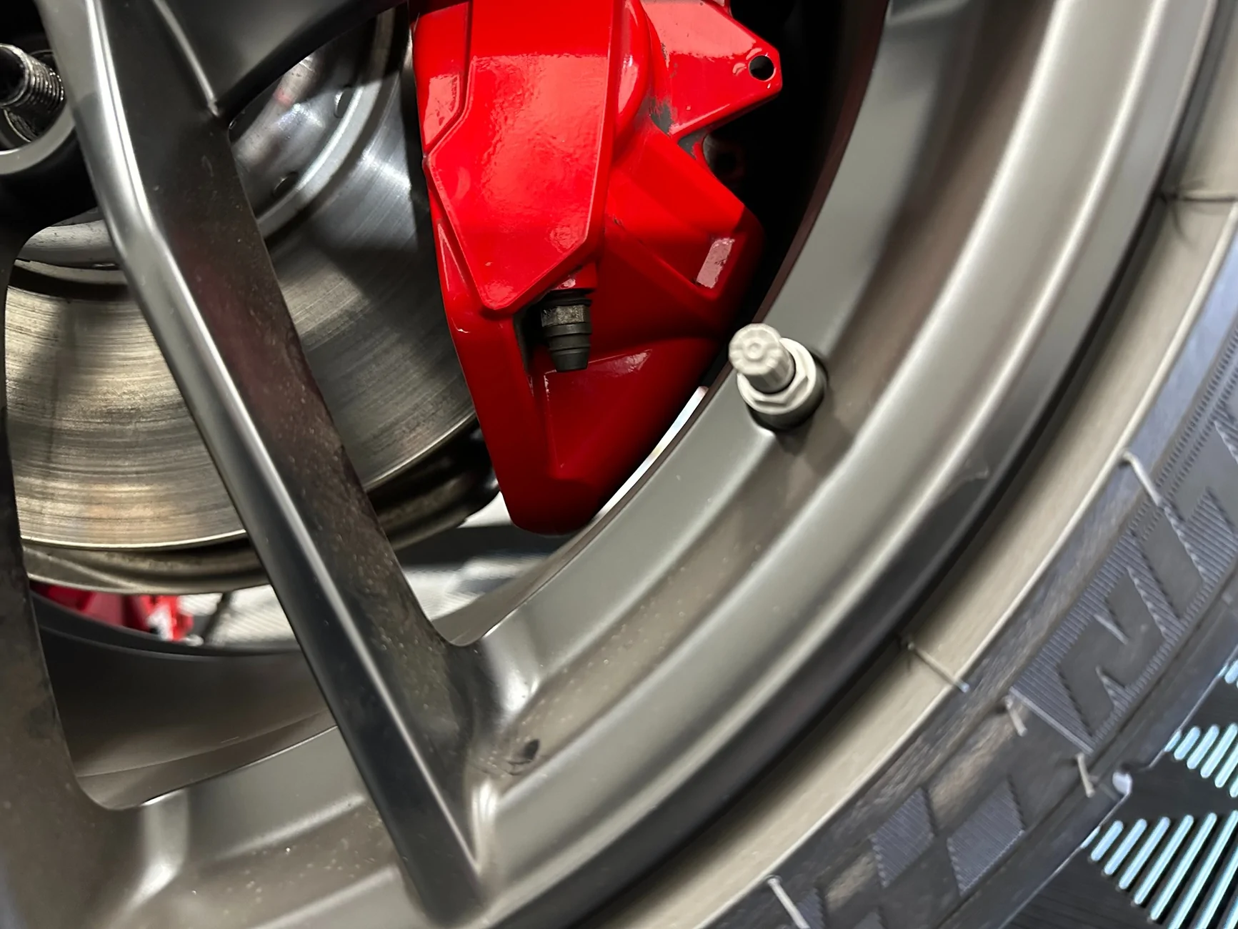

found a good deal, what do i need to make this work.
The adapters and a 19" wheel that fits them, oem wheels do not. Well, they do, but wayyy too close for comfort for me:

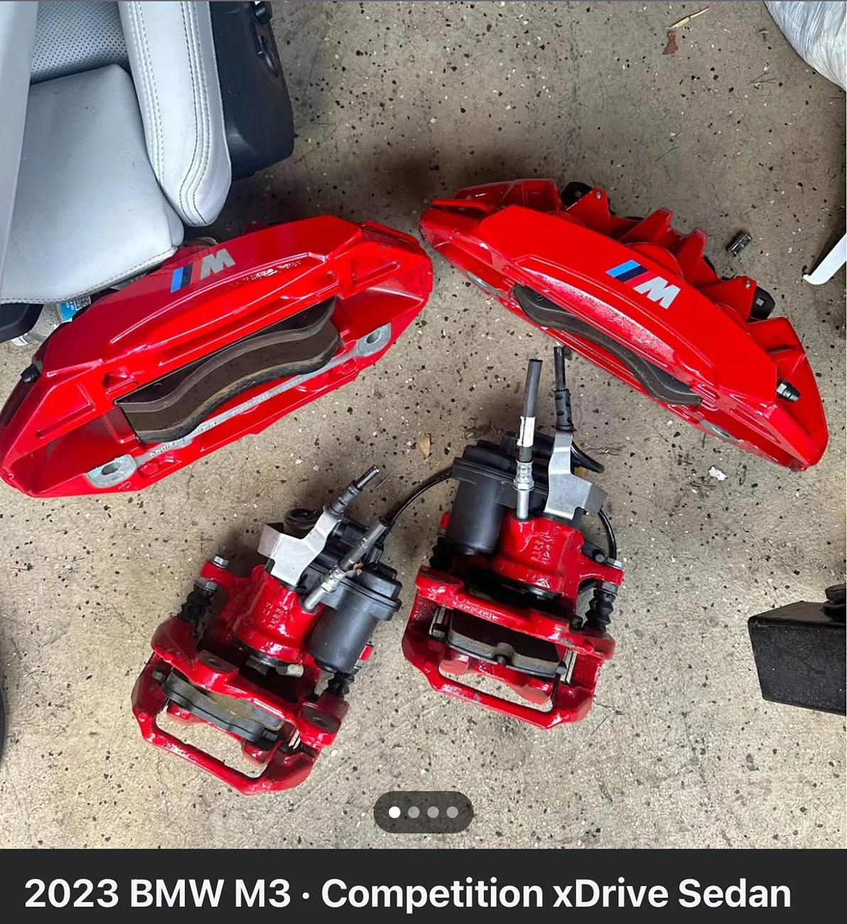

Well, apparently I screwed up. Picked up a used brake kit from a G80, got the adapters for the front.
The rear calipers do not fit. Do I need a different caliper mount? Different rotors?
