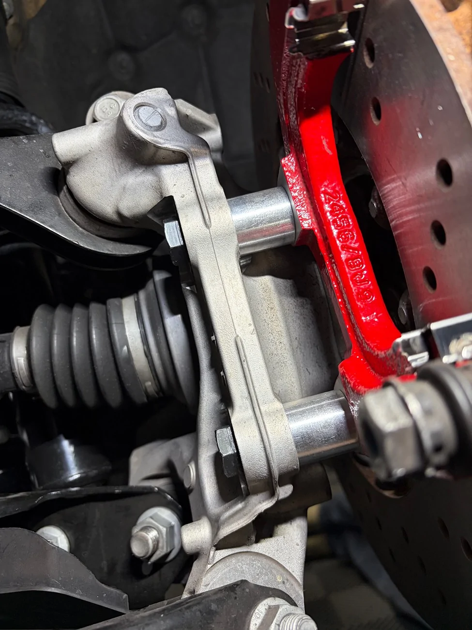

Good news is fronts fit great. We will see how the new rear rotors fit when they arrive and if I can get the adapters so I can use the full M rotors laters.
Edit - Since the 26.7mm difference is 1.05", I wonder if two 1" spacers would work, or if thats a stupid idea...
Edit 2 - Someone tell me if this is a horrible idea - https://www.amazon.com/Aluminum-Unt...ng-Spacers/dp/B09TY65KCM?ref_=ast_sto_dp&th=1
I made mine exactly 27mm, this put the caliper perfectly inline with the G8* OEM brake disc

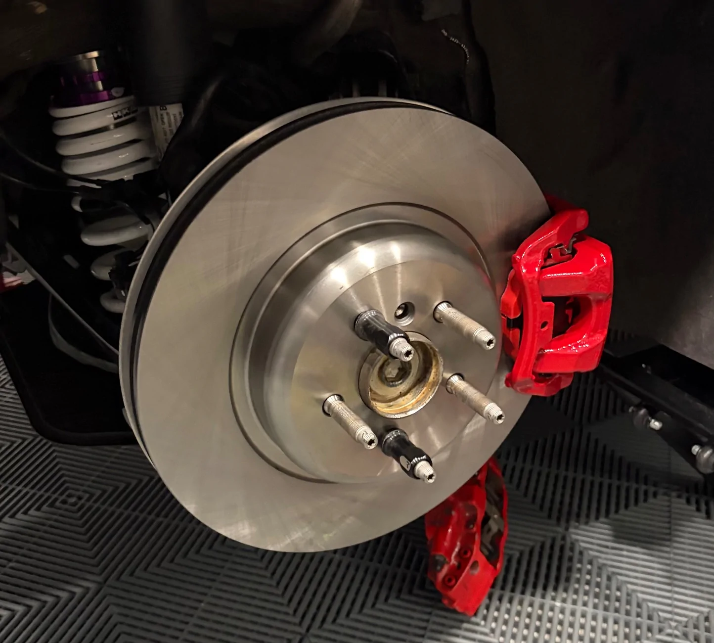

In other news, a 1" spacer works but is WAY too sketchy, so a proper spacer would be needed to use G8x rotors:

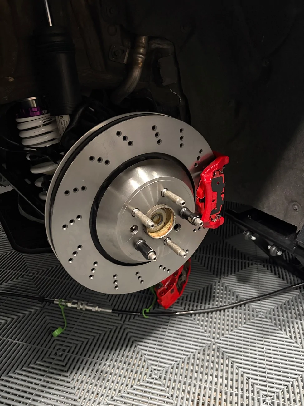

Also the G30 M550i LCI rotors work:
Just waiting on the X3M rotors to arrive. If those fit, ill return the G30 rotors and just use those.

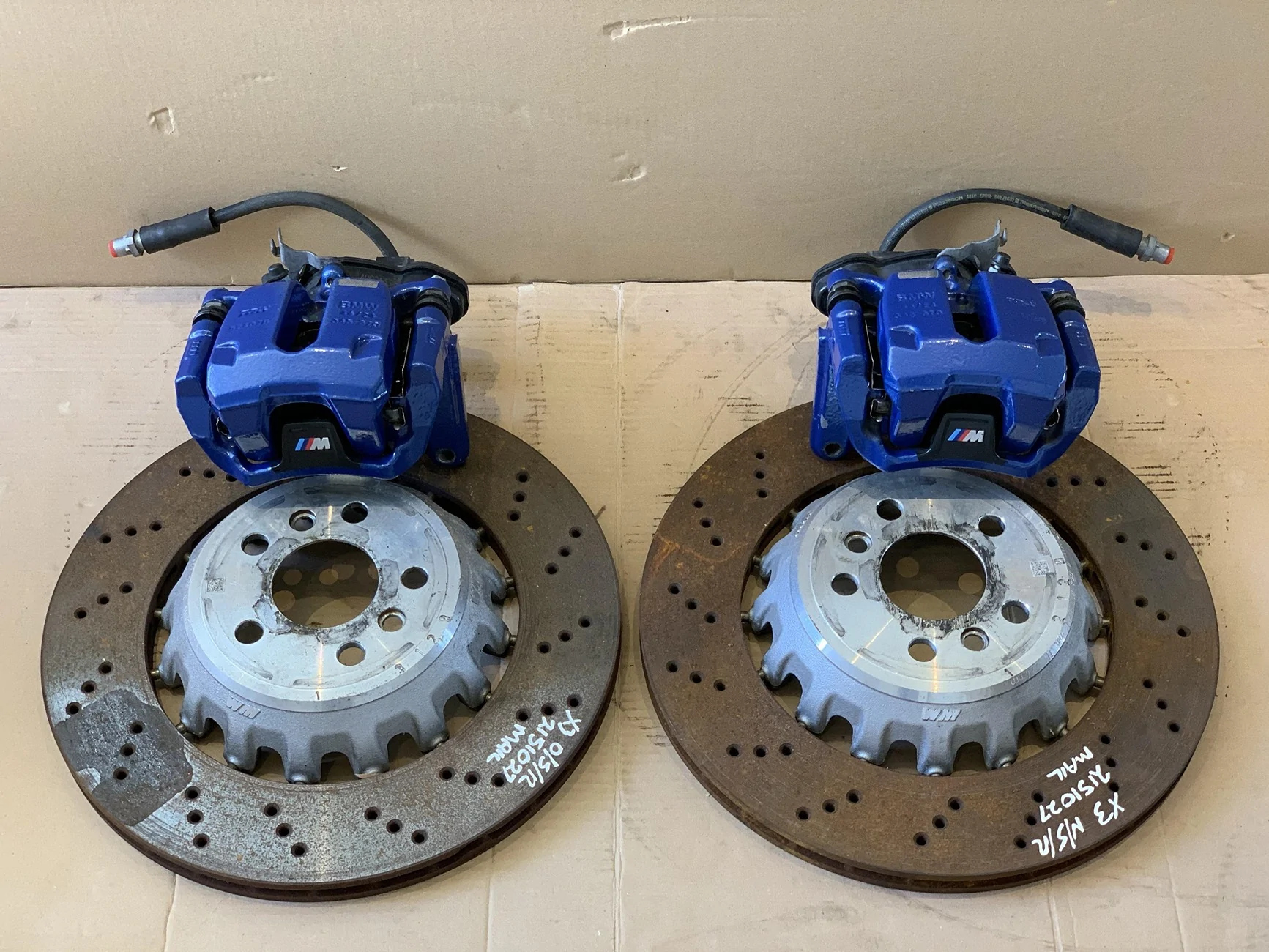

370mm x 24mm M550i LCI rear rotor, G8x Caliper. The rear rotor on the M550 went from 345 to 370 when they did the LCI refresh. The X3M rotors should be here tomorrow.

Im not super sure about the front, only because I wasnt researching it but yes, the G30 LCI uses a 370mm rear, even without the M-Performance pack. The X3M/X4M uses the same rotors dimensionally, but they are the aluminum hat version similar to the G8x.
They are all aluminum hat rotors on BMW. You mean the "floating" M style right, not the pressed aluminum hat.

OK - X3M rotors fit for the rear. In case these look weird, its because theyre cheaper full cast repalcements, instead of the OEM floating aluminum hat ones. It was easier to spend another $200 on cheap ones than $600 for OEM when i wasnt sure if they would fit.
