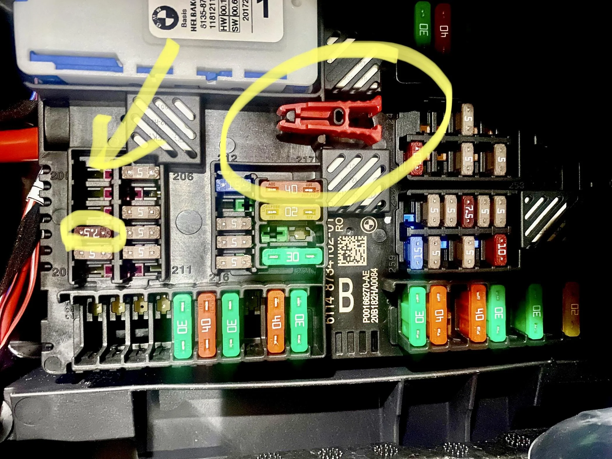

Has anyone gotten any CEL codes or warnings pop up after removing the fuse?

You can turn burbles off. Watch vid.
Apologies, I tried this again today and it works. I think what happened last time was that I was already in Sport and changed it. May have needed to turn Sport off then back on for it to take affect. This time I changed it prior to turning on Sport and it does as you said.

Anyone know why pulling the fuse almost completely turned off my burbles/upshift farts? I’m on a stock exhaust and downpipe on a 2023 3.0 Premium
Even on sport mode?
Did you confirm the valve was open when you pulled the fuse?
I know this is late, but having just searched to find out how to keep the valve open, I did the fuse pull trick. But every other day I get a CEL.
I wondered if its because I have a sports cat in place of the OEM one.
Anyone else have any ideas??
