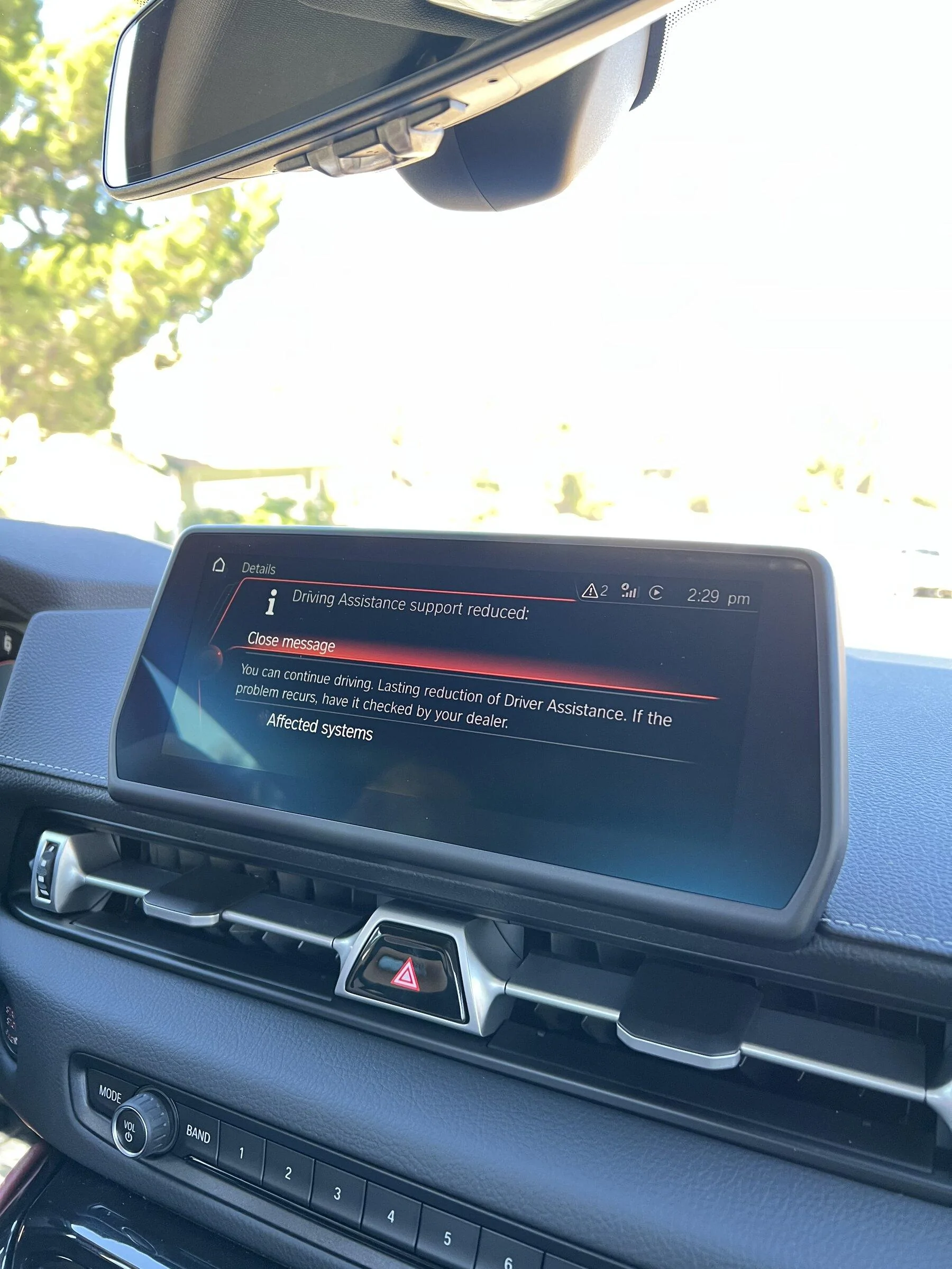

Hi all, today I just took delivery of my 2022 Supra. Upon receipt of the car, I found out that a "Driving Assistance support reduced" error message showed up. Looking into the affected system, it shows that the blind spot monitor has an error. Has anyone encountered similar issues? The message only shows up when the speed is over 30ish mph
The car is getting ppf right now while I am worried about this problem...

did you go into the menu for the safte systems and checked that it's switched on ?
if that's not the problem you should take it back to the dealer, the radars (located in the rear fender) may have been damaged during transport or just be faulty from the get go
PS the blind spot system is not active below a "set speed" according to the manual so this is why you don't see the message below 30mph, which seams to be the speed the system goes active

Thanks for the reply Thomas, the car is currently in the shop getting ppf, I will take a look to see if the blind spot monitoring is turned on when I pick up the car. I doubt that the car is damaged because the paint looks perfect, but the dealer PDI check list didn't mention any of these issues, so most likely its from the transportation.

Does it stay on everytime? They may disconnected battery for whatever reason and then reconnected. Mine did this after I disconnected battery. After a couple of on and off drives it no longer exists. In short, it seems it has to recalibrate itself. Hopefully that's your case and nothing is wrong.
