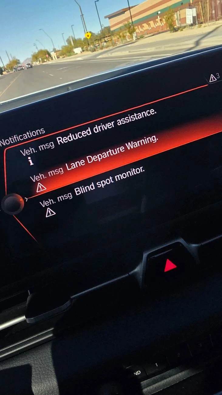

Looking for some help, got some parts installed at a shop and the car came back with these warnings, parts installed were:
Carbon fiber steering wheel
Rexspeed 3rd break light /reverse light
Rear diffuser cover
Now i am my getting,
Does anyone know the location of those sensors?

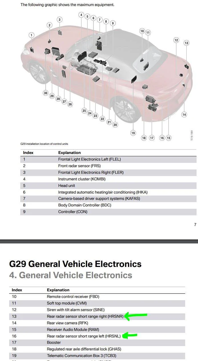

It might be a rear sensor and it is near or actually behind the diffuser and isn't happy about the cover. The front ones are just inside of the tow hook for my Z4 and then of course equally placed on the driver side. The rears are roughly in a similar spot and height. Not the parking distance sensors (the little circles in the bumper) but nearby. I think they're higher than the diffuser actually, but then again the Supra diffuser is pretty high too.
That's the Z4 of course but hopefully that helps. A parts diagram, if you can find one, or a service manual might show you exactly where they are to be sure. They don't have to be completely blocked, if even part of the field of view is covered (the signal is bouncing right back at them), they'll give you messages.

Are you able to pull the codes? It'll tell you exactly which sensor is at fault.
There isn't a cel so i didn't think of scanning but I'm gonna give it a go also.
Thanks for the diagram! The shop also thinks it's the rear diffuser, i am taking it back tomorrow they want to diagnose but after seeing that diagram i am almost also sure it's gonna be the diffuser. Gonna have them remove it and go from there, thanks a lot for the info!

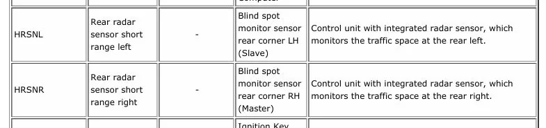

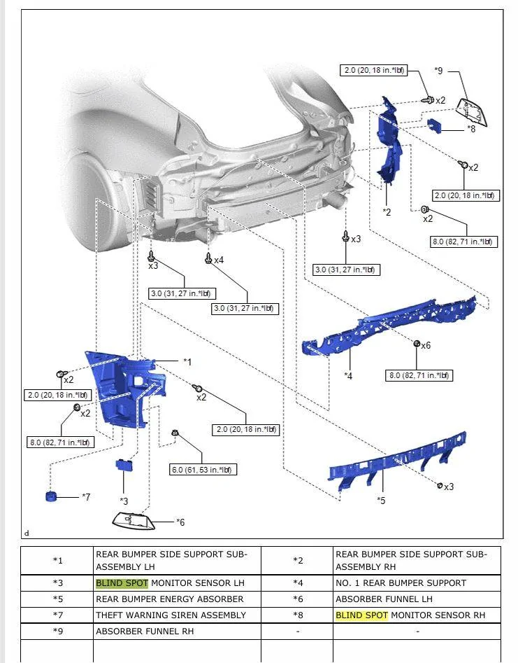

I'll do one better, I have a copy of a Supra manual that I found somewhere around here a while back as well.
Looking at this it seems the diffuser cover I have doesn't reach around to the blind spot sensors since it's only the part that goes around the exhaust, but I will send them this diagram just incase, thanks man
